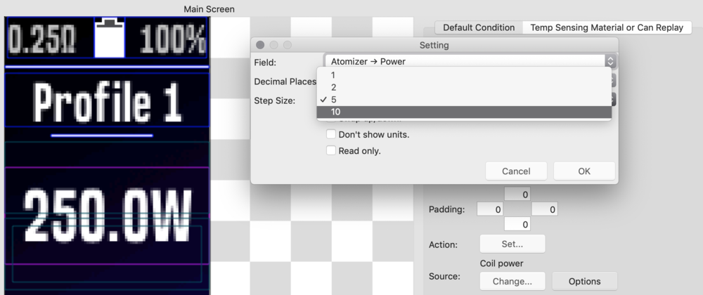

You need to use the 'Theme Designer', find the screen where it is, then the field you want to remove. Delete the 'field', save and upload to your mod.

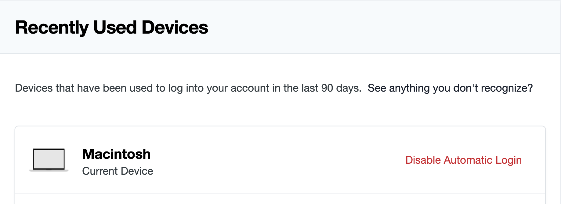

With yesterdays forum update, if you go to Recently used devices, there's now a toggle to keep you logged in. I'm going on more than 12 hours, no logout. Using Chrome browser btw. Tab open while using other tabs, closing tab and coming back later, still not logged out. A happy day is here. Oh yeah, better desktop emoji's to match the mobile. 🙂
