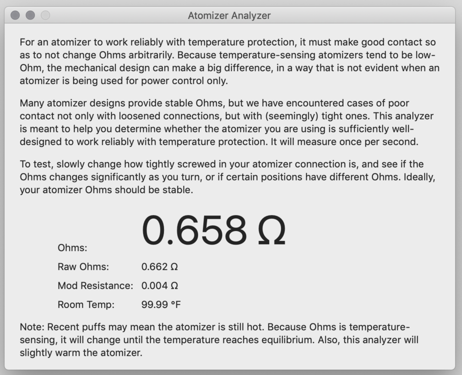

  1. Sounds like you have a bad connection somewhere. If you use atomizer analyzer in escribe it will show that. The ohms should be steady with very little fluctuation. Like maybe 1 or 2 milliohms. Put another atty or coil, ideally simple single coil and see if that’s steady. If it’s not you need to look at your mod build connections (grounding and 510) all 4 of them 👍

  21. I think that means I was correct? All these falling out of TSD issues have you checked your atty connection is stable with Atomizer Analyzer. Using SS clapton when cold I'll usually get ~0.003 fluctuation.
