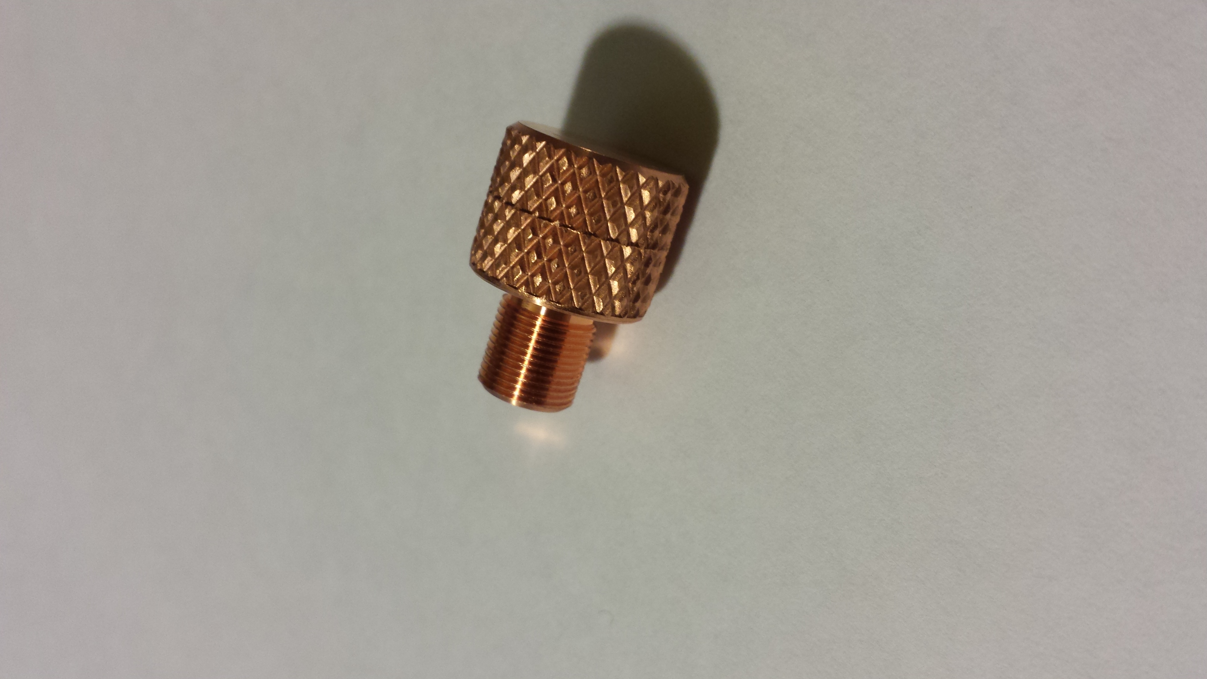

LarryLenz Posted January 15, 2016 Report Share Posted January 15, 2016 Hey Bob, Got my unit today. Did the test and my hCigar VT200 Mod Resistance is: 0.004 It is what I had guessed at, but now I know for sure. It worked perfectly with no fluctuation at all.Thanks again Bob. Oh, your shipper correct my address so it was correct on the shipping label. Go figure Link to comment Share on other sites More sharing options...

Tepid Posted January 25, 2016 Report Share Posted January 25, 2016 Thanks VegaBob, got the device and worked perfectly.Lavabox is at 0.003 and set to 80%(0.0024)Seems to be working much better.Running at 420F at 27W and getting a much smoother vape.Single 32G Nickle at .16ohm spaced coil on a VelocityPreheat 80wPunch 11Time .5s Link to comment Share on other sites More sharing options...
vegabob Posted January 25, 2016 Author Report Share Posted January 25, 2016 I use the full reading now not the 85.% Link to comment Share on other sites More sharing options...
black lace Posted January 26, 2016 Report Share Posted January 26, 2016 (Home mods) Ive been using full number on mine too, they where at zero as default, three came out at 0.004 one at 0.005 so set them at that. Link to comment Share on other sites More sharing options...

MikeyConti Posted April 14, 2016 Report Share Posted April 14, 2016 Just received my tool today! Put it on my Lavabox and Snugged down it reads .004 which I have had the mod set at. By Default the Ohms Lock Range box is set at 25%.Should I leave it there? If I put 0 in it will automatically change to 5.08%I'm running 1.0.42 Version of EScribe btwThank You, this Tool is AWESOME!! Link to comment Share on other sites More sharing options...
dylang919 Posted August 21, 2016 Report Share Posted August 21, 2016 I bought this tool and it only worked on my Lavabox. I have 12 DNA 200's and tested it on 6 of them and it worked in 1. Would there be a reason for this happening? It's not reading the plug at all, just shows a question mark. I don't understand why. Link to comment Share on other sites More sharing options...
VapingBad Posted August 21, 2016 Report Share Posted August 21, 2016 dylang919 said: I bought this tool and it only worked on my Lavabox. I have 12 DNA 200's and tested it on 6 of them and it worked in 1. Would there be a reason for this happening? It's not reading the plug at all, just shows a question mark. I don't understand why. Expand It is probably hitting the high current protection, that would mean a resistance of 0.002 or less or your mode resistance was already set. It is important to zero the mod res before measuring and you could try a hard reboot of the device after zeroing and before testing. Link to comment Share on other sites More sharing options...
mactavish Posted August 21, 2016 Report Share Posted August 21, 2016 dylang919 said: I bought this tool and it only worked on my Lavabox. I have 12 DNA 200's and tested it on 6 of them and it worked in 1. Would there be a reason for this happening? It's not reading the plug at all, just shows a question mark. I don't understand why. Expand I had that issue on a few of my mods until I tightened it even more then I was comfortable with. When it was further down I got a reading. Link to comment Share on other sites More sharing options...
dylang919 Posted August 22, 2016 Report Share Posted August 22, 2016 VapingBad said: It is probably hitting the high current protection, that would mean a resistance of 0.002 or less or your mode resistance was already set. It is important to zero the mod res before measuring and you could try a hard reboot of the device after zeroing and before testing. Expand I just got home from work so I'm going to give what you said a shot. Thank You. I will post back later to follow up. Link to comment Share on other sites More sharing options...
VapingBad Posted August 22, 2016 Report Share Posted August 22, 2016 dylang919 said: I just got home from work so I'm going to give what you said a shot. Thank You. I will post back later to follow up. Expand They may still read ?, then if you also try what mactavish suggested and they still do them 95% sure it just means they have very low (<= 0.002 ohm) res, which is good. If so you should see the res reading going down past 0.003 as you screw the tool in. Link to comment Share on other sites More sharing options...

Spirometry Posted November 15, 2016 Report Share Posted November 15, 2016 SP3 added some extra protections. Reading the ultra low resistances with the copper plug will just display a question mark. Link to comment Share on other sites More sharing options...
