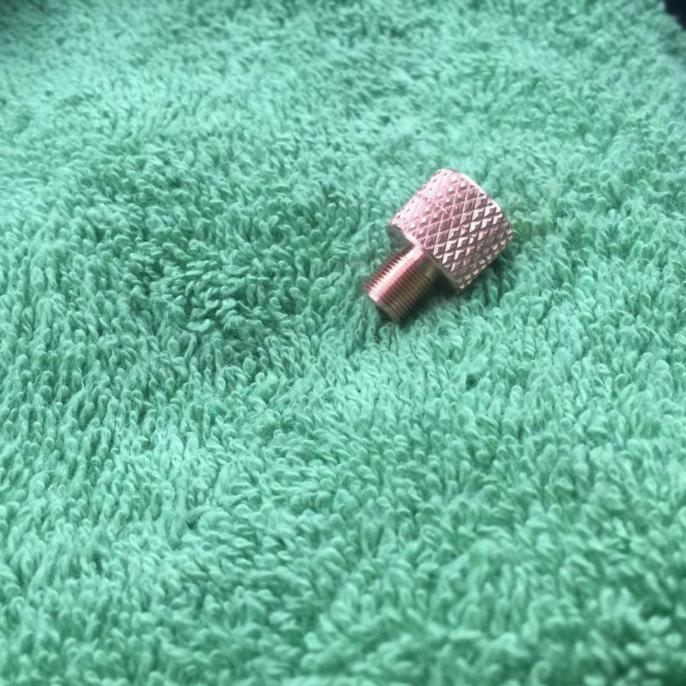

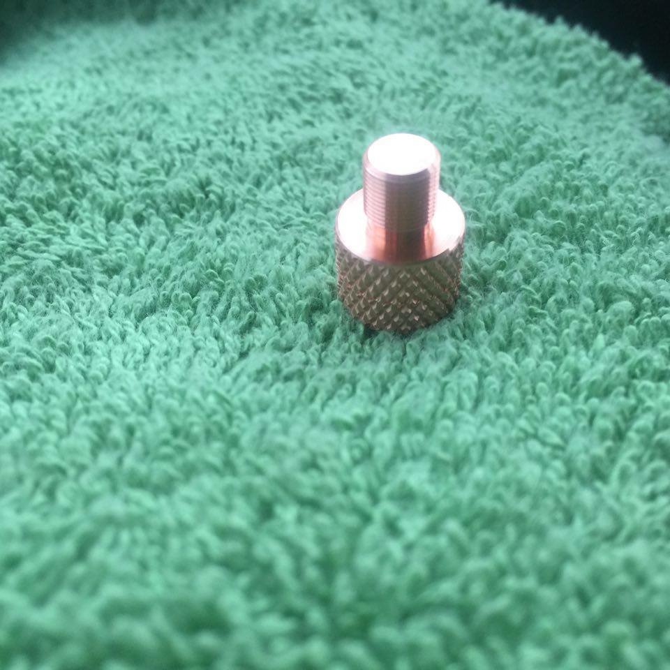

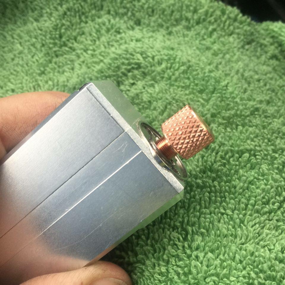

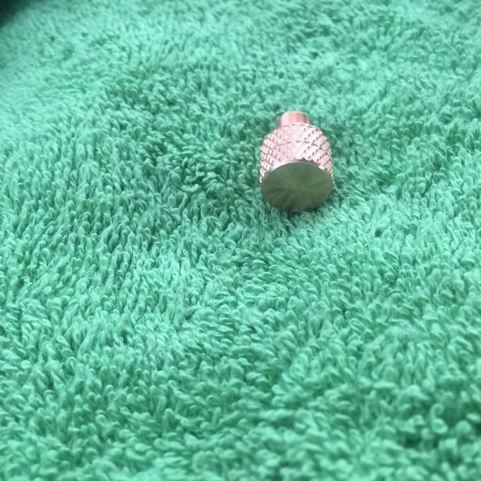

Hello all Nick asked me to get some 510 tools made up to screw in to the 510 on your DNA200 mods. Then in Escribe you run Atomizer Analyzer to get the internal resistance of your mods. Then take the resistance reading and go to the mod tab, enter the reading under mod Resistance and upload settings to device. Now your DNA200 mod will be programmed with its internal resistance. If your interested send me a message on here or Email me at bob.bmb.lewis.03@gmail.com. These tools are in The USA.

I was not too happy when I first ran the atomizer analizer. The threading seemed loose, I got various ohm readings, and as I tightened it down, it showed no ohms, and then untightning I got various readings, I could get as low as a .007 ohm reading between the no ohm reading, and the looser adapter screwed in position. I went back and re-read the case resistance thread, and noted: MAKE SURE TO RESET THE MOD RESISTANCE TO ZERO BEFORE RUNNING TEST!!! This of course means connecting the MOD, it downloads your current settings, then reset the mod resistance to ZERO, upload that back to the mod, then use the copper adapter, and run the atomizer analizer. (THIS SHOULD BE A STICKY FOR OTHERS) After doing this, screwing in the copper adapter worked PERFECTLY, screwed all the way till snug, gave me a reading of .005 on my Vaporshark DNA200, which came with an average setting of .007. I set Escribe to 85% (Evolve recommends using 80-90% of your test ohm reading) of my .005 result, to a final resistance setting of ".00425". HAPPY NOW! Hope this helps others!
