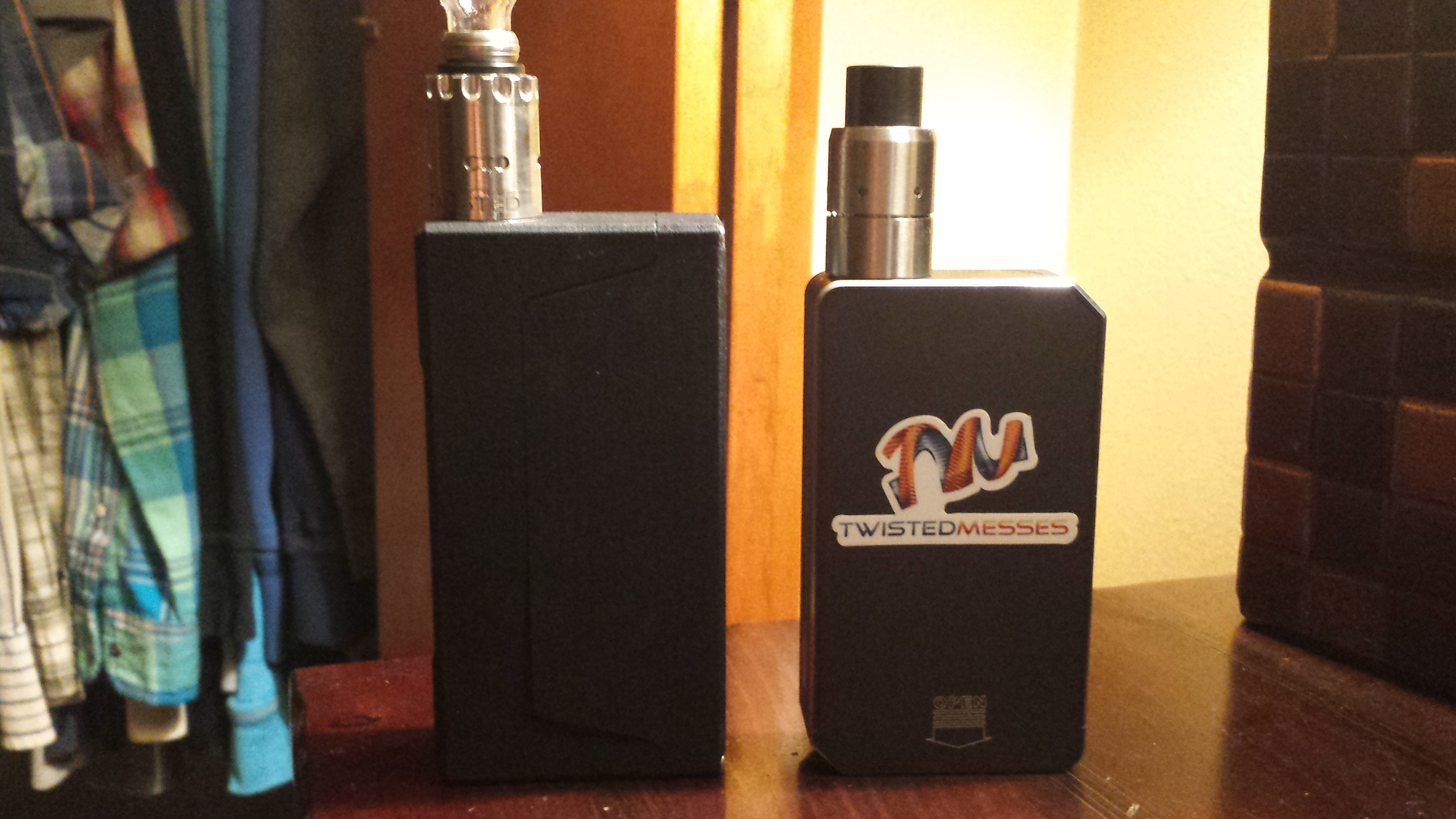

RickAdair Posted August 9, 2015 Report Posted August 9, 2015 They just keep multiplying! At least the wife now has one.

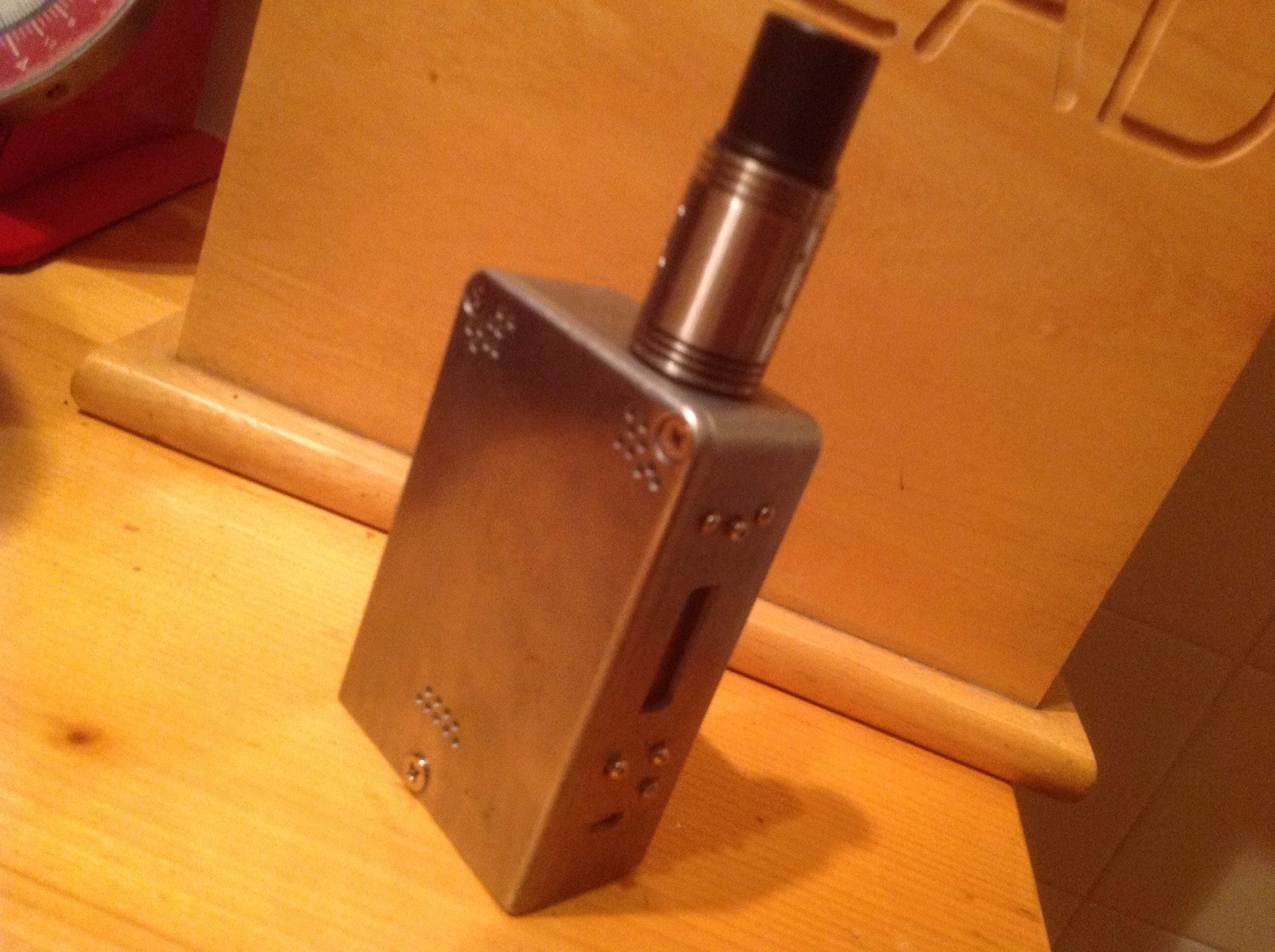

MarkM Posted August 9, 2015 Report Posted August 9, 2015 Here is my first effort, cobbled together with odds and sods I found on my desk. I cut down the box and made a new base/end cover to close it from a bamboo place mat. The board is held in place with some picture hanging pins and I used evod coil tops, trimmed to make spacers. The buttons are positive pins from some used BDC coils. Not pretty but it works.

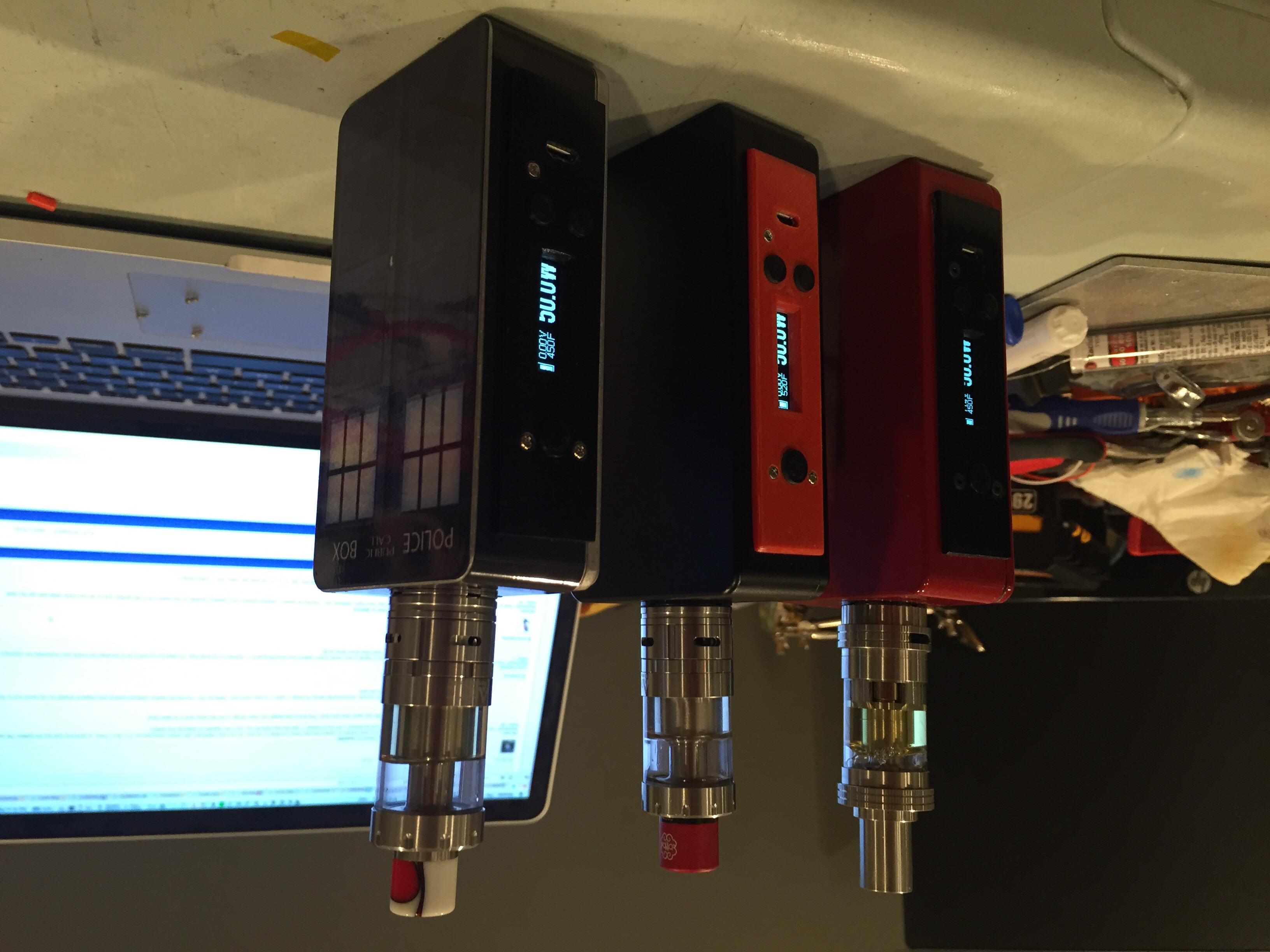

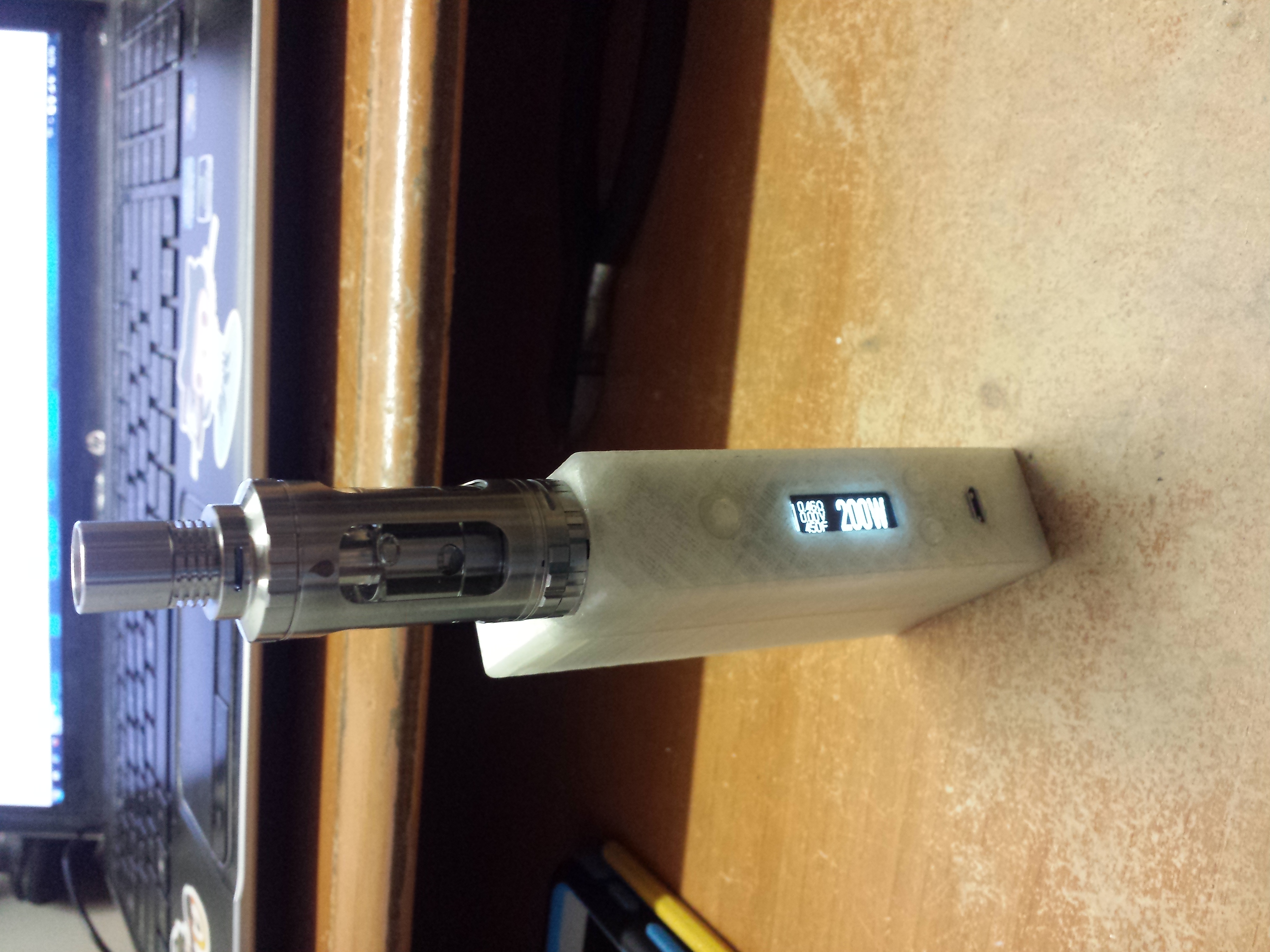

inspector Posted August 11, 2015 Report Posted August 11, 2015 Just finished my build after weeks of waiting and reprinting the case.

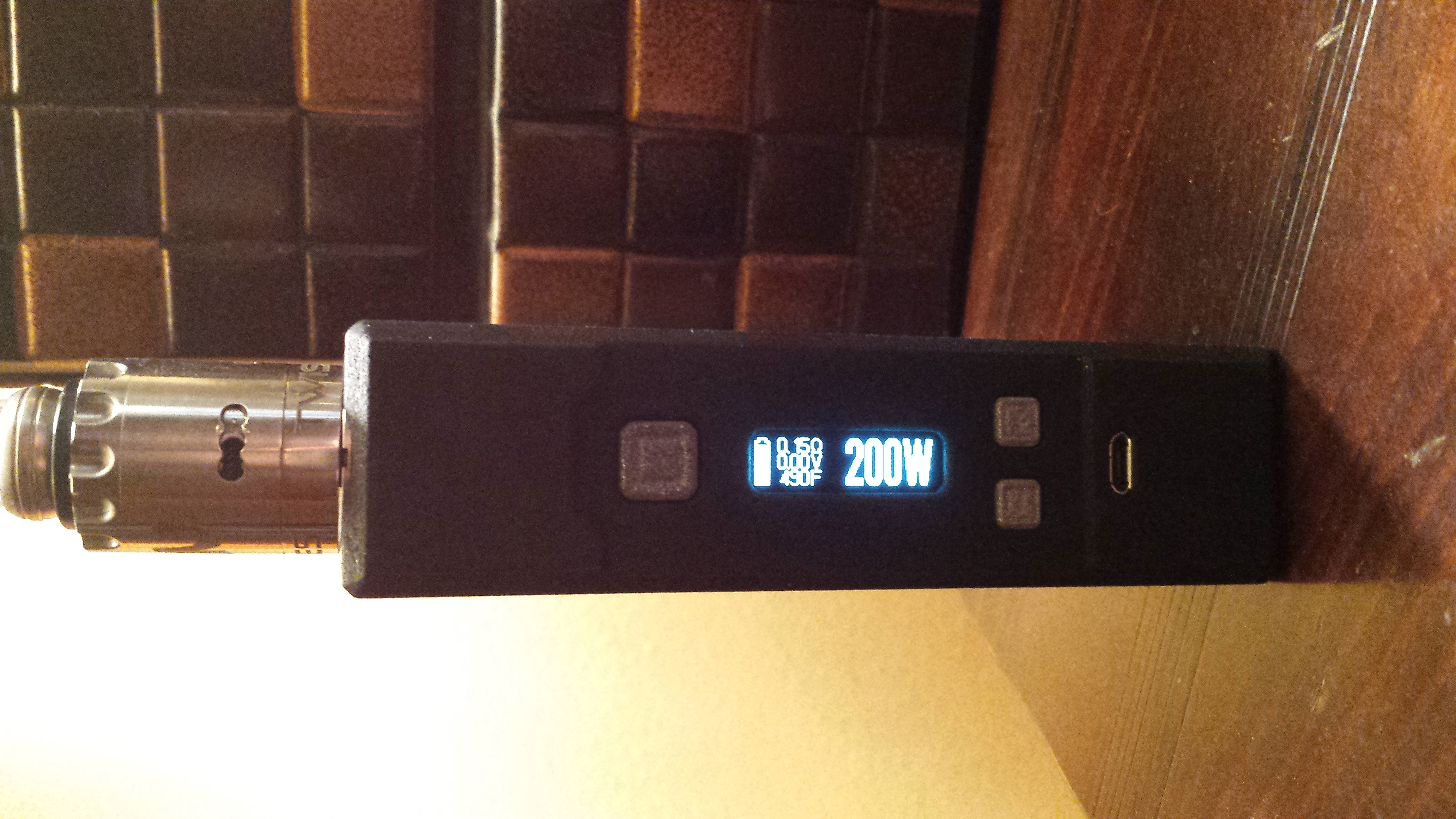

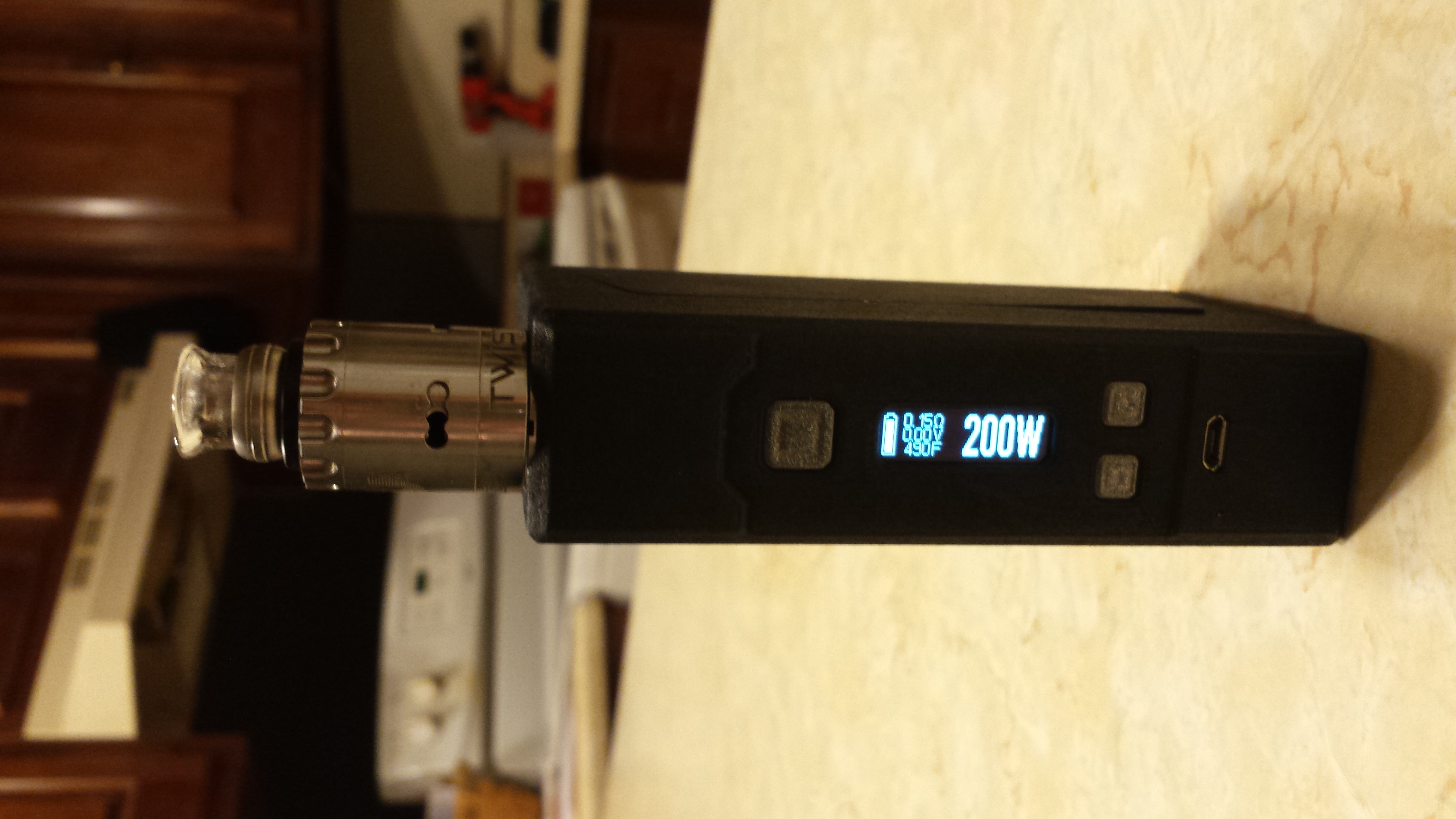

Rico Posted August 11, 2015 Report Posted August 11, 2015 Hey all,I really enjoyed seeing all your nice creations with this uber chip.Here is mine, not very original but I love using it The case is a 1590G.

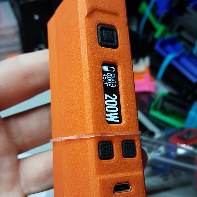

xevape Posted August 12, 2015 Report Posted August 12, 2015 I'm waiting on screws. I'm building 15 of these all different colors for a local shop. https://instagram.com/p/6Q5vAKAWHa/

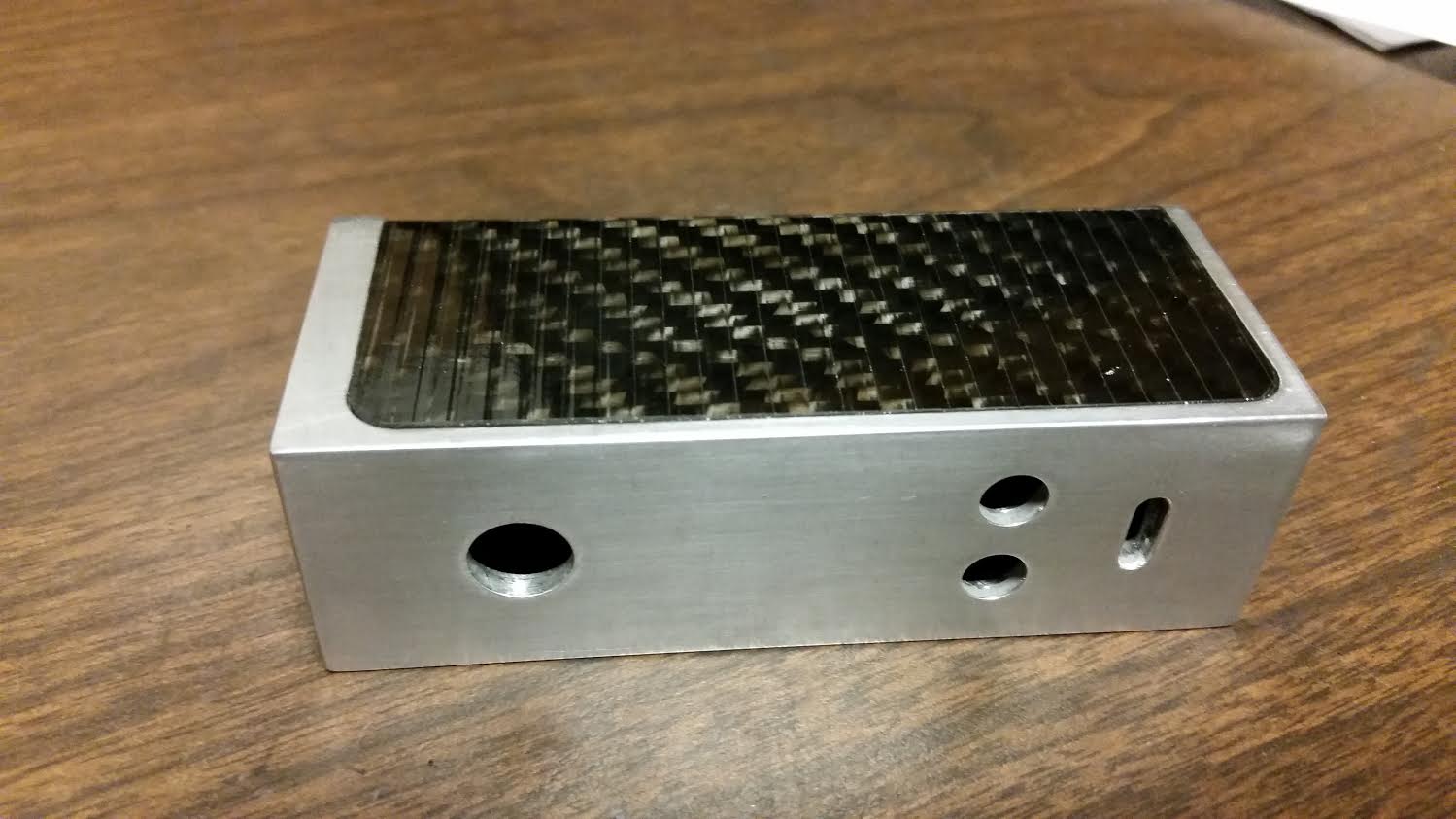

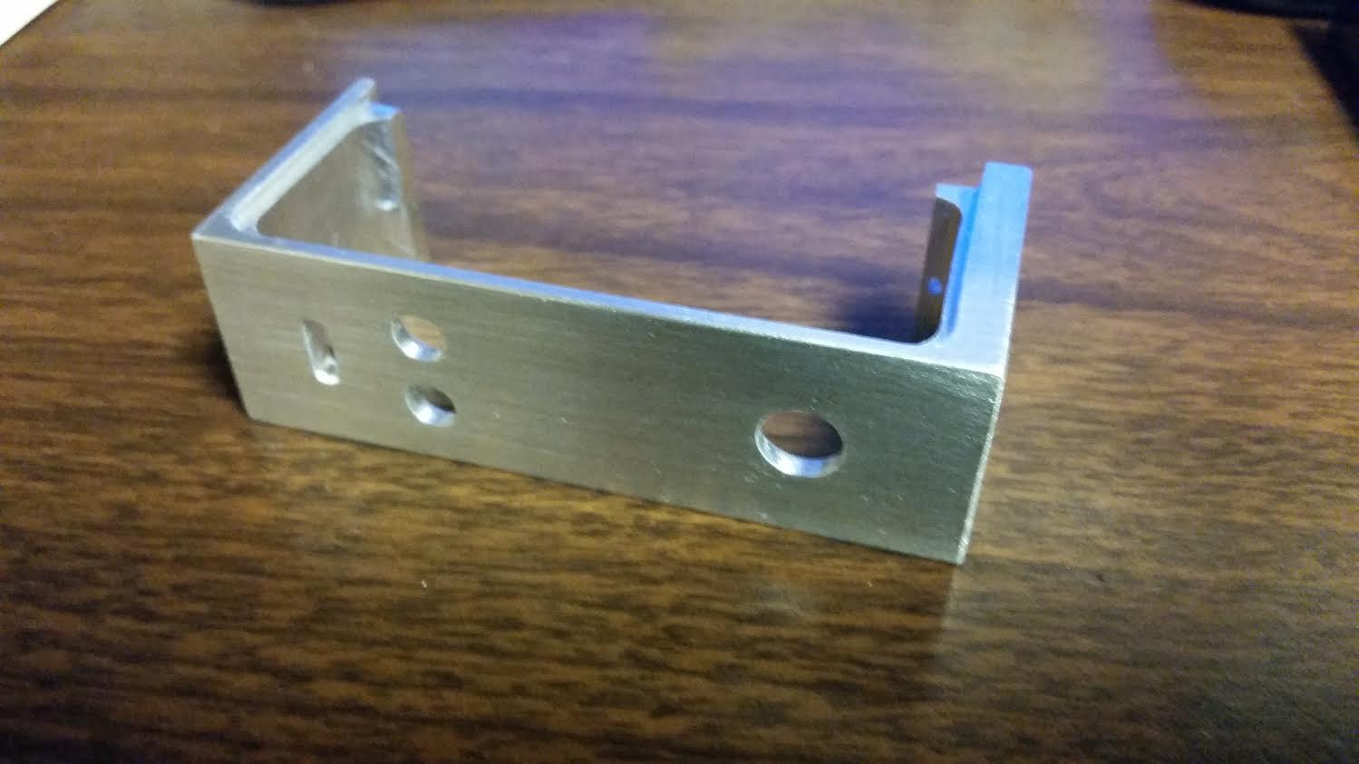

jevon Posted August 13, 2015 Report Posted August 13, 2015 Here's my "not quite done, but can't help and post" dna200. I still need to mill out the window for the display and turn some buttons on the lathe. Made of aluminum and real carbon fiber. Once done I'm getting the aluminum hard coat anodized.Jevon
alee132 Posted August 13, 2015 Report Posted August 13, 2015 xevape said:I'm waiting on screws. I'm building 15 of these all different colors for a local shop. https://instagram.com/p/6Q5vAKAWHa/Hope they are having you coat them or customers are going to be hating 3D printing once the dye starts wearing off them. That orange and black button one looks great!
alee132 Posted August 13, 2015 Report Posted August 13, 2015 jevon said:Here's my "not quite done, but can't help and post" dna200. I still need to mill out the window for the display and turn some buttons on the lathe. Made of aluminum and real carbon fiber. Once done I'm getting the aluminum hard coat anodized.Jevon All I can say is wow! What a great job! This is my dream mod to make here. I wish I had the tools to make such quality mods. Unfortunately unless I pay ridiculous amounts of money to get them made for me, which isn't a option for single units as the price wouldn't make sense. Wish I had a friend in phoenix, AZ that had a cnc machine, etc. I did look into making my own cnc machine but even then the costs are too high to make sense for my personal modding. Love the carbon fiber cover! I cannot wait to see finished project! Please post more pics as you go along and when finished! Loving it so far! Very professional and if you wanted to you could charge more than $200 as it's way better than a vapor shark or hana or any of those mass produced boxes imo. This impressed me the most thus far and I hope it comes out great. I only make my own mods and I don't buy premade one's unless it's so nice I cannot help but buy it and even then only once did I buy a $200 mod.

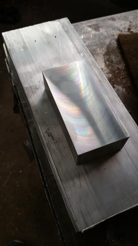

jevon Posted August 13, 2015 Report Posted August 13, 2015 All I can say is wow! What a great job! This is my dream mod to make here. I wish I had the tools to make such quality mods. Unfortunately unless I pay ridiculous amounts of money to get them made for me, which isn't a option for single units as the price wouldn't make sense. Wish I had a friend in phoenix, AZ that had a cnc machine...Hey thanks, I appreciate it. I'll definitely post pictures when I'm finished. I wish I had a CNC machine too! This was all done on a well worn manual Bridgeport mill. Started as a 2"x 4" block and took me 6 hours to mill.

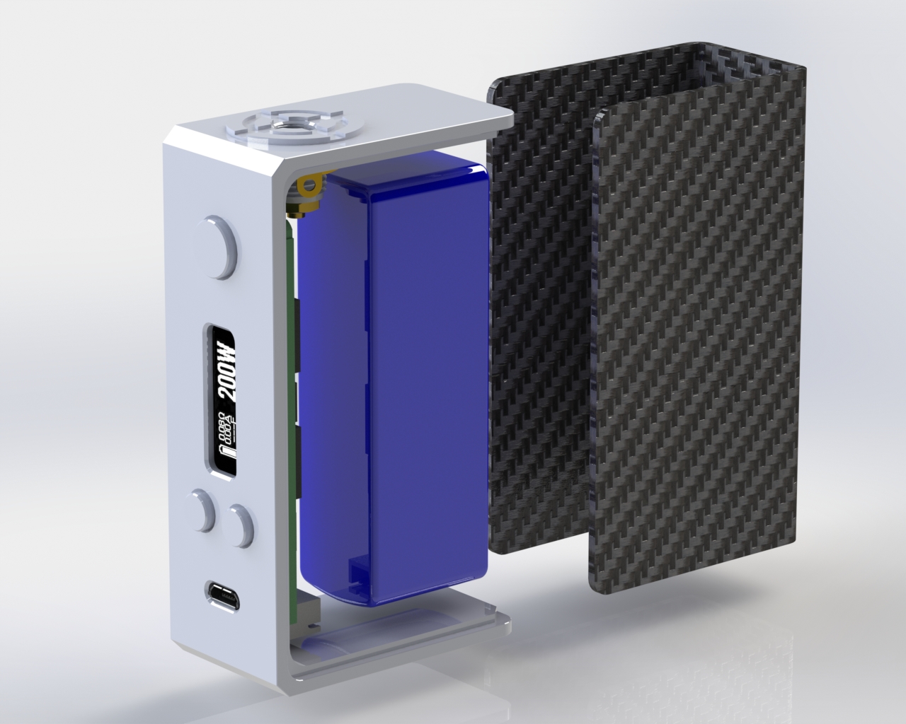

FireBALL Posted August 13, 2015 Report Posted August 13, 2015 Here is my final version of inspired case (rendered image). Having it printed by shapeways
