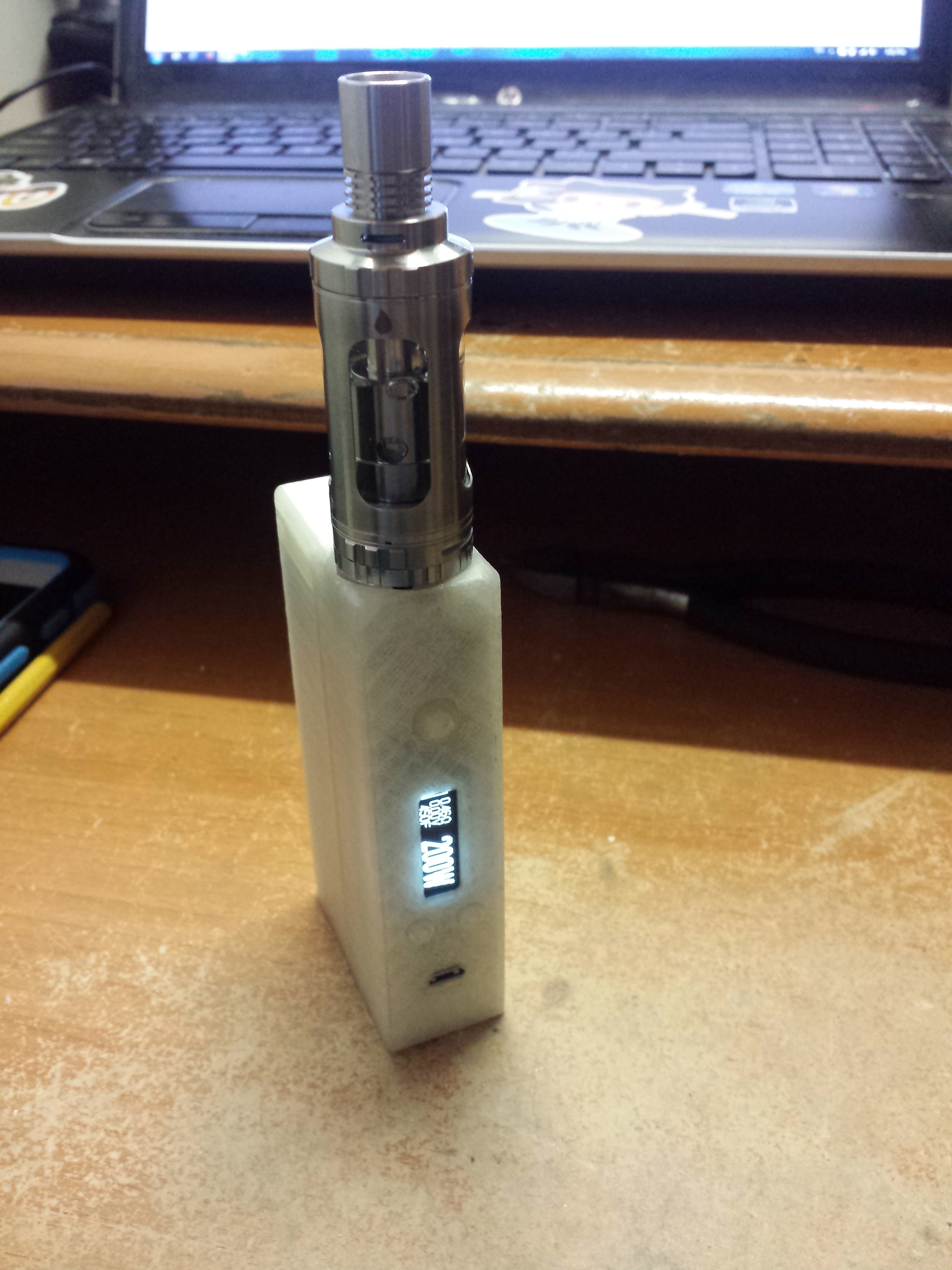

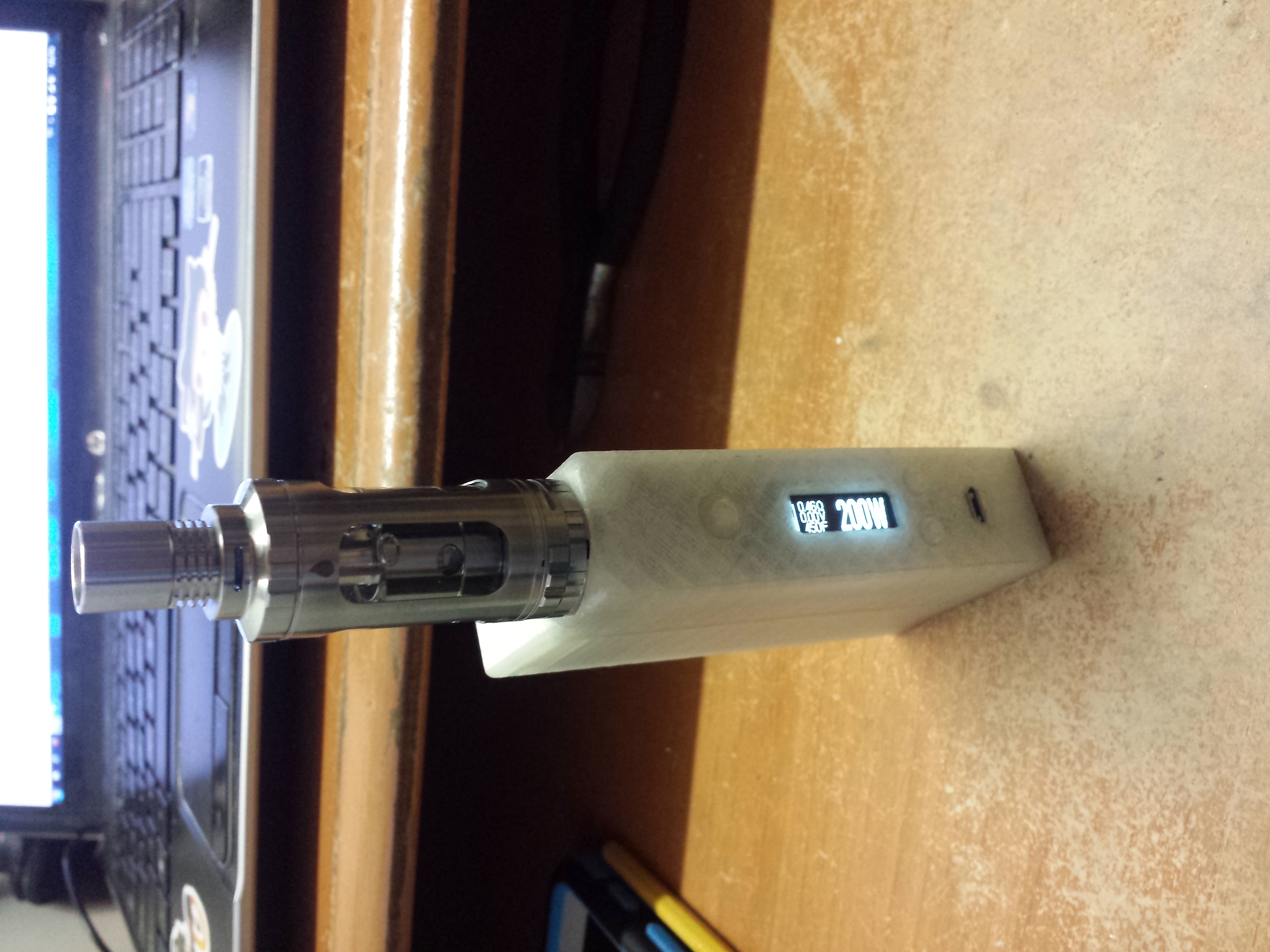

  11. Just finished my build after weeks of waiting and reprinting the case.
  12. I would also like to know how i can edit the case, im new to 3d printing and i couldn't get the case to save as a STL file in inventor 2016. End up making my own model with the measurements.
