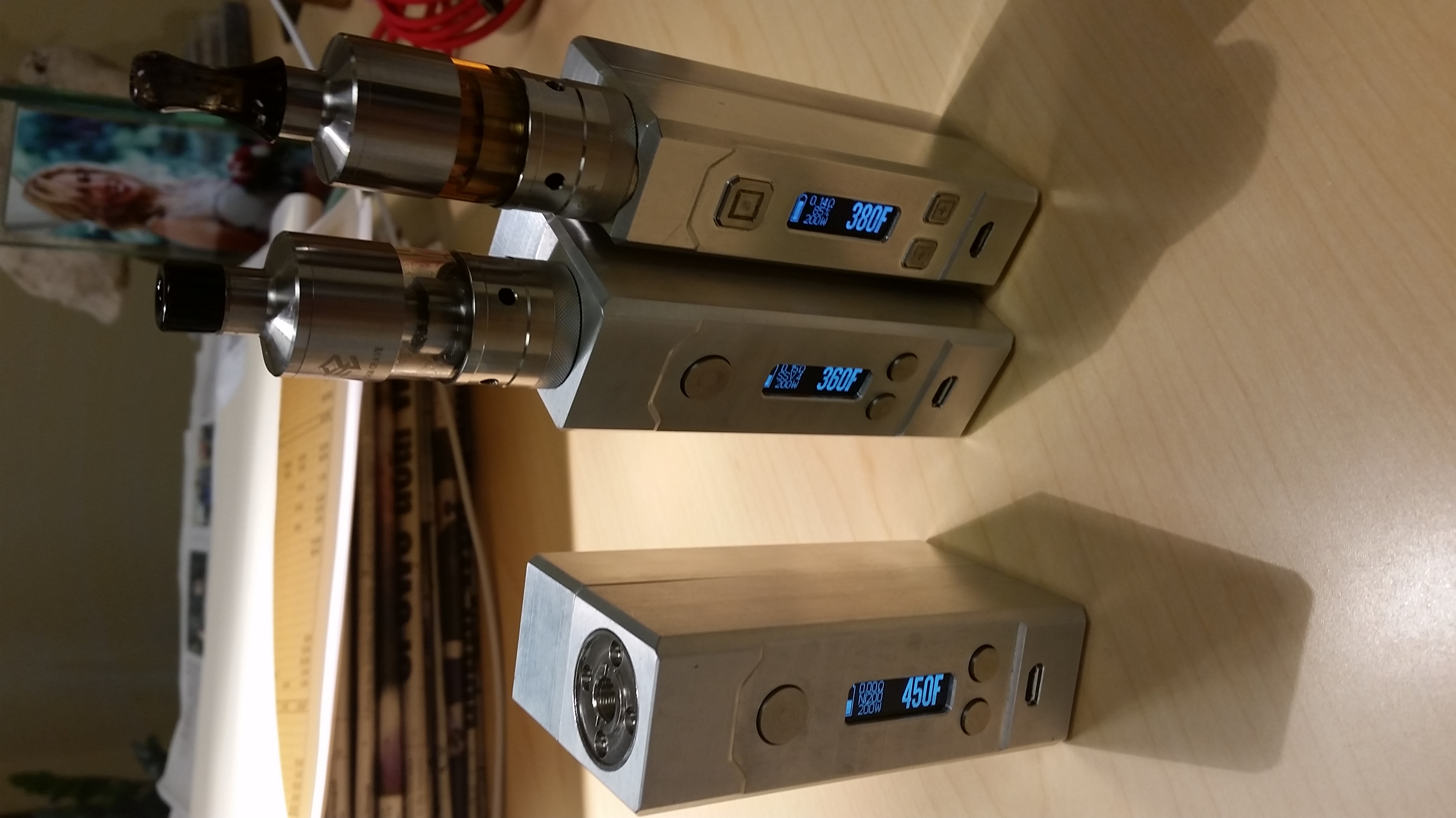

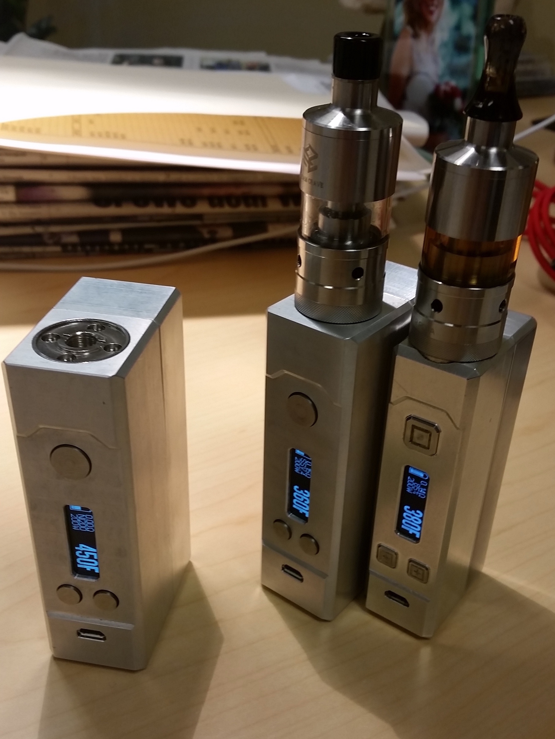

blueridgedog Posted March 30, 2016 Report Posted March 30, 2016 Two 1.3ah mods based on the reference mod and a reference mod.
black lace Posted March 30, 2016 Report Posted March 30, 2016 Which fire button do you like best, round or square,?? Reason is because i imagin the square one to catch on the sides and drag??
mikepetro Posted March 30, 2016 Report Posted March 30, 2016 black lace said:Which fire button do you like best, round or square,?? Reason is because i imagin the square one to catch on the sides and drag??I honestly have never found the square buttons to be any issue at all. Evolv did a great job on those square buttons, they have a bevel on all sides that prevents the edges from catching on anything. The round buttons were decided on, in the above design, simply because the machining was less expensive.
blueridgedog Posted March 30, 2016 Report Posted March 30, 2016 Mike and I just put these together last night, so I am still new to them. From an aesthetics standpoint, I like the round. The square ones are beveled, so there is no catching.
black lace Posted March 30, 2016 Report Posted March 30, 2016 Very nice by the way.... I think the problem ive got with mine, the sides of the box, a zinc alloy, not billet aluminium, its very thin so theres nothing to support the pushrod button travelling back and fourth, if i do anouther build in one of these thin sided ones i'll have to add a bit of plate to create a bit of a cylinder barrel efect..
blueridgedog Posted March 31, 2016 Report Posted March 31, 2016 black lace said:Very nice by the way.... I think the problem ive got with mine, the sides of the box, a zinc alloy, not billet aluminium, its very thin so theres nothing to support the pushrod button travelling back and fourth, if i do anouther build in one of these thin sided ones i'll have to add a bit of plate to create a bit of a cylinder barrel efect..I did some printed enclosures and found that 3mm was about as low as I could go and still guide the button.
black lace Posted March 31, 2016 Report Posted March 31, 2016 Ok thanks for that i'll keep it in mind, glad someone else had noticed, (all these little issues we mod builders have to adapt and overcome) we need to form a union and put the price up, lol, as a general tip to anyone.. I turned some brass buttons out of brass rod, (off an old cistern ballvalve) using an electric drill and a file, face of firing button was about 9mm back end was about 11/12mm with groves either side, then the mounting bolts for the board doubled up as guide rails..

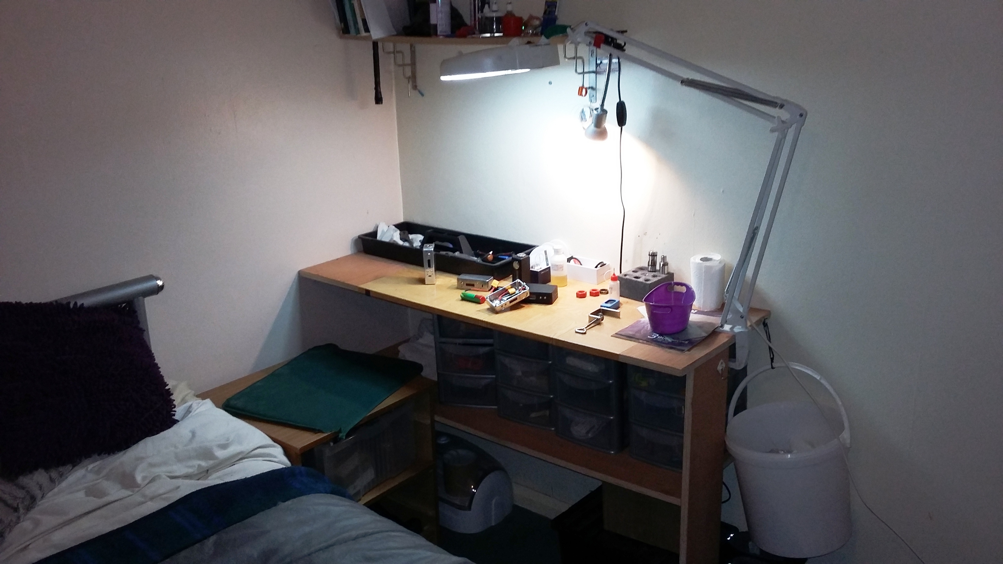

black lace Posted April 8, 2016 Report Posted April 8, 2016 If its any insparation, the workbench in my room is 18inch from front to back and three foot long and i sit at it on bedside draws, it aint a race, moor of a marathon, once the first ones built your geared up..
MikeyConti Posted April 8, 2016 Report Posted April 8, 2016 black lace said:If its any insparation, the workbench in my room is 18inch from front to back and three foot long and i sit at it on bedside draws, it aint a race, moor of a marathon, once the first ones built your geared up.. Perfect setup for the room! Wish I had some free space to setup another desk.. Already have a few lolYeah, I'm sure after the first one, it just keeps going..
black lace Posted April 9, 2016 Report Posted April 9, 2016 I was determined i wasnt going to spend the price of a mod on tools, so a soldering iron from fleabay for less tan a tenner a pack of cheap and nasty little files for less than a fiver and a few quality drill bits and centre punch for a second hand battery drill, all the tools have been used on other jobs, like new charger boards on tablets, done three of thoes Built twelve mods in as many months. And no end of repairs and conversions.

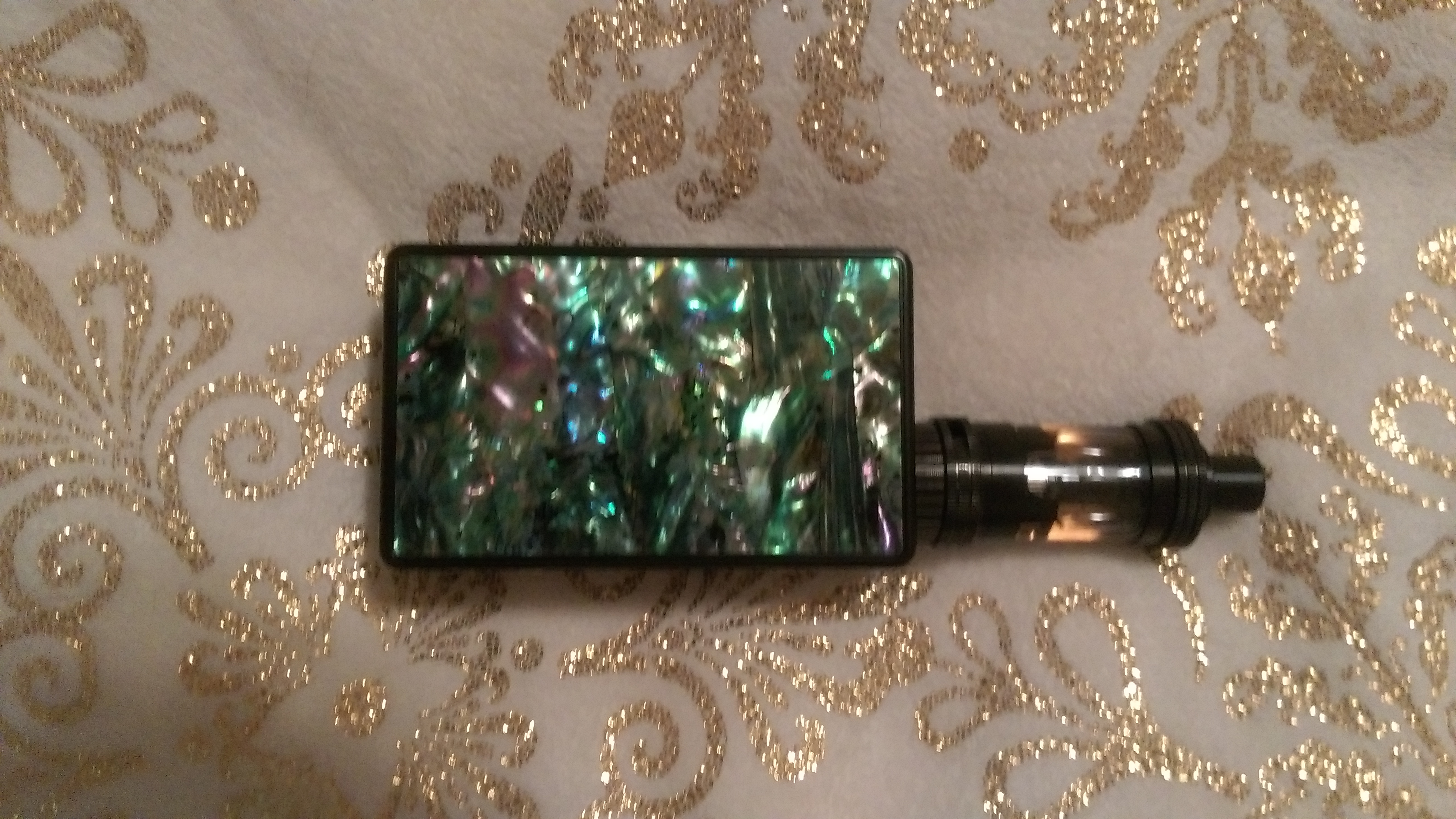

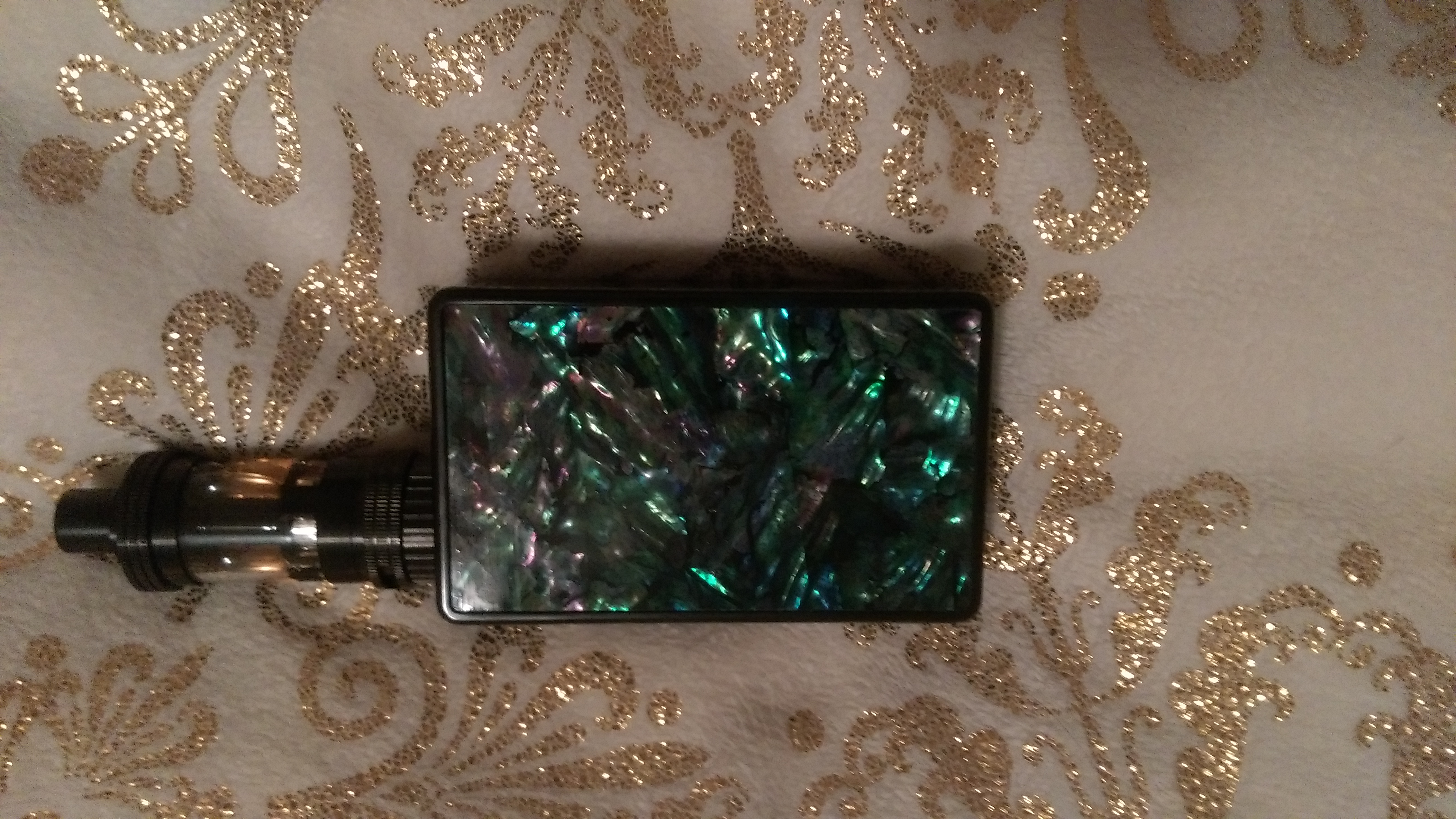

black lace Posted April 11, 2016 Report Posted April 11, 2016 That is very nice i like abalone, is it gel coated over so its smooth?

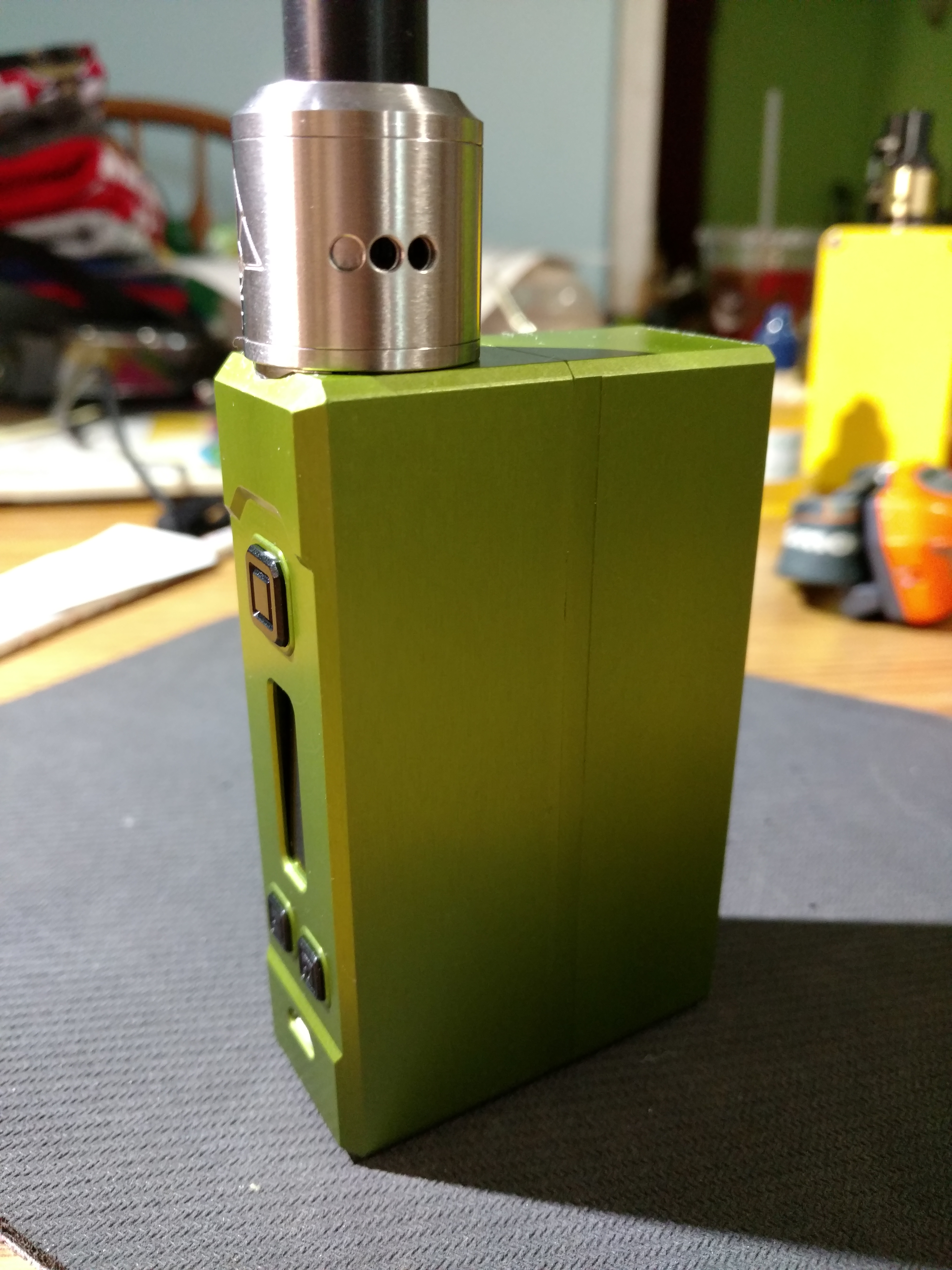

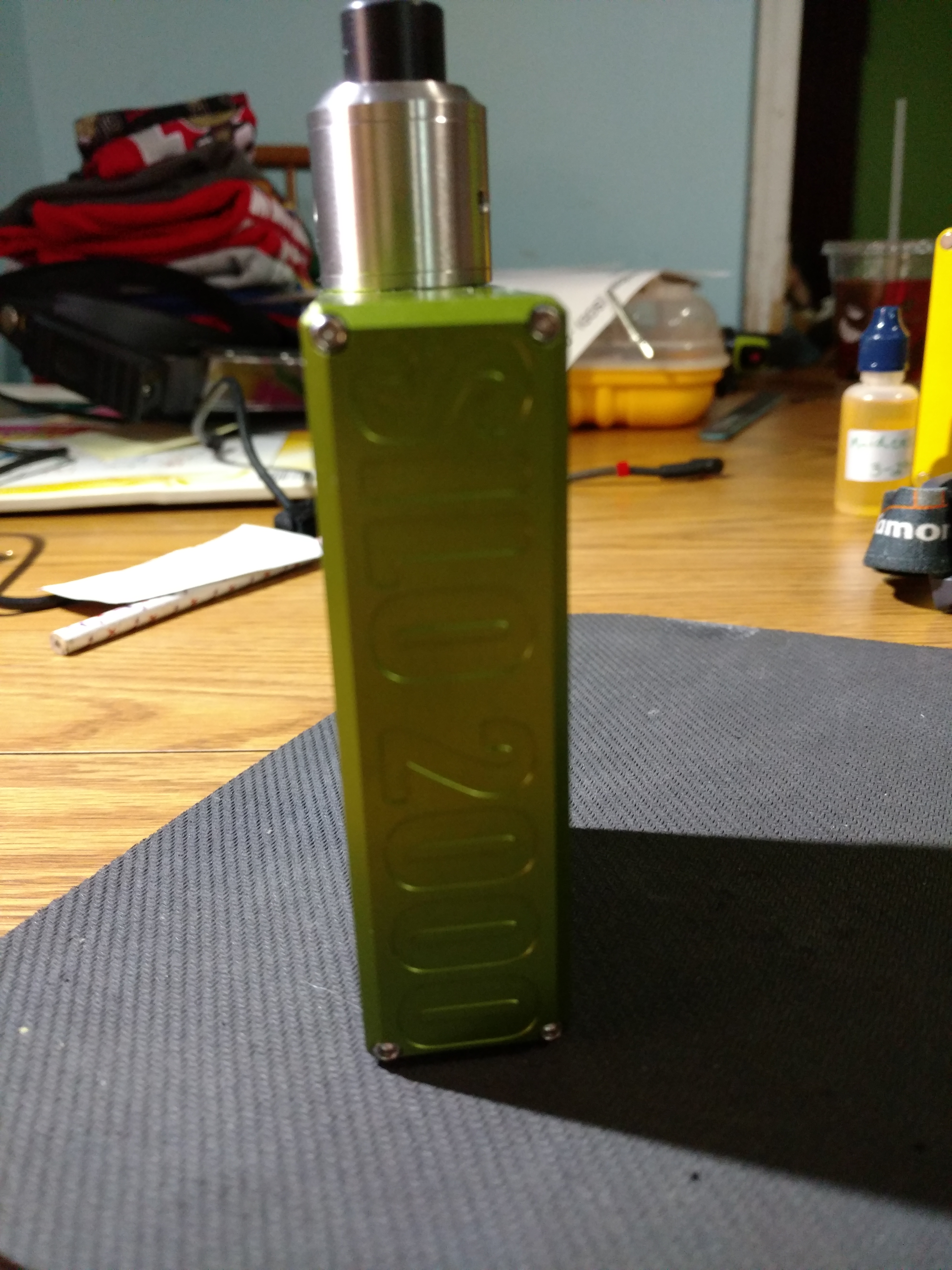

antyac2108 Posted April 11, 2016 Report Posted April 11, 2016 Just finished up this SILO-2000 from Modcrate over the weekend. Maxamps 2000mah 3s 22.2Wh battery, Modcrate 510. This thing is a beast!!!

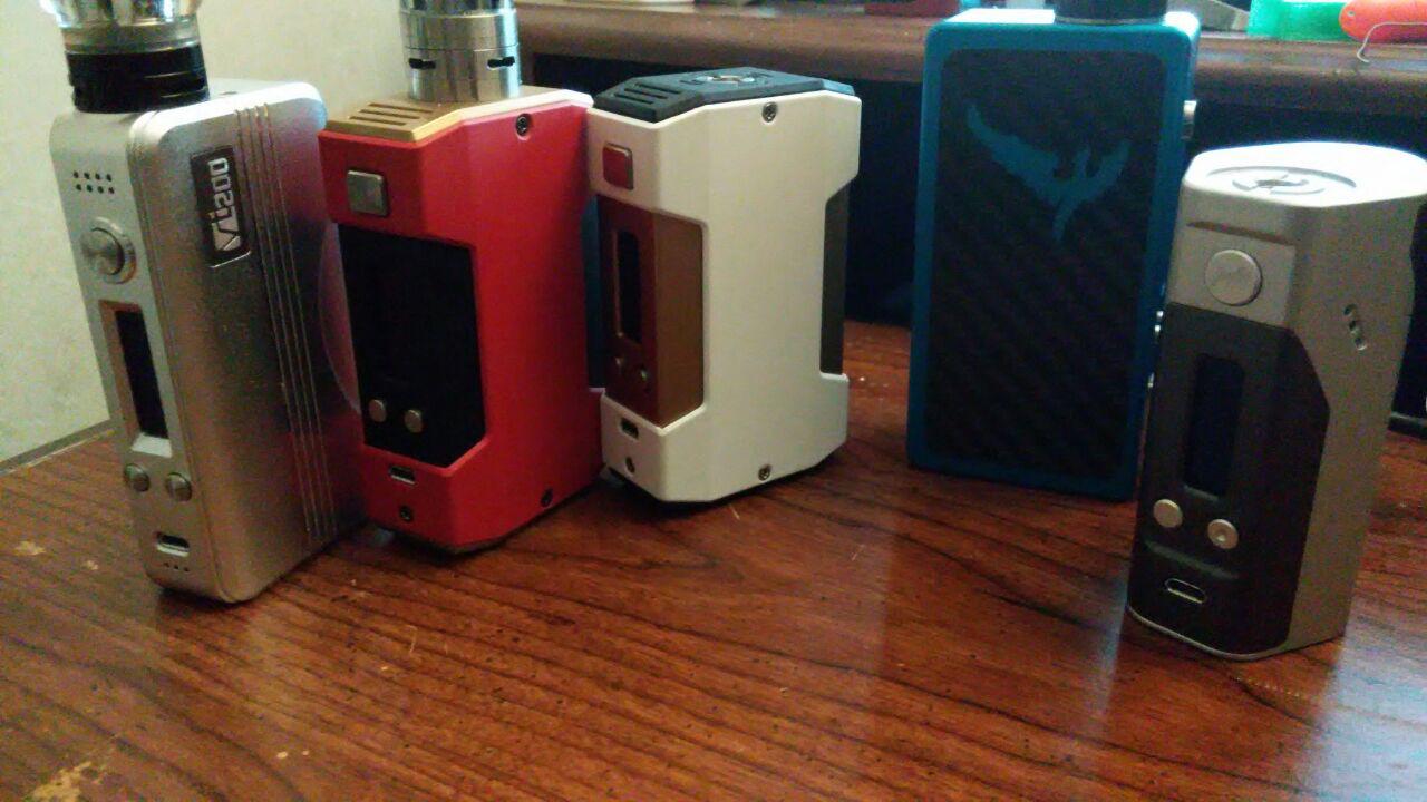

Zerethon Posted April 14, 2016 Report Posted April 14, 2016 VT200, 2 Panzer's with custom plateswapping, Phoenix Immortal & Reuleaux. My angry angry babies.

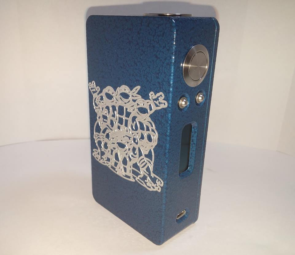

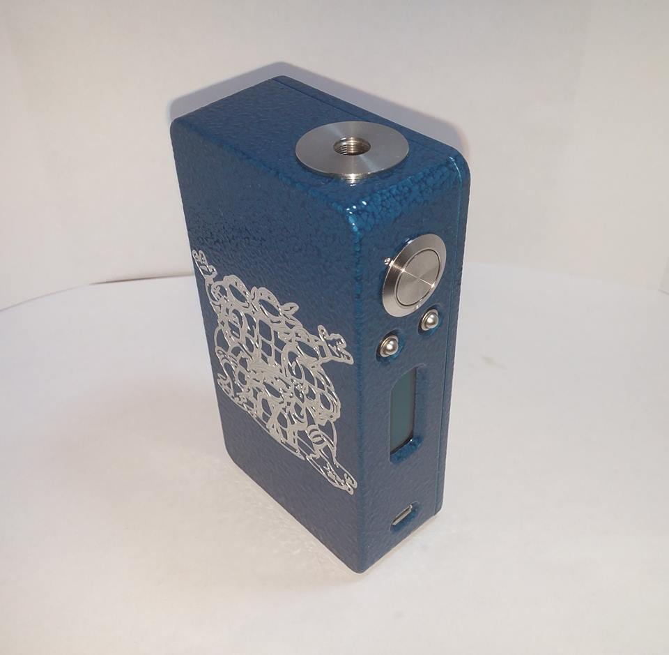

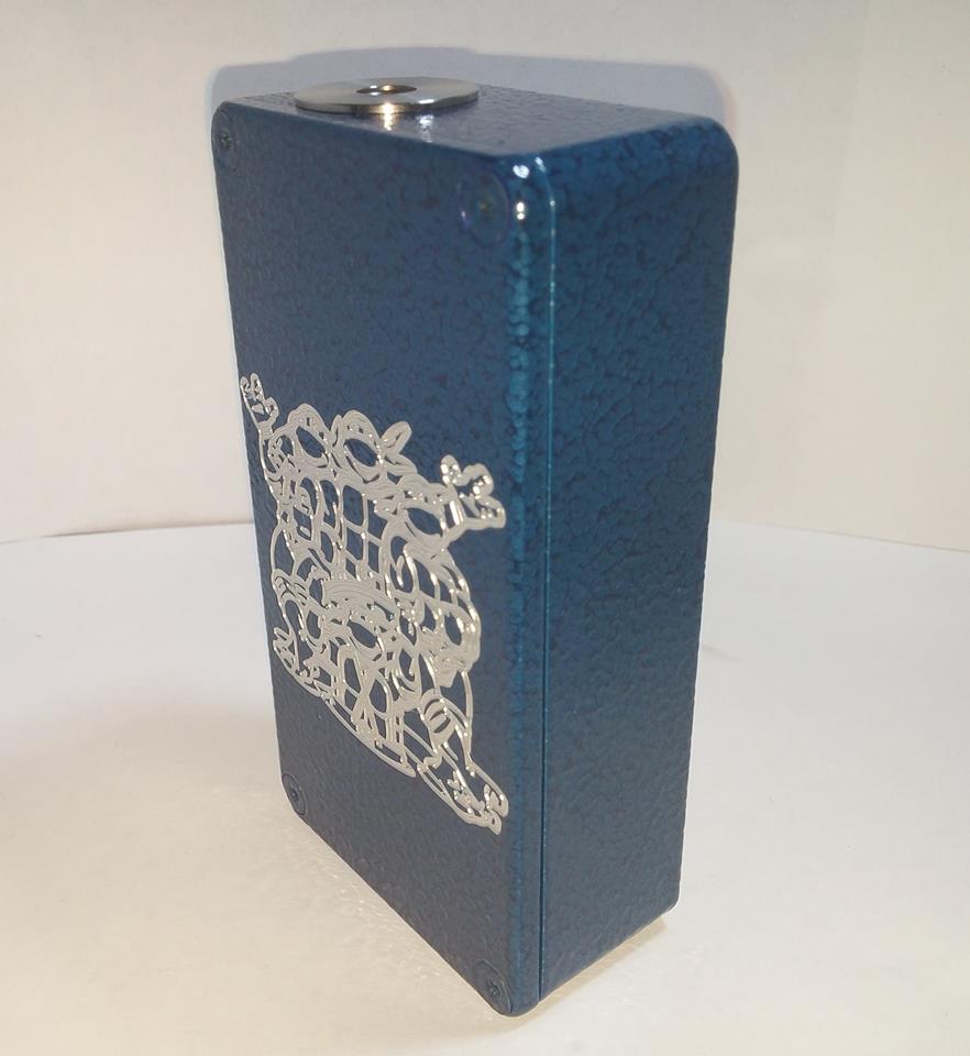

vaporlips Posted April 16, 2016 Report Posted April 16, 2016 A recent box we made. The engraving is on both sides of the box. DNA200!
