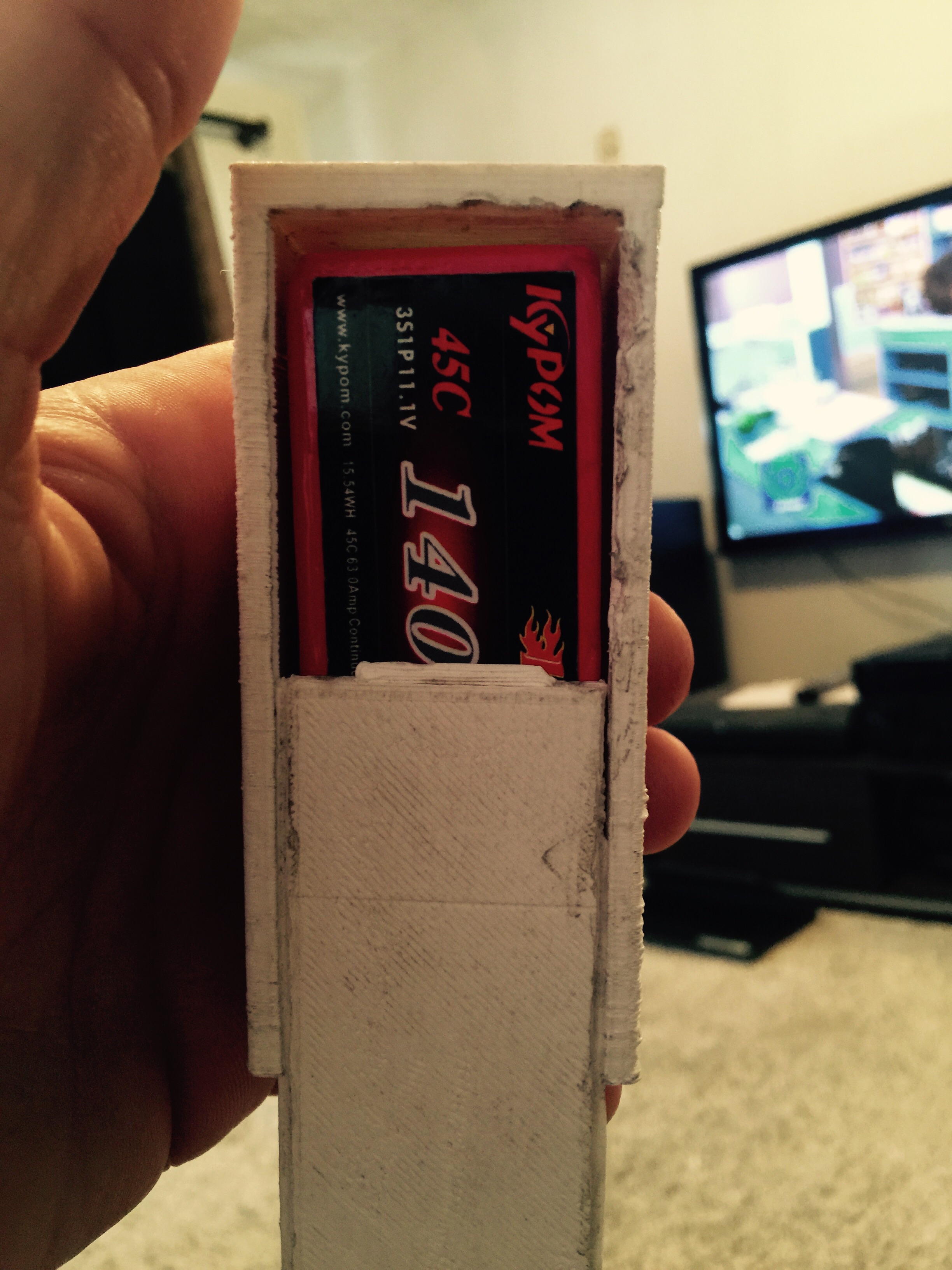

adski Posted July 12, 2015 Report Posted July 12, 2015 alee132 said:[QUOTE=adski]Try that again..http://imgur.com/09QXypiI saw that on shapeways and thingiverse. That blueridge guy made it. What size lipo goes in it?[/QUOTE]
adski Posted July 12, 2015 Report Posted July 12, 2015 It's a 1400mah. Just about get a full day out of it.

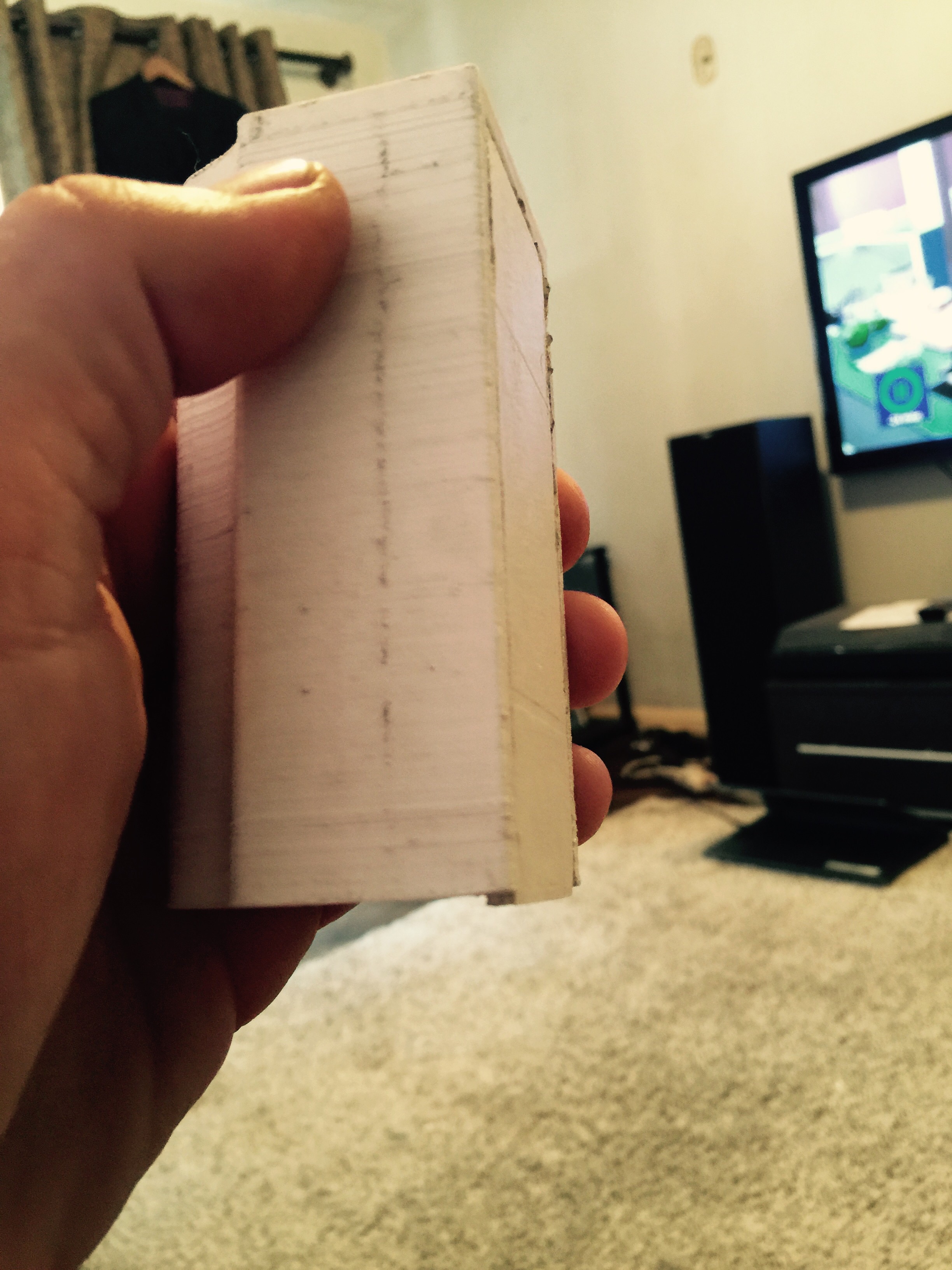

adski Posted July 12, 2015 Report Posted July 12, 2015 blueridgedog said:[QUOTE=adski]Try that again..http://imgur.com/09QXypiThis is a test enclosure I posted. I have since lowered the window to make management of the ribbon easier, but you still have to sand the buttons due to variations in printing...they need to fit tight so there is no deflection.Can you tell me how the snap enclosure on the back worked?[/QUOTE] Thanks for the design. The back panel did not come out too good but I put that down to the cheapo printer. It was too wide by 5mm and a hair too long. I just dremelled it down a bit and it wedges in there. The screen did need lowering as I had to bend it back on itself twice to line it up without encroaching on the fire button.

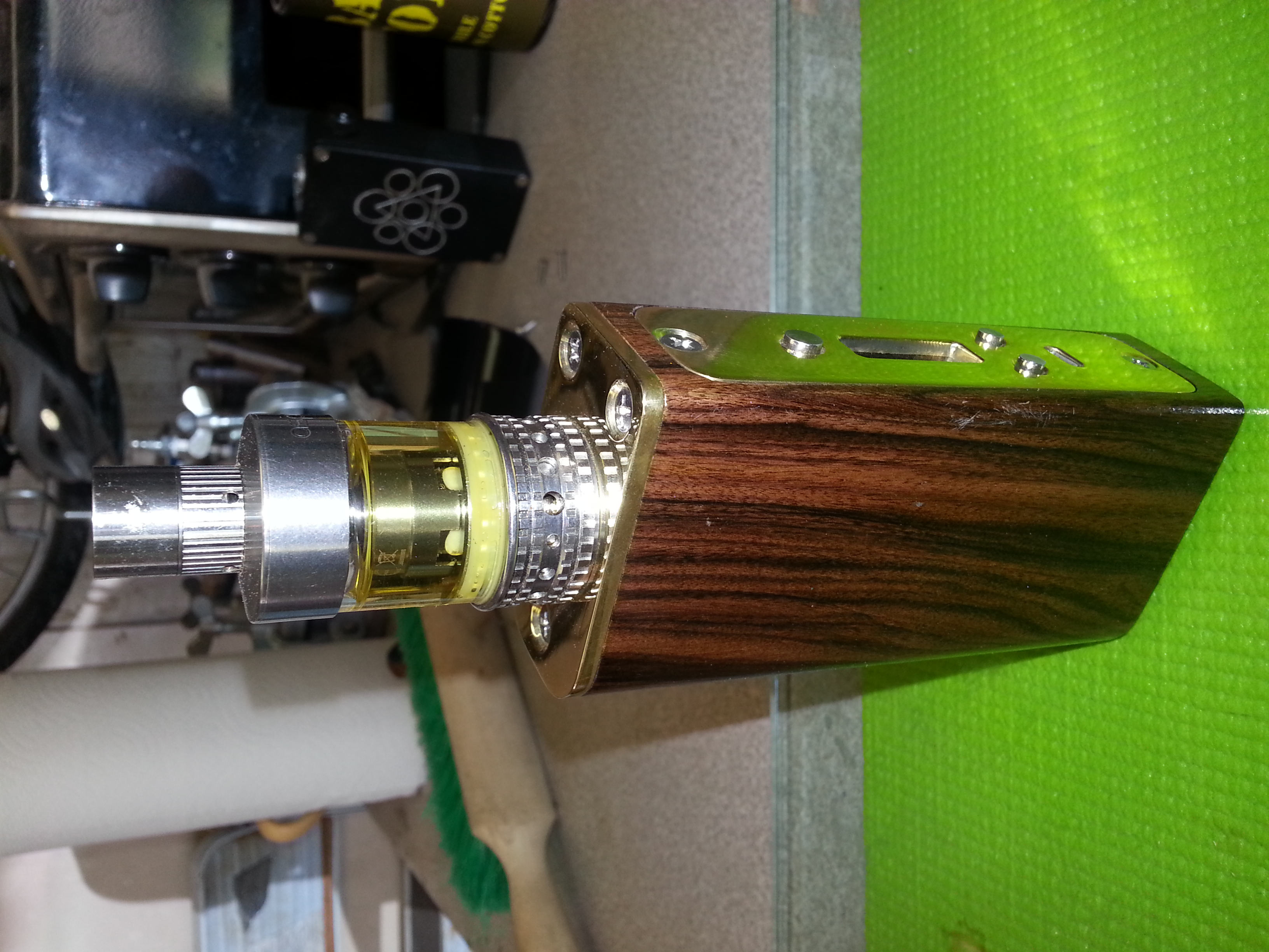

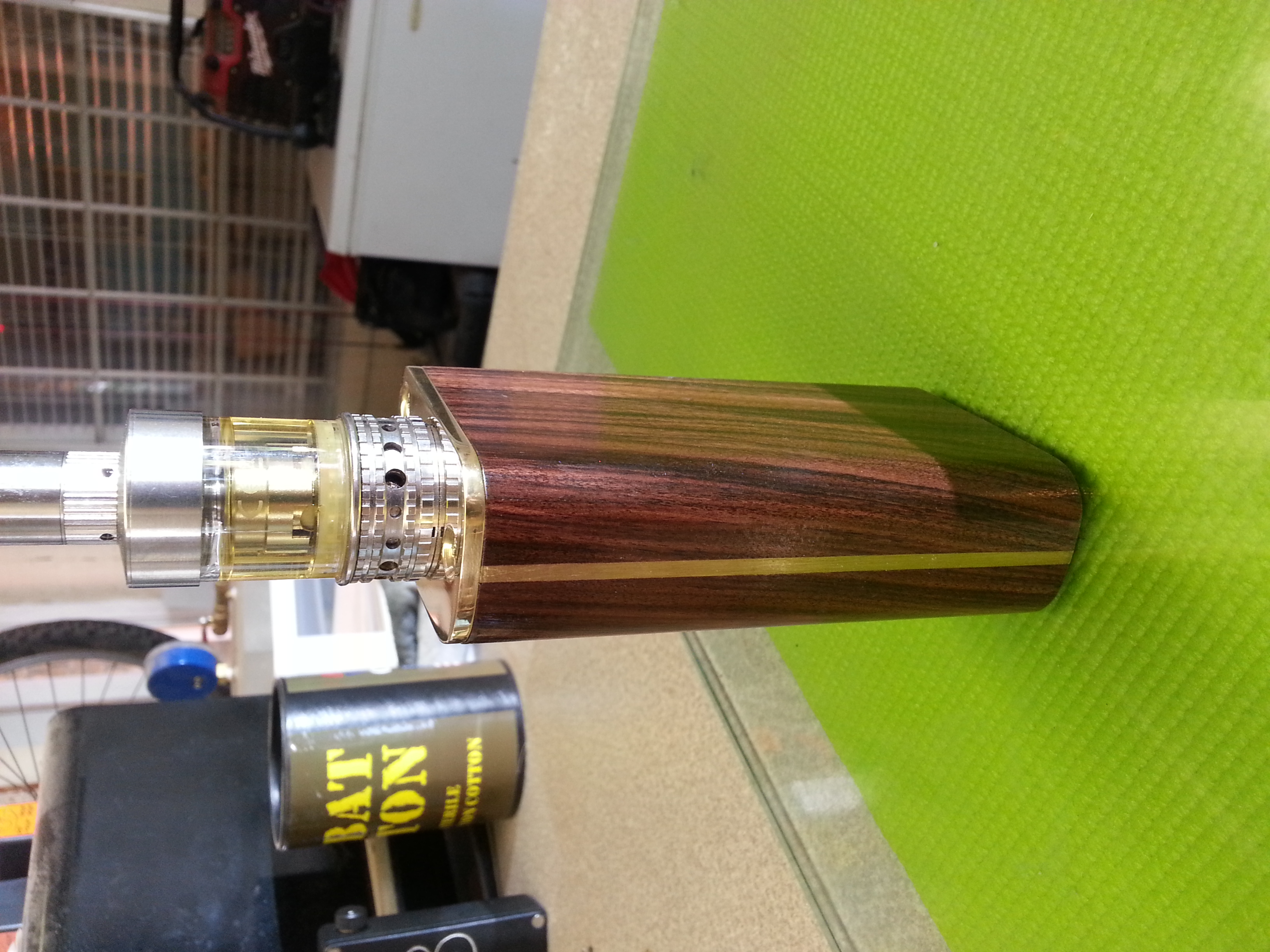

synergymodz Posted July 12, 2015 Report Posted July 12, 2015 Rosewood and brass sealed enclosure with nano tech 1.5

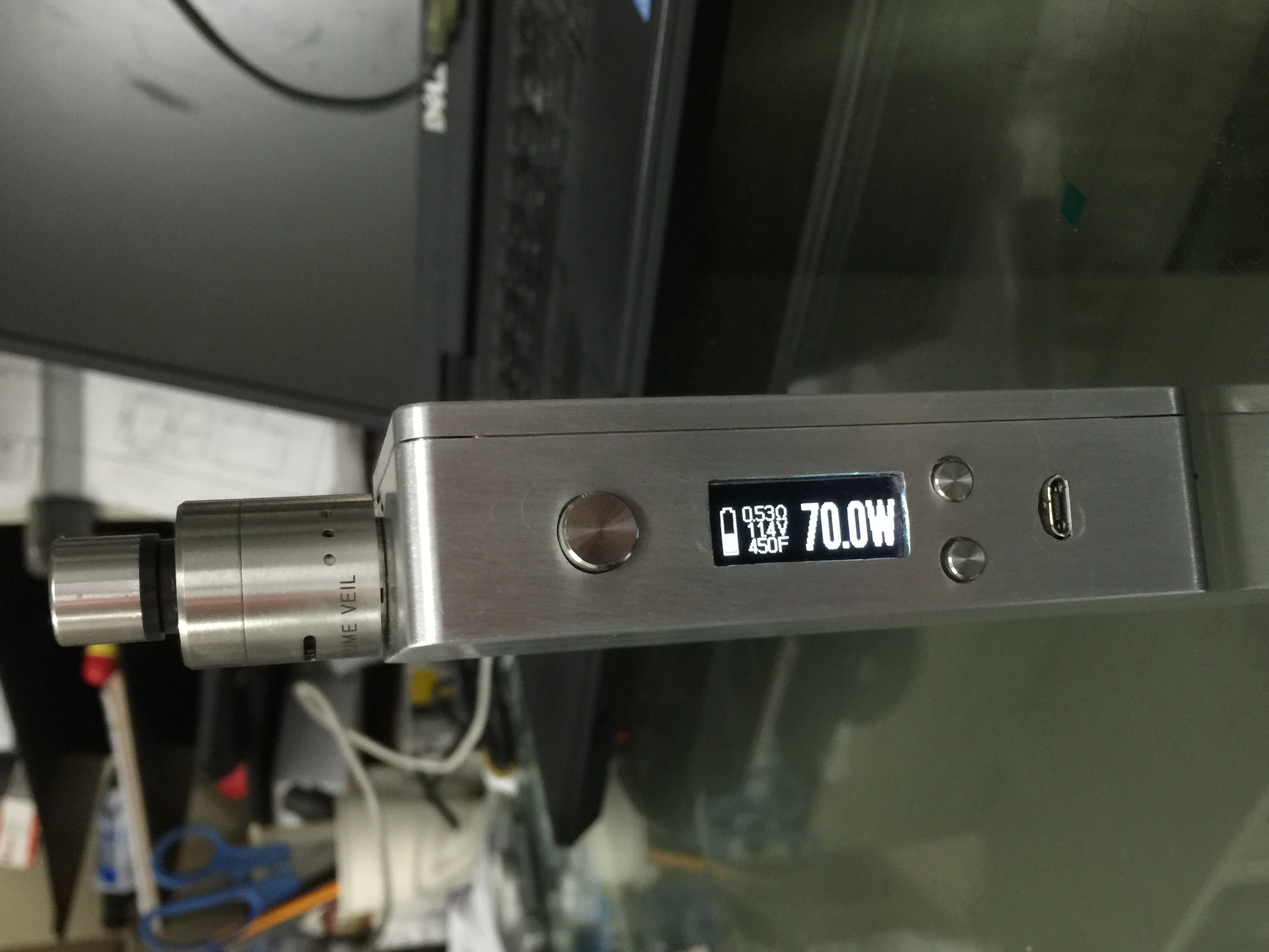

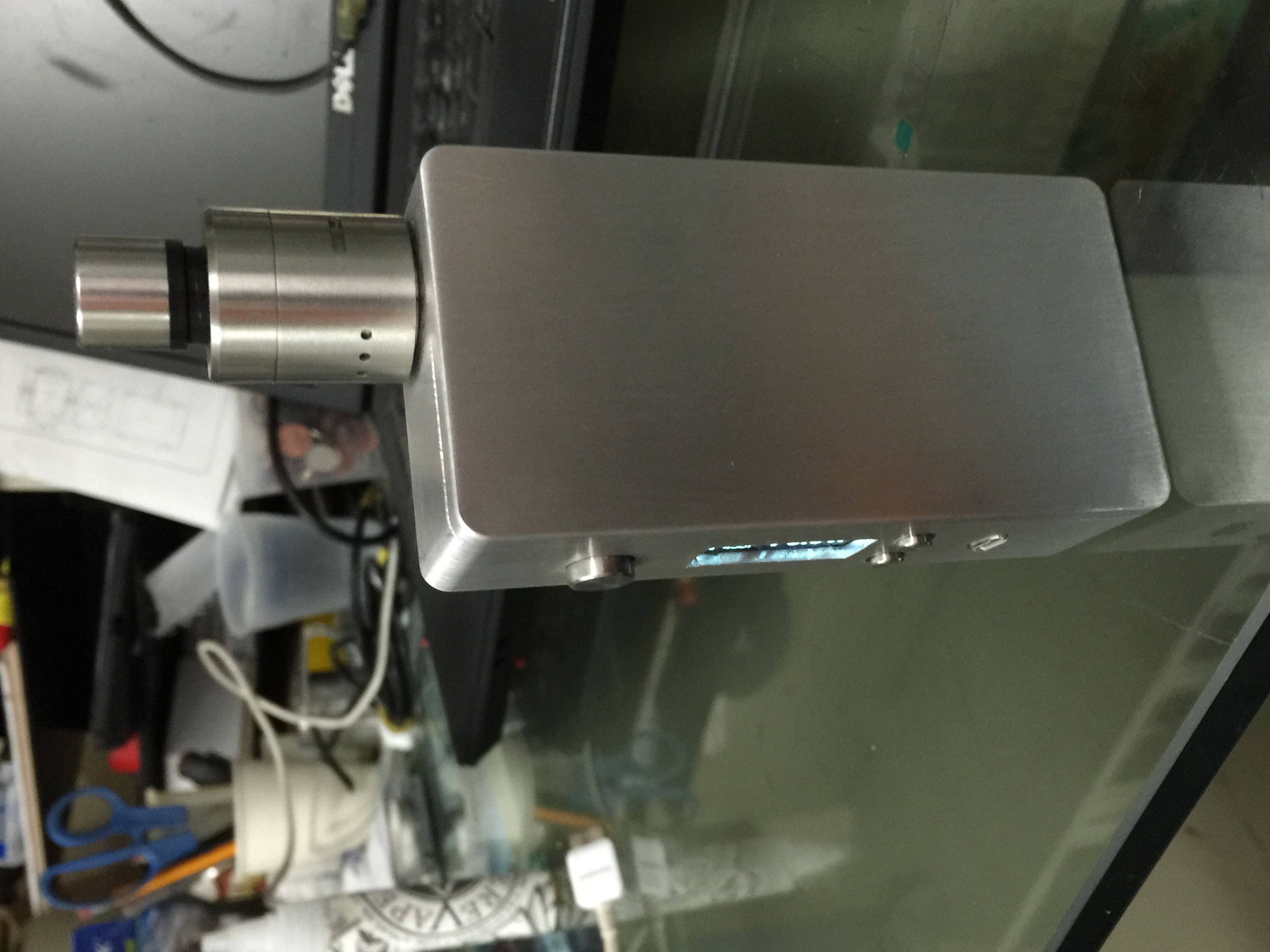

Vape_Like_A_Boss Posted July 16, 2015 Report Posted July 16, 2015 This is my new baby, and I'm absolutely loving it. The pictures aren't nearly the quality the device deserves but I couldn't wait any longer to share it. I'm so impressed with the device and the chip, it's already so impressive how well developed the chip, firmware, and escribe software is.http://imgur.com/a/j9J6Q

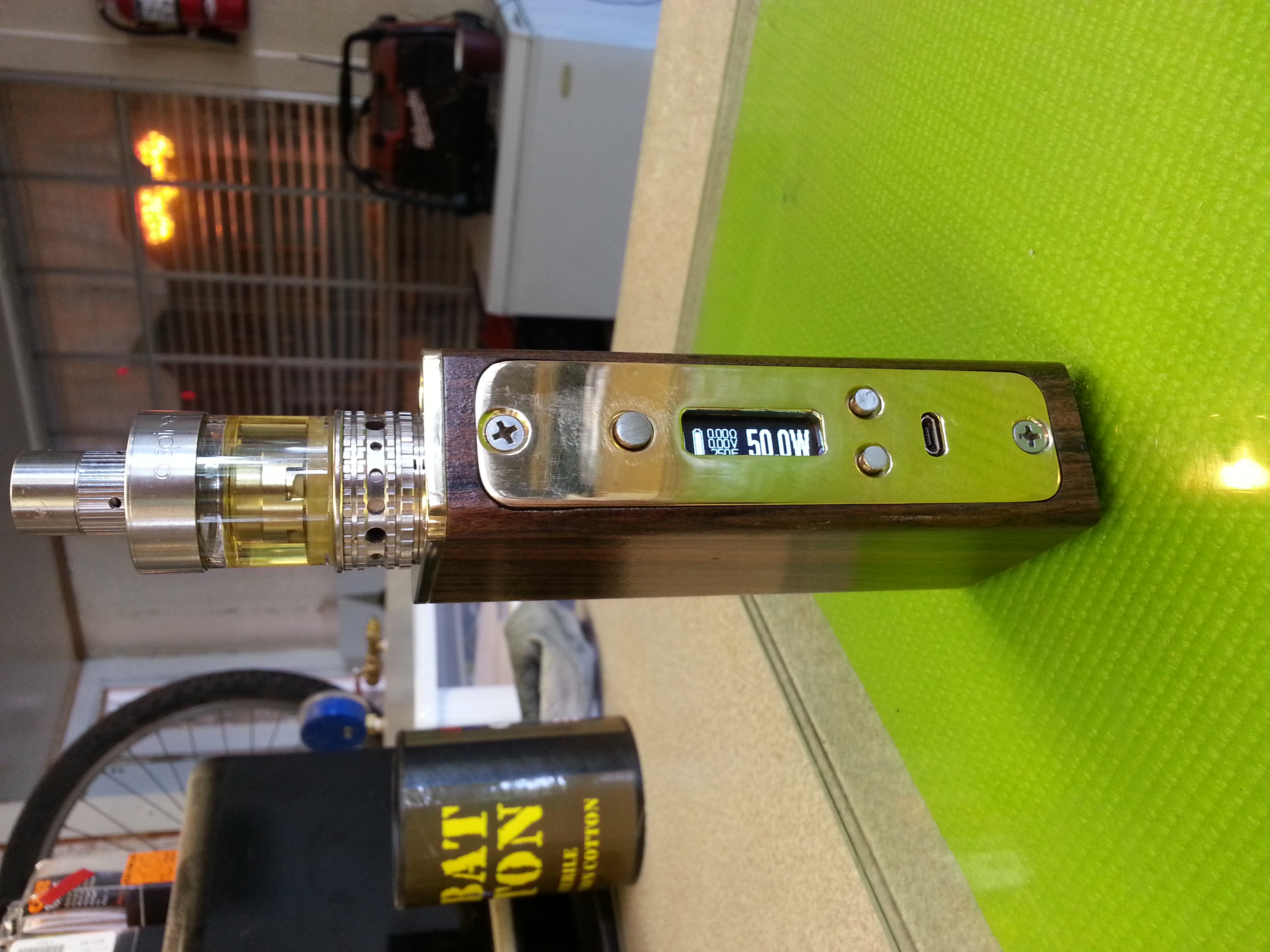

alee132 Posted July 17, 2015 Report Posted July 17, 2015 Here is mine. I think I might redo it as I did it too fast and made some minor overcuts for the faceplate hole, they are hard to see here because I filled in where it happened with black marker. I have another box I got just in case that happened. But now that I got this one together I can make it perfect the second time around. It was really hard to fit in the case and instead of taking off some of the inside of the plastic on the faceplate I took more out of the case which was a mistake. I am loving the dna200 though. It far surpasses my expectations after the dna 40. It seems to be more accurate. I also have 2 battery's. Turnigy 3s 950mah nano tech's. I use a lipo charger most of the time and just swap battery's as it's faster that way and I do it in a lipo charging bag. I also cycled them several times each by charging/discharging with the lipo charger. I have tried the usb charger which does a great job but the 1amp is just slow. Although you will get more cycles out of the battery's that way I believe. The battery's are only like $10 or so for these ones. I am also thinking about getting a second one eventually and using a 1590g/3D printed lid or faceplate and a maxamps 1850 3s battery. They seem to be best size I could find for the mah that will fit in the 1590g. Although maxamps are not cheap but can't beat em, most others are only 1300/1400 that will fit in the 1590g.
