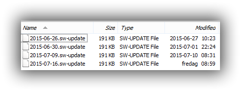

Can see my exact timestamps in this image between installations, ran first firmware for a few days and upgrading when new builds to avail. -

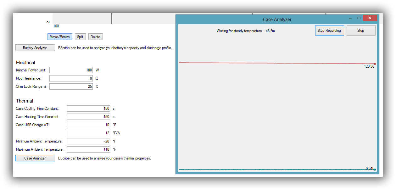

Case analyzer results and differences compared to default settings, I will try and lift/mount my board up a millimeter or so from my casing and see if that helps -

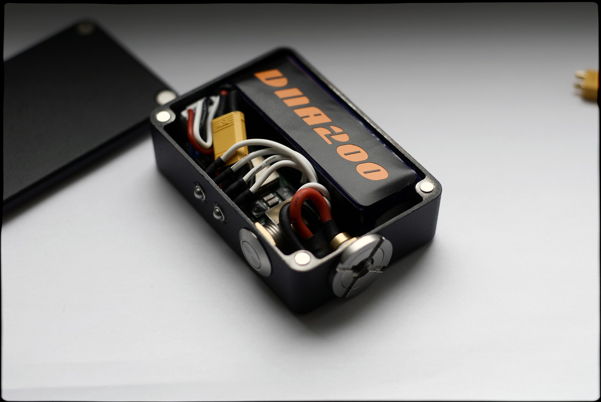

In small enclosures you would like XT30 very much, a sizecomparison below, 14awg stranded wire might be to big soldering but 16/18awg will work just nicely by default with XT30. -

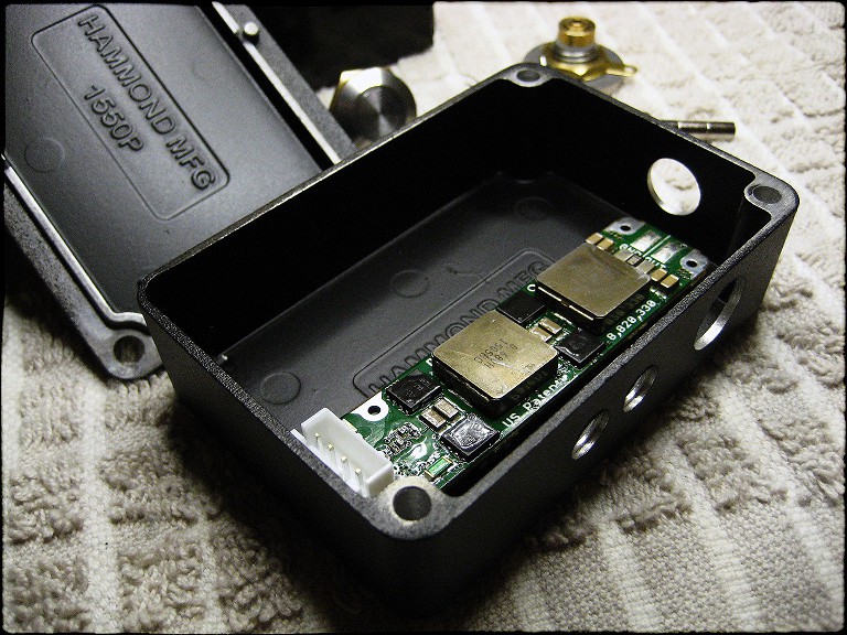

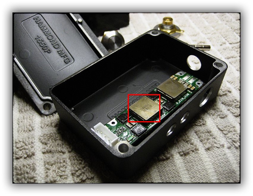

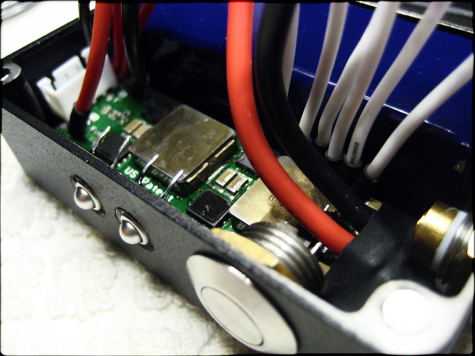

My wattage usually at 25-30watts and past two days board getting warm like this so could be an update but I'm not sure. This part in particular gets warm, if I take a puff while charging sensor kicks in and lowers charging to 0.09, then I have to wait and unplugging my battery seems to help for it to reset. But will try the case analyzer, should I set USB current to 0 in diagnostics while doing so? -

It has a dab of epoxy in front under the shrinktube and adhesive/epoxied arount back of JST-plug so secured very airy, it has plenty of breathingspace on it's right side Running case analyzer it just waits for steady temp (currently +20min), should I increase my ambient temp? -

Can we raise those limits a wee bit?, first square thingy feels warm when charging but not overly hot -
