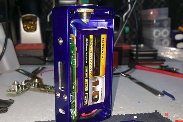

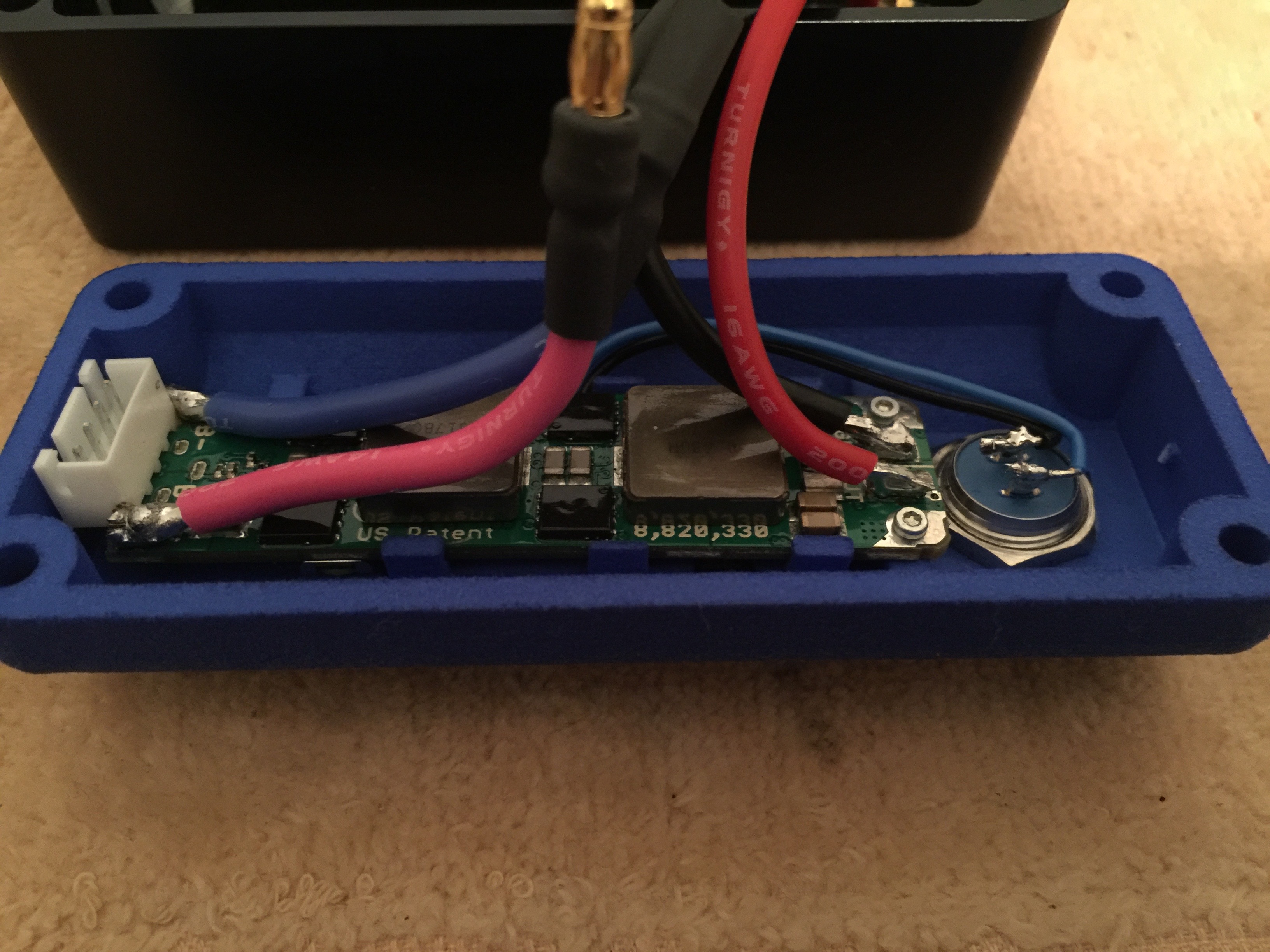

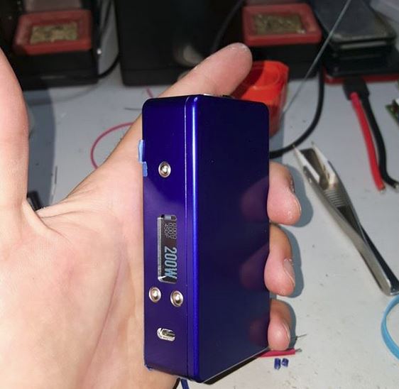

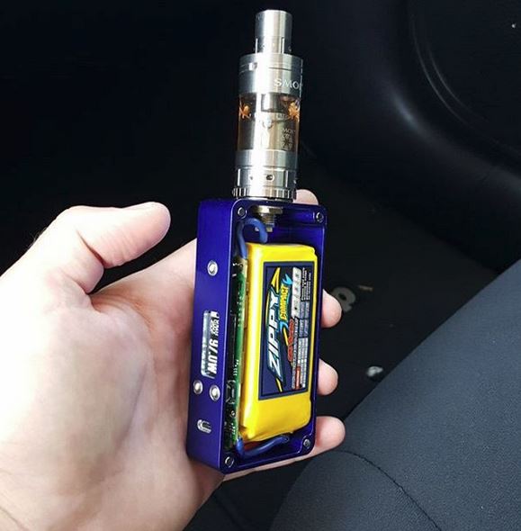

xevape Posted October 12, 2015 Report Posted October 12, 2015 Some I built recently. Lastly the mean LiPo test station
awsum140 Posted October 12, 2015 Report Posted October 12, 2015 I've got to ask...are you double sticking the battery in place since you're using magnets for case closure?
xevape Posted October 12, 2015 Report Posted October 12, 2015 awsum140 said:I've got to ask...are you double sticking the battery in place since you're using magnets for case closure?Yes I have 3M Industrial grade + I pressure fit to the board holding the DNA in place via the use of the tactile buttons and pressure. No need for more holes than needed. I must say though the magnets are carefully placed for a pretty extreme magnetic hold.
lexalove Posted October 13, 2015 Report Posted October 13, 2015 Nice mod, liking your work Is that a wet paint or powder coat finish?
