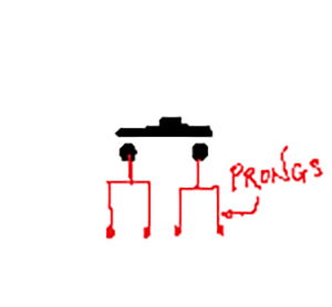

Regarding the tactile switch it does matter which of the 'prongs' you connect to. In my little sketch of the push button switch you can see that there are two prongs on each side of the switch contacts so you'll need a continuity tester to make sure you don't connect to two prongs in the same pair else your mod will act like the switch is pressed all the time. It makes no difference which is used as the +ve side or -ve side. Hope that helps.
