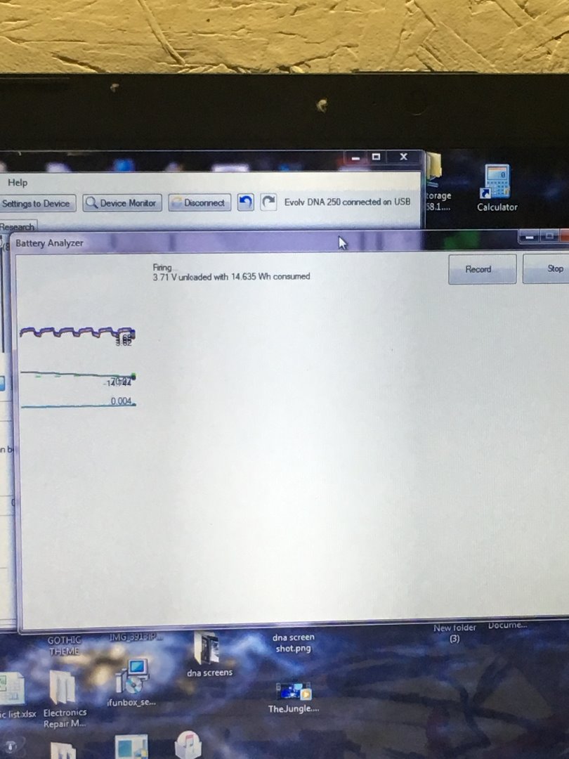

Frogmod Posted September 25, 2016 Report Posted September 25, 2016 Has there been a update fix to the battery analyzer screen
