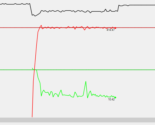

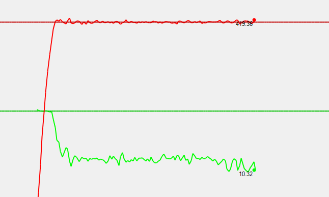

2legsshrt Posted September 13, 2016 Report Posted September 13, 2016 Another thing I have noticed is I have a Therion and a Lavabox DNA75. I only use SS316L and I use the .csv file from SE on both. I have exactly the same settings on both which is 25w 420F. I only use a single coil so I use no preheat since it heats up immediately without it but the Lavabox will hold whatever temp I set it at without ever hitting Temp Protect but the Therion hits Temp Protect every couple of seconds which makes no sense to me. Why would it do that using the exact same settings and using v1.2SP3 on both. Am I missing something when I run Device Monitor they are both holding temp relatively stable. I am kind of new to the DNA but I love them coming from YiHi. For SS they seem way better to me. Oh I should add that my Triade DNA200 does just like the Therion with the same settings. Only the Lavabox doesn't hit Temp Protect. I know it's not a bad thing for it to do that but I'm just curious.

2legsshrt Posted September 14, 2016 Report Posted September 14, 2016 Well I did that but not sure how to get them from the folder I saved them in to this board. I used the snipping tool then saved them to a file in my Pictures folder. How do I get them to here.
2legsshrt Posted September 14, 2016 Report Posted September 14, 2016 The first one is the Lavabox the next is the Therion
2legsshrt Posted September 14, 2016 Report Posted September 14, 2016 I was using a setting of 415F and the watts were set to 25w

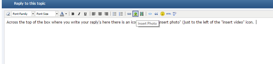

retird Posted September 14, 2016 Report Posted September 14, 2016 Click "more reply options" first. Across the top of the box where you write your reply's here there is an icon to click to "insert photo" (just to the left of the "insert video" icon.
2legsshrt Posted September 14, 2016 Report Posted September 14, 2016 I figured it out like I say I am new to this stuff. But as you can see they both hold the temp pretty close but the Lavabox smooths out even better then the Therion

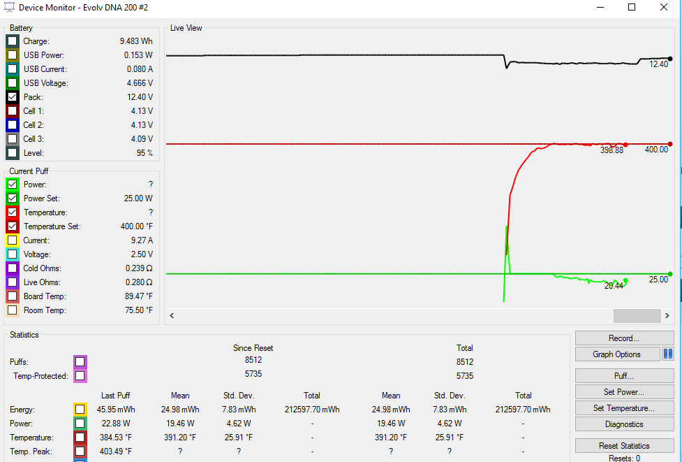

retird Posted September 14, 2016 Report Posted September 14, 2016 Yep, looks pretty good but what I also wanted to look at was the data on the left side of Device Monitor....the ohm's temp settings, wattage settings, board temp and etc.Kinda like this:
