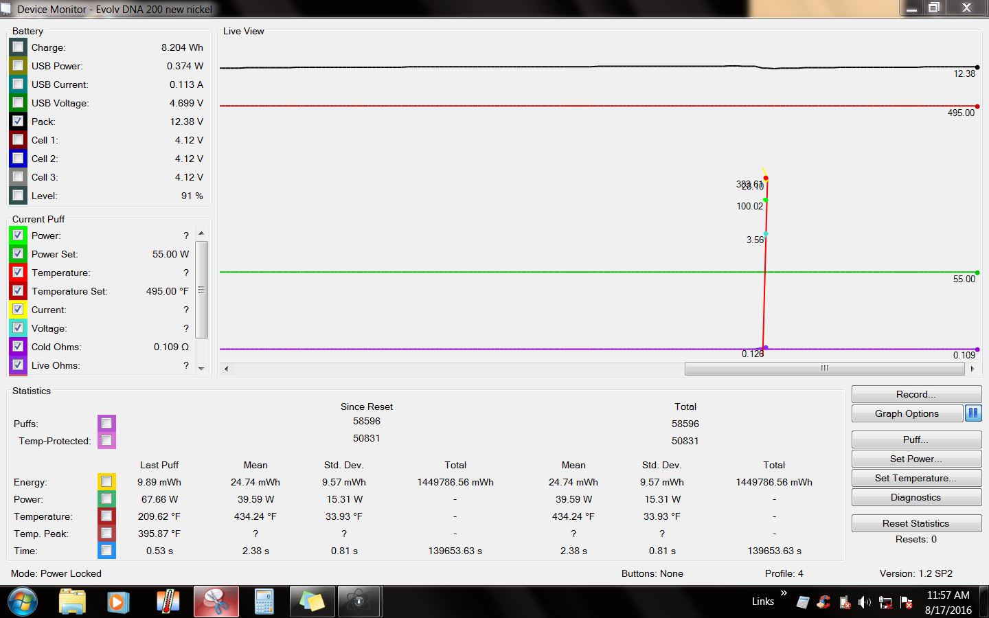

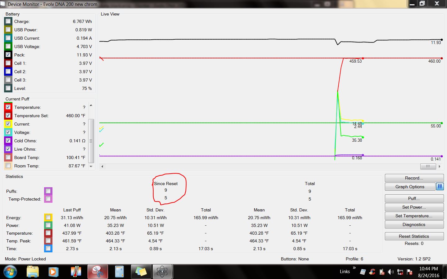

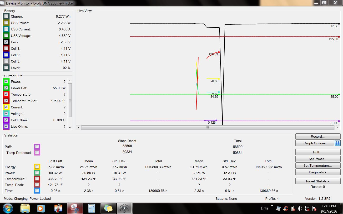

Have an issue hopefully someone can help with; upgraded to sp3 and now temp mode using ss316L sucks. I have it set to 47 watts 480F using steam engine TCR for SS. 5 or 6 drags in vapor diminishes quite a bit. with previous firmware temp mode was kick ass. Not sure what's wrong now....
Did you change anything at all after updating?  Sound's (to me) like either there is a connection problem inside the atty like a loose screw on a post would cause, or a problem with the board seeing the true ohms, a common cause I've had is a dirty 510 on the atty and/or mod.
Did you check it in "Device Monitor" while using it so you can see and monitor what the board is seeing and putting out? Watching what's going on during use can point you where to look.

All I changed was the mod resistance and thermal settings.
