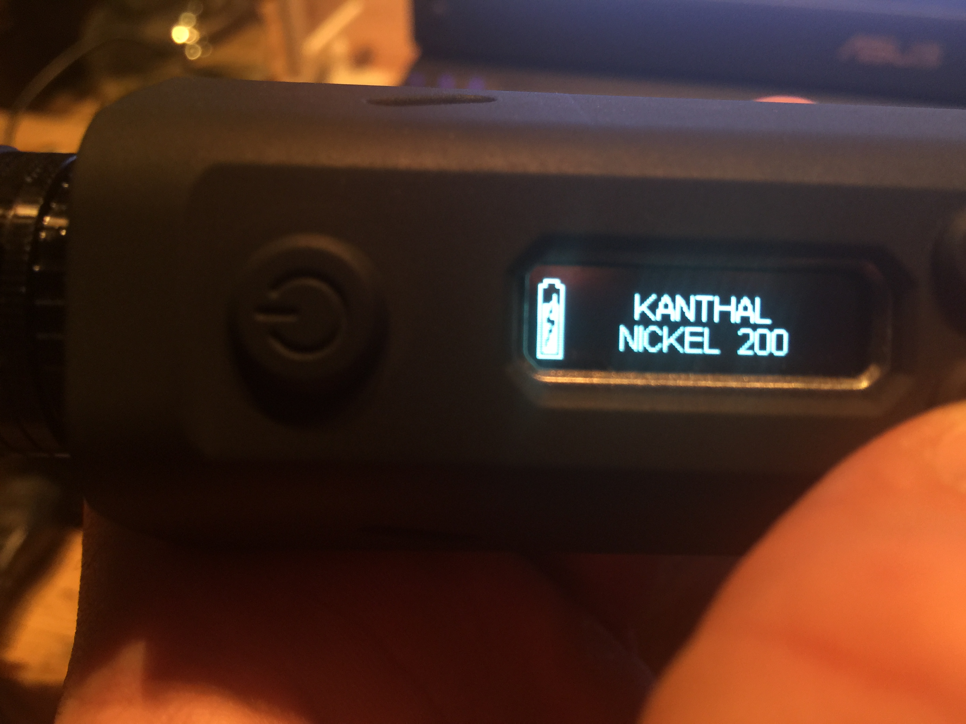

fugitiv3 Posted February 13, 2016 Report Posted February 13, 2016 Hello All,Just updated to the latest firmware (12.02.2016) but when changing between profiles I got 2 names one on top and one on the bottom. I believe the bottom one is the name of the material. Is there any way to remove that and just leave the Profile Name?See an example below:Thanks

The Chosen One Posted February 13, 2016 Report Posted February 13, 2016 fugitiv3 said:Hello All,Just updated to the latest firmware (12.02.2016) but when changing between profiles I got 2 names one on top and one on the bottom. I believe the bottom one is the name of the material. Is there any way to remove that and just leave the Profile Name?See an example below:Thanks Connect to Escribe and you will find one of the profiles has kenthal as a title, had the same on mine,just change it to what you want
Voku Posted February 13, 2016 Report Posted February 13, 2016 fugitiv3 said:Hello All,Just updated to the latest firmware (12.02.2016) but when changing between profiles I got 2 names one on top and one on the bottom. I believe the bottom one is the name of the material. Is there any way to remove that and just leave the Profile Name?See an example below:ThanksAt the moment only by upload a picture from the profile name
steefmobiel5 Posted February 13, 2016 Report Posted February 13, 2016 Top is profile name bottom is wire name. So giving profiles more generic names like preset 1, would make a less confusing screen when you change wire type for a given profile. Also loading a custom screen will get rid of double names, but you would have to remember which wire type you chose if you change wire type for that profile.
