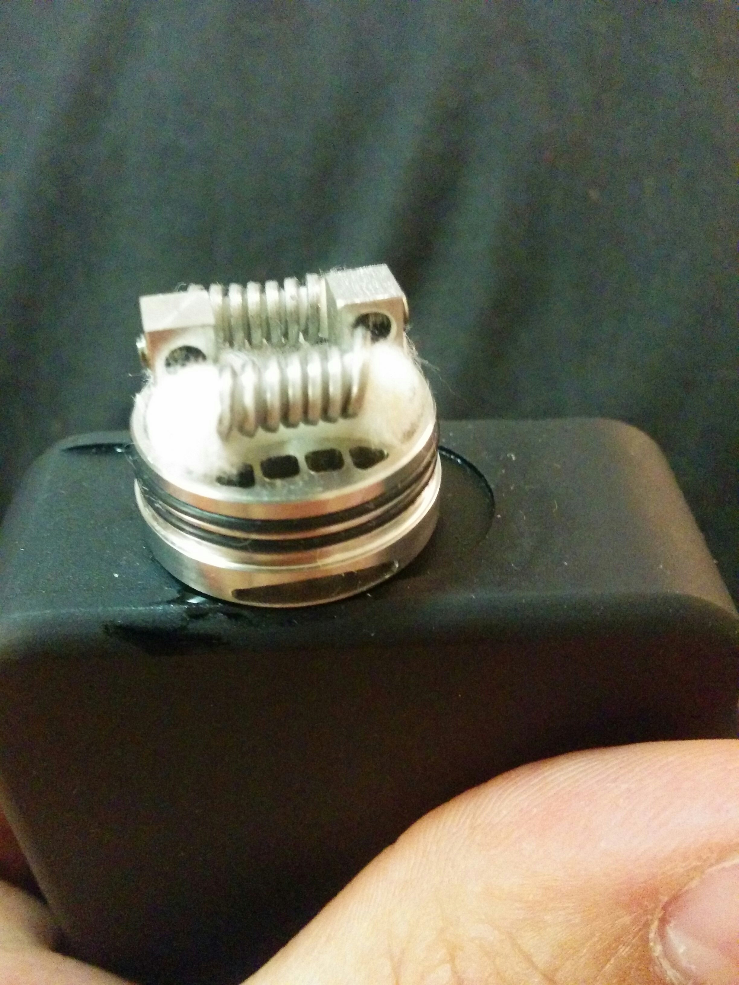

Ken Nutter Posted September 25, 2015 Report Posted September 25, 2015 20awg square TI... Ahhhhh its OK... Going to try Clapton TI now that I got more wire and a couple smaller gauges.

IllinoisPlumber Posted September 26, 2015 Report Posted September 26, 2015 Is it normal for a ti coil to raise approx.1 ohm after break in? It seems that every coil i build will be rock solid for a day and then jump .1 ohm higher. After the jump it stays stable at that ohm and i have to adjust the temp and wattage to get the vape I like.... For example, i built a 28g parallel coil two days ago. 8 wraps at .18 ohm two days ago. vaped it all day at 55 watts 480f. Yesterday when I woke up it jumped to .28 ohm and i had to raise the watts to 85 and temp to 530f to get the same dense warm vape. Not getting any dry or burnt hits and has been rock solid since then. Anyone else have the same experience?
valld Posted October 7, 2015 Report Posted October 7, 2015 IllinoisPlumber, this is not right and it's not normal. The resistance can change a bit (0.01-0.02 Ohm) with tight connections and solid build, after some days, but no way to have such big difference. Something is wrong with your connections somewhere, check your 510 connector on the mod and your atomizer, coil, mounting posts, 510 pin, every possible contact. Also checking your build in Steam Engine, the correct resistance looks to be the .28, so probably you had a short somewhere in the coils and it was showing way lower resistance. Always use the steam engine calculator when building new coils, especially dual coils, and check if the resistance of your new coil matches the calculator result, before wicking and firing.

paochec Posted October 30, 2015 Report Posted October 30, 2015 hi, i'm new to titanium coils (been using ni200 for more than a year on a dna40) i built my 2nd Ti coil today and noticed something strange, i always have to intentionally raise (and locking) my resistance by approximately 0.03 ohms for the coils to work properly. i'm using steam engine's TFR (Titanium1)Profile Settings:370F17.5watts30watts pre heat (punch at 11)steam engine Titanium1 TFRusing my Uwell Crown Tank, my first build was: 24ga 6 or 7 wraps 2.5mm guide resulted at 0.35ohms cold resistance had to raise it to 0.38ohmssecond build:24ga 5 wraps 2.5mm guide resulted at 0.22ohms cold resistance had to raise it to 0.25ohmsthe coil doesn't give me anything when i follow its true resistance (hits TP within 1second), but after raising the resistance by 0.03ohms it suddenly works greatis this normal? or somethings wrong? thanks in advance guys!
Spirometry Posted October 30, 2015 Report Posted October 30, 2015 100%PG has a boiling point of 370.8°F and not too many people vape 100% PGInstead of raising your resistance, try raising your temperature setting. Your wattage settings are pretty low, are you doing mouth to lung?
paochec Posted October 30, 2015 Report Posted October 30, 2015 @Spirometry Thanks yup just did that. raised my temp to 460-480 (still experimenting) and i'm at 23-25watts...works great now! and yes mouth to lung vaper herestupid me, the 300++ temp reference was from dna40 users i believe

antyac2108 Posted November 17, 2015 Report Posted November 17, 2015 Has anyone tried parallel TI coils. I'm thinking of doing some 24ga Parallel. Any thoughts on this anyone? Thanks much
flem Posted November 17, 2015 Report Posted November 17, 2015 jj6404 said:Has anyone else had success with contact Ti coils yet? I don't want to waste my Ti wire on a contact build until I hear some good cases. I have followed this guide and it works every time.http://blog.craftvapery.com/joshs-definitive-guide-to-temperature-control-with-titanium-wire/
antyac2108 Posted November 17, 2015 Report Posted November 17, 2015 I did the same that's why I'm asking if anyone has done parallel. I did 8 wraps dual contact could and it vapes really nice
bmclaurin Posted November 17, 2015 Report Posted November 17, 2015 antyac2108 said:Has anyone tried parallel TI coils. I'm thinking of doing some 24ga Parallel. Any thoughts on this anyone? Thanks muchYep, works fine. I did a fused Clapton with a strand of 32 gauge Nichrome 80 wrapped around two straight, parallel strands of SSV Ti wire 0.5mm. Then did 5.5 wraps around a 3mm post. Settled in at 0.11 ohms cold. Note that this is a single coil. It would be too low in dual coil setup.
antyac2108 Posted November 17, 2015 Report Posted November 17, 2015 Yeah I just got done building them dual Parallel 24ga. Cold ohm 0.05 hitting real nice. 125 watt preheat 8.5 punch 60 watt. Loaded csv from stream engine also and it's working sweet
jj6404 Posted November 17, 2015 Report Posted November 17, 2015 antyac2108 said:Yeah I just got done building them dual Parallel 24ga. Cold ohm 0.05 hitting real nice. 125 watt preheat 8.5 punch 60 watt. Loaded csv from stream engine also and it's working sweetWhat temp do you use this at?
antyac2108 Posted November 19, 2015 Report Posted November 19, 2015 420F. Sorry for the delayed answer i haven't been on here in a couple of days.
