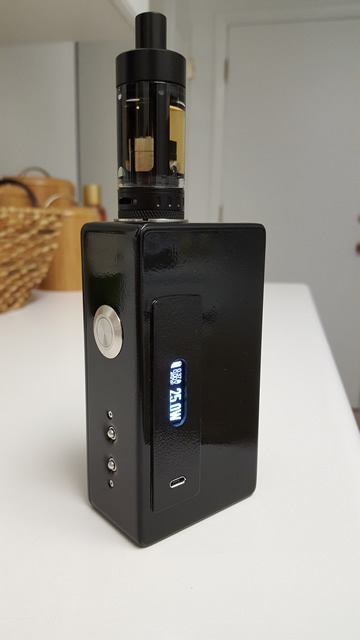

He is my new DNA 200 Hammond 1591 C ABS enclosure Mamu face plate Turnigy nano-tech 2250mah 3S 65~130C Lipo Pack Mitek 16 mm fire button C&K tactile switches It took about 6 hours total to build including gluing the face plate, sanding and painting the box. Battery last about 13 hours of heavy vaping. My next project will be a Turnigy A-Spec 4200 hard pack.

I built my mod with the following parts: Hammond ABS 1591 C project box VariTube 510 connector Mitec 16 mm fire button 2 C&K tactile switches (Watts Up/Doun) Turnigy nano-tech 2250mah 3S 65~130C Lipo Pack DNA 200 Everything worked great for 2 weeks. One evening when I was taking a deep throat hit I heard a quick buzz (less than 2 seconds) and the board was dead. I removed the back cover and that familiar smell hit me. Burnt semiconductor. After inspecting the mod I found to things: 1) The on board fuse opened. 2) The solder connection to the 510 pin had melted. The buzz I heard was probably coming from arcing on the 510 connector. I replaced the on board fuse and also added an inline 25 amp fast acting fuse and modified the 510 connector with a heavy spring but it was too late. The board powered up just fine and I plugged into my pc and started the Device monitor. Right away I noticed the board was running 20 â 25 degrees hotter than before. I took a couple 50 watt throat hits and the unit displayed âWarranty Serviceâ message. Also it takes 18 hours to charge the battery and it used to take roughly 6 hours. Charging would shut down when the board reached 130 degrees. The board is toast. My new board will be arriving Monday and my question is, is a 25 amp fast acting fuse too high? Any input would be appreciated
