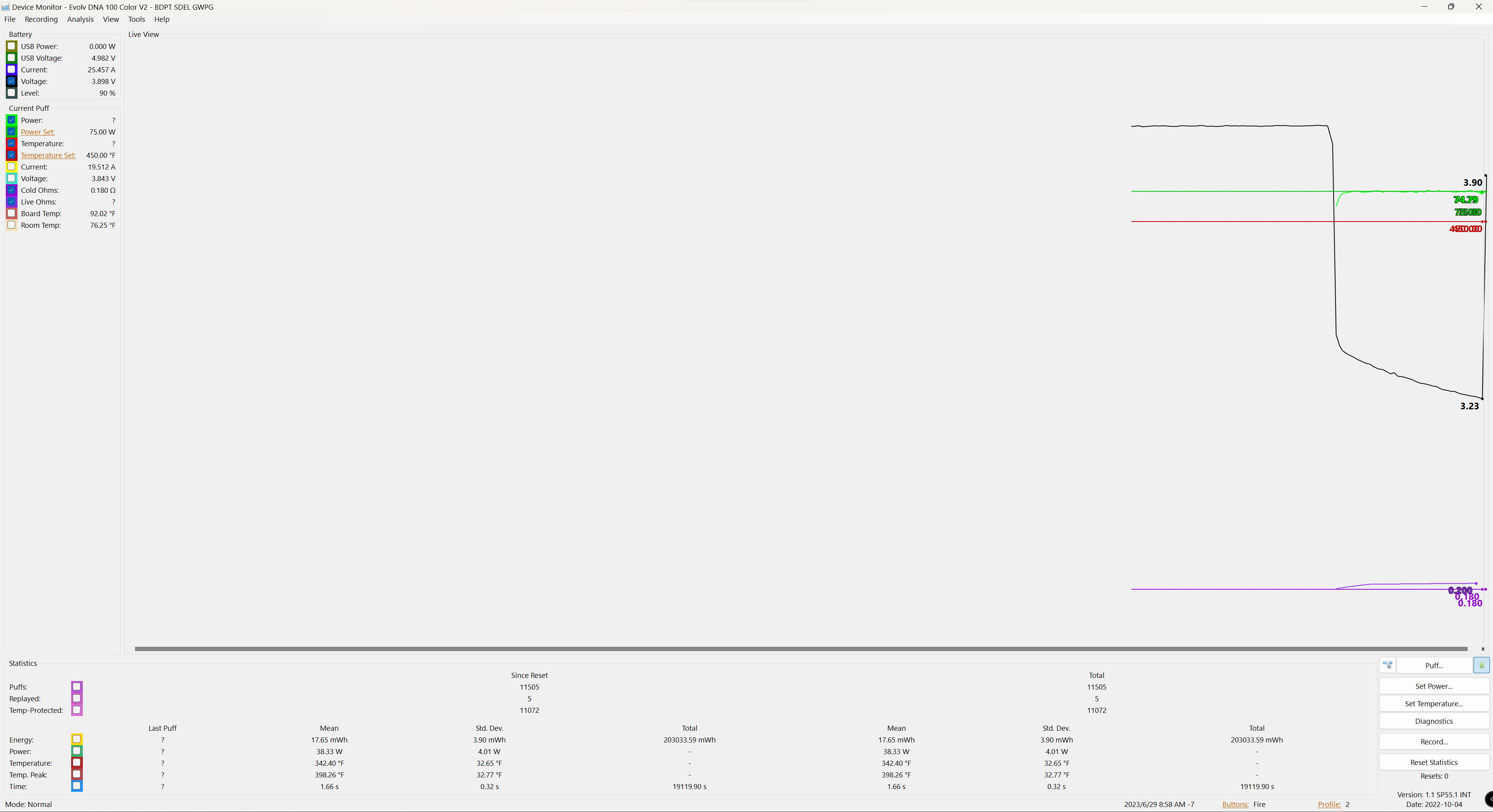

If I were a betting man I'd say that it is 2.75 volts. The board is throttling down just as it should. Am I right?
Again I will ask, what is the voltage showing at red arrow? Hoover your mouse curser over the area and it will show the value. Maybe this will help, if you feel that your battery provides enough amps most likely the battery isn't being held tight enough by the battery door. It is most likely that or battery isn't powerful enough. What battery are you using?
LV thelema 100c wattage capping at 47w.
dwcraig1 replied to Rooski1994's topic in General Discussion
What is the voltage dropping to when firing? EScribe Device Monitor will show this. If your cell isn't powerful enough or the battery sled connections are poor and the voltage drops to 2.75 volts the wattage will throttle down. Below mine dropped to 3.29 volts when firing. -
