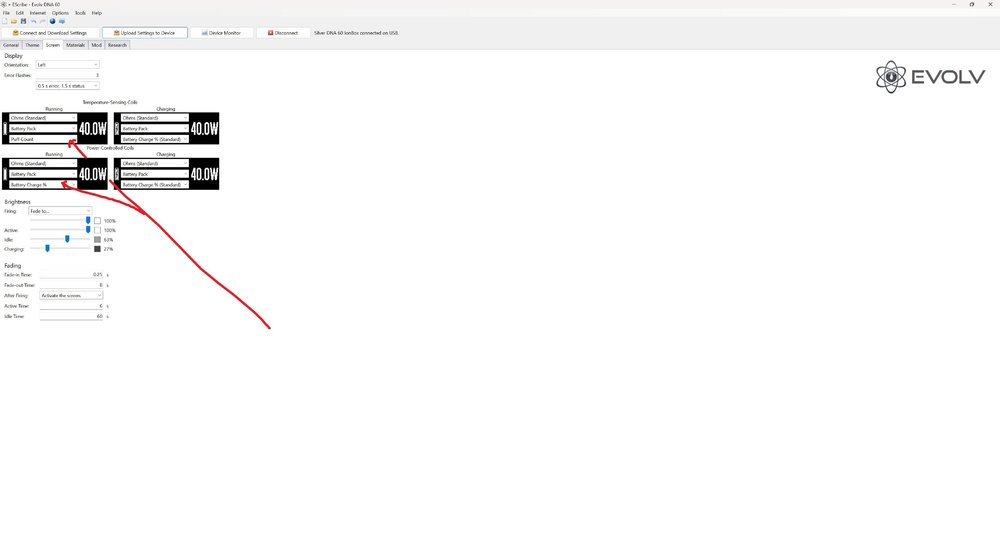

That is the default Evolv theme. Connect to EScribe, go to themes, save your existing theme if desired and select default theme and upload to device.

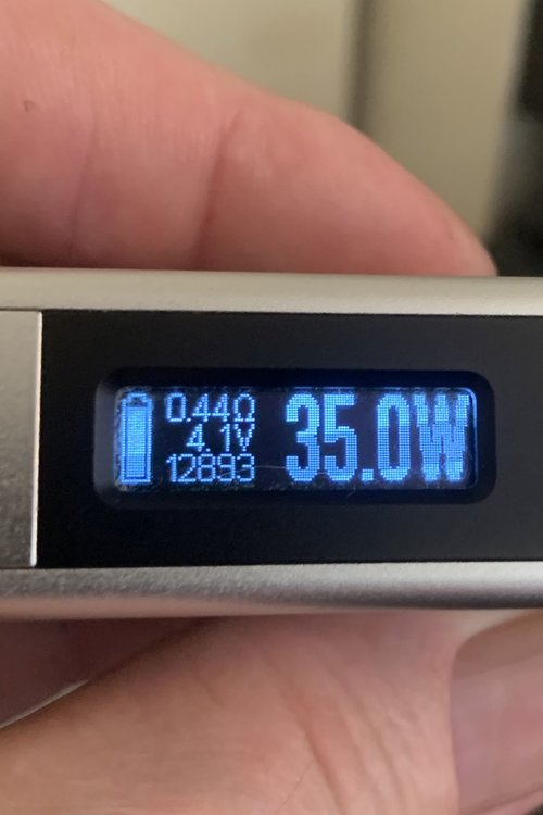

I'm not sure but I pulled the atty off my 250C and on the screen it still said 0.4 ohms. Did you tell it to measure again? What does Atomizer Analyzer in EScribe say with no atty connected? It should have a question mark. -

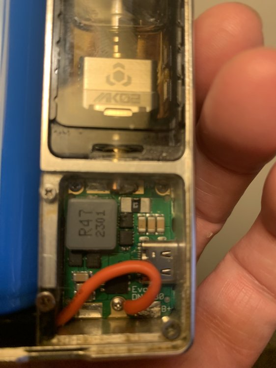

Videos are not working. Does it connect to EScribe? Is is it powered on with battery? Are you using the onboard fire button?
Might the "C" end of your Anker not going in far enough due to the port being recessed (if it is recessed) Edit: I just went back and read the 1st post, so much for the above comment I guess.

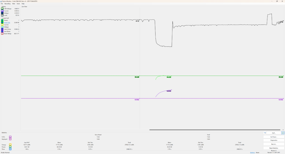

Here is my DNA80C boro mod firing at 50 watts with a Samsung 20S 18650 30 amp cell. This standing voltage was 4.1 volts prior to firing (measured with meter). Note the voltage drops to 3.72 volts during firing. Compare yours firing at 50 watts with a cell of similar charge using EScribe's Device Monitor. I'm not seeing any problem with my board.
