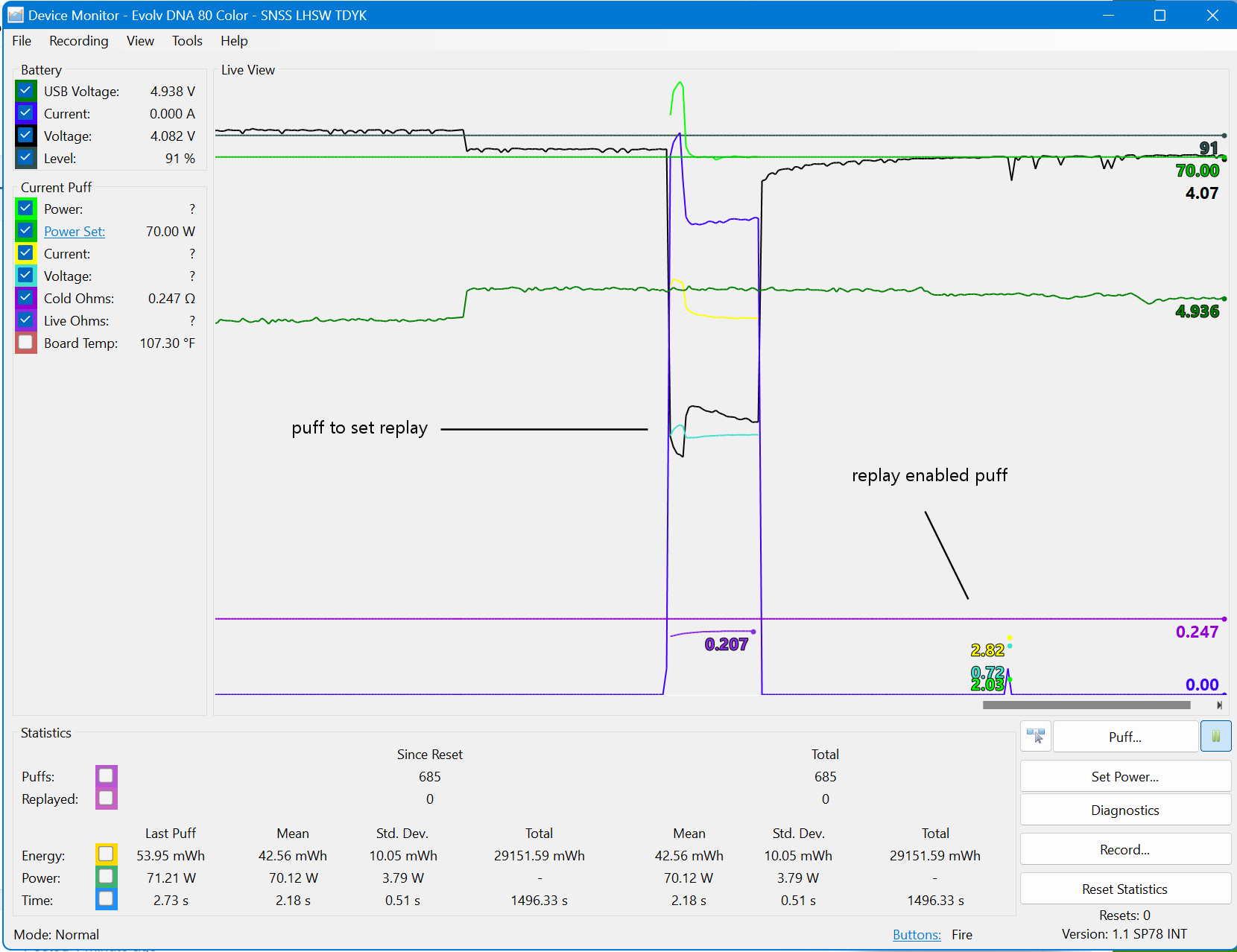

  11. top screen replay not set , bottom screen replay set . nothing but fresh air and the atomizer error message
  12. i set it to 5 probably experimenting , i think its set at 1 as standard as the advice on allowing compatibility with allow on unlikely coils

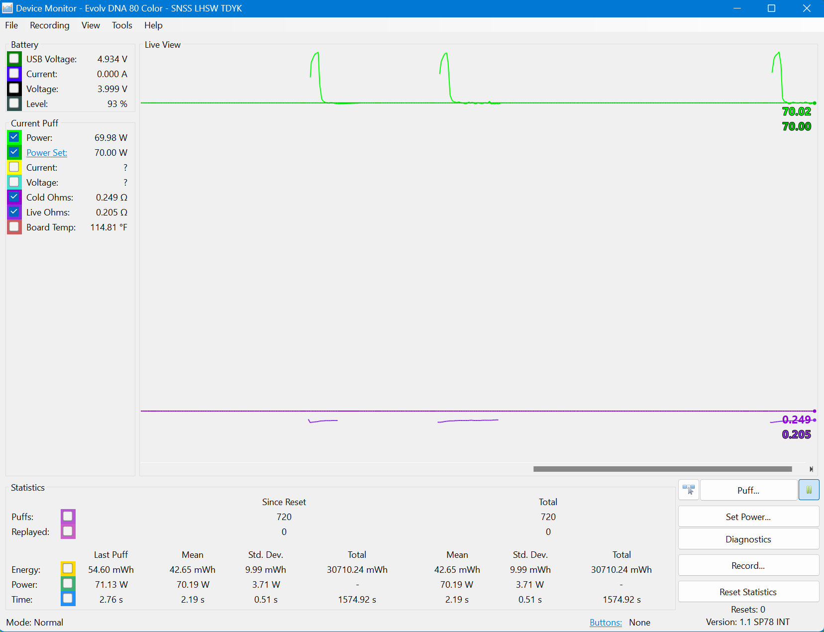

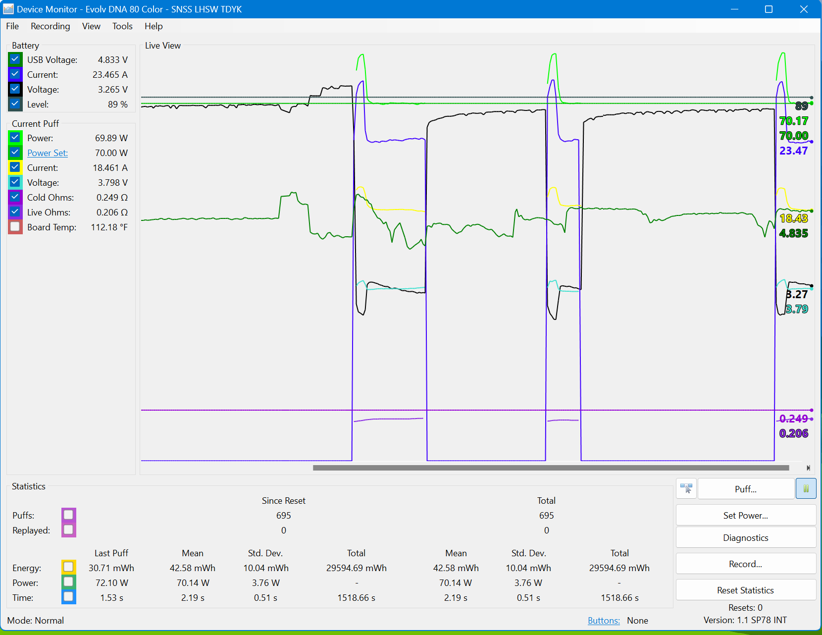

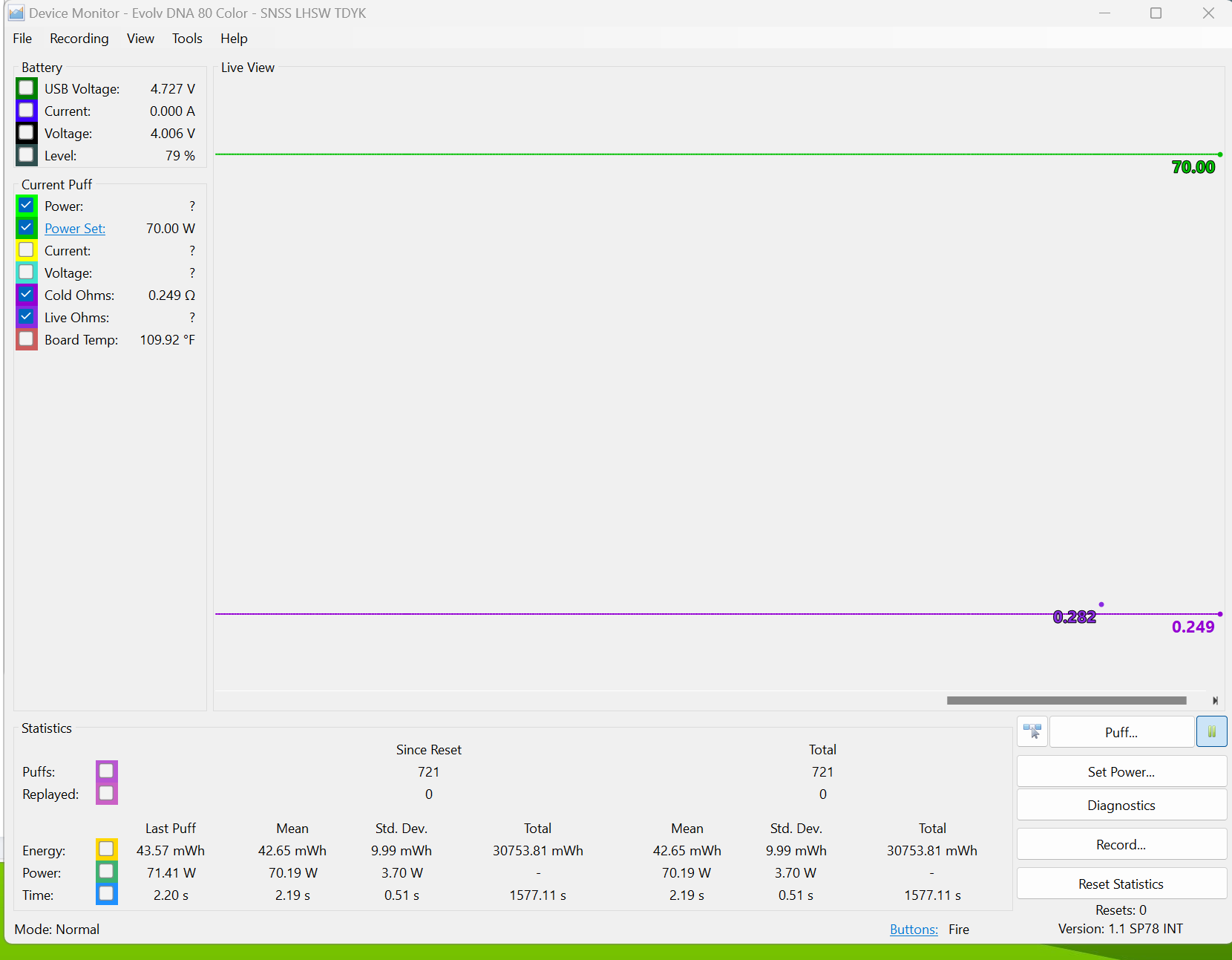

  13. i can only see live ohms when replay isn't set. as soon as set reply after the first puff , the live ohm's show but briefly disappears as it says check atomizer so unable to capture
  14. also a pic of the atomizer analyzer
  15. followed your instructions and here are the results. the rba is a voltrove , it also happed in the stream crave meson boro tank . same results
