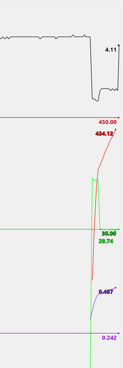

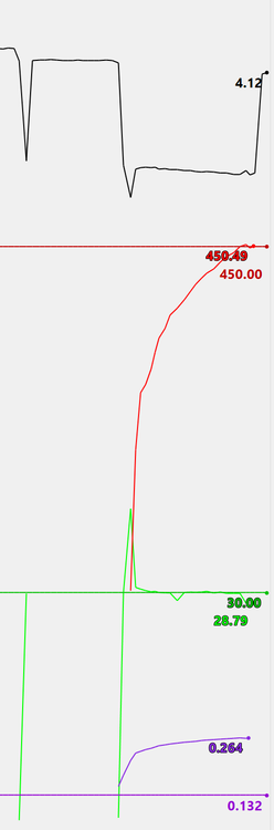

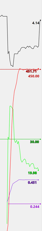

  3. Please show us a screen shot like this of Device Monitor to see the voltage of each cell.

  7. In my case the problem was on two identical new mods. SXK DNA60 Ionboxes. Two different colors purchased from two different places. What I did was to add a blob of solder to the positive contact on the cell. I did this for both mods. This needs to be done quickly and with a high heat soldering iron 100 + watts. I used silver solder and acid flux, same as for house hold plumbing the filed down to desired length. To see if this could be the problem with yours perhaps you could place a small washer between your cell negative and battery door and use Device Monitor to see if you get some improvement before proceeding to my method. The two screen shots that I posted yesterday were from one of these mods before and after my fix. The added length here is 1.5mm.

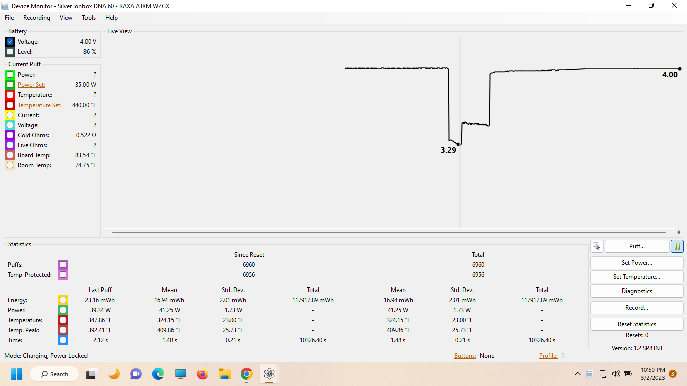

  8. Use EScribe's Device Monitor to see voltage drop. Your Molicel P45B 21700 would be good for way more than 100 watts. There is a poor connection between the cell and board.....for sure. Here is my DNA100C with Samsung 18650 20S 30 amp cell with standing voltage of 4.0 volts firing at 75 watts. Note that the voltage dropped to 3.23 volts. It would continue to fire @ 75 watts till the voltage drop hits 2.75 volts.
  9. Use EScribe's Device Monitor to see the voltage drop during firing. Here on mine the problem was due to the battery not fitting tight enough for a good connection. Poor solder joints or a battery with low amp output could also be the problem. Note if it drops below the Soft cell cut off the power will throttle down (2.75 volts in this case) Included is a screen shot with acceptable voltage drop.

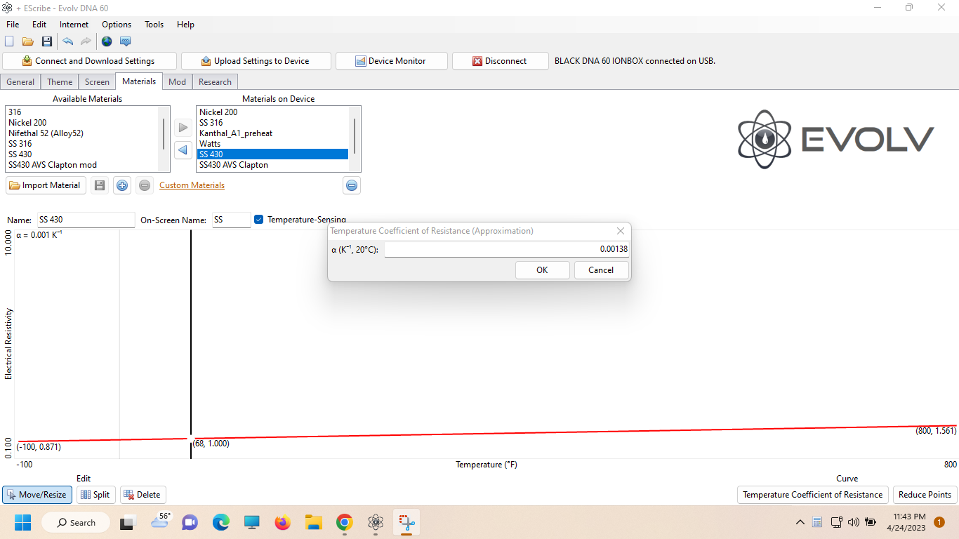

  15. Being SS316L it is an alloy which could vary wildly from the recommended TCR. Start by using just wattage to get an idea of how much wattage that it can handle going by taste the back it off some. I'm looking at your cold vs live ohms, give the TCR value a try for SS340 and manually adjust the SS430 value from there. Recommended value for SS430 is 0.00138, use SteamEngine's CSV file or what came on your mod for starters. This is how I would go about it.

  18. To do it manually the value is 0.004. Select the mateerial to chancge, press the Temperature Coeffiency of Resistance tab and enter 0.004, then OK

  23. If I were a betting man I'd say that it is 2.75 volts. The board is throttling down just as it should. Am I right?
  24. Again I will ask, what is the voltage showing at red arrow? Hoover your mouse curser over the area and it will show the value. Maybe this will help, if you feel that your battery provides enough amps most likely the battery isn't being held tight enough by the battery door. It is most likely that or battery isn't powerful enough. What battery are you using?
