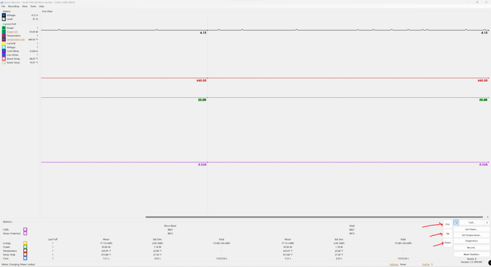

  3. Yes, you got it. Use Device Monitor in EScribe to see it live. Be sure to check the "Power" and "Power Set: boxes.

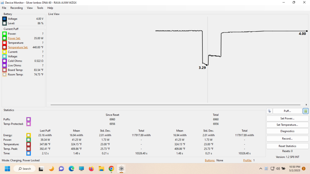

  4. After charging, about 8 hits on it after charging completed. Can you post a screen shot of Device Monitor with yours when problem is occurring?
  5. No problems here, I fired it more 10 times, the last 5 without air. The last three short ones was to catch the voltage reading.

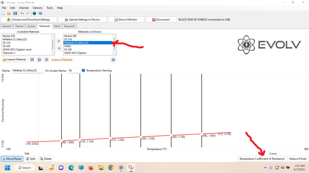

  14. As Ni80 isn't a wire for use with temp control just use "Watts" A lot of good information here: https://www.steam-engine.org/

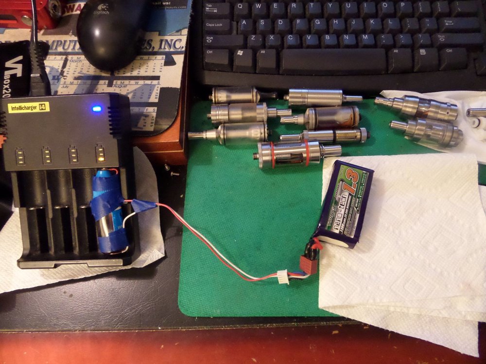

  19. Just a question, are you using the same cells to power the test setup as used in the mod? My 250C dropped 7% in just under 3 days just sitting which I expected.

  21. Here is one of mine firing dry. Don't expect to see the temperature message on the screen as that isn't going to happen on a color board. On yours and my dry fire power starts at 25 watts and drops to 1.25 watts, temperature protection is working as it should.
  22. Is that with a wet wick or no wick at all? Preheat looks to be high, turn it down or off.
