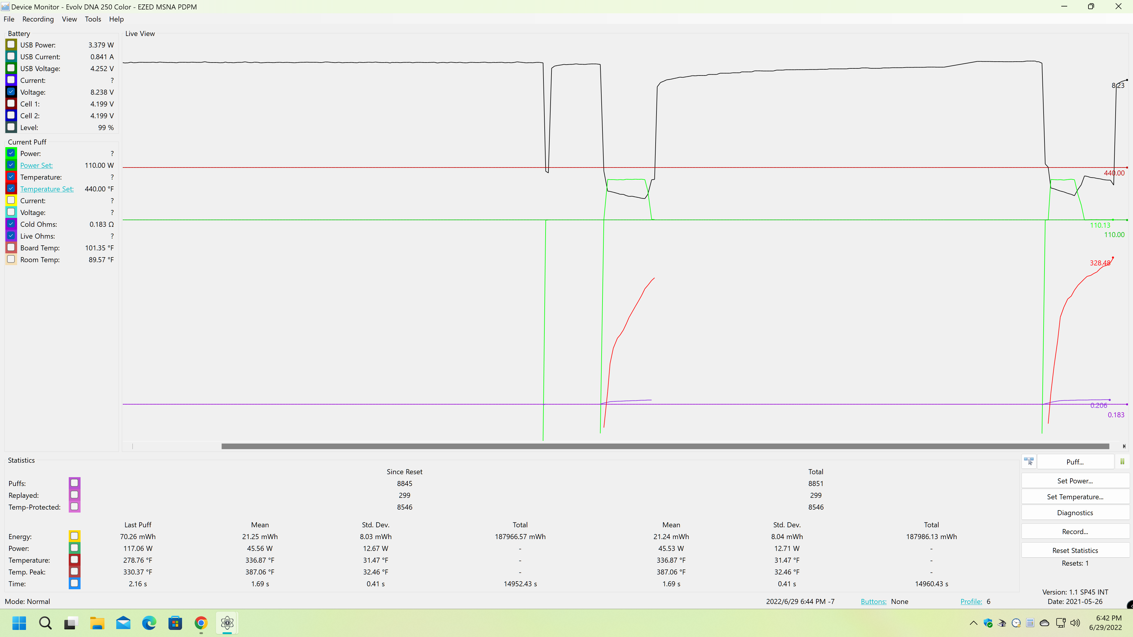

Here's my 250C, first puff it's set to 2 cell LiPo, 2nd puff it's set to 2 18650s. This is in TC mode with SS316. I'm not seeing any difference in power delivery here.

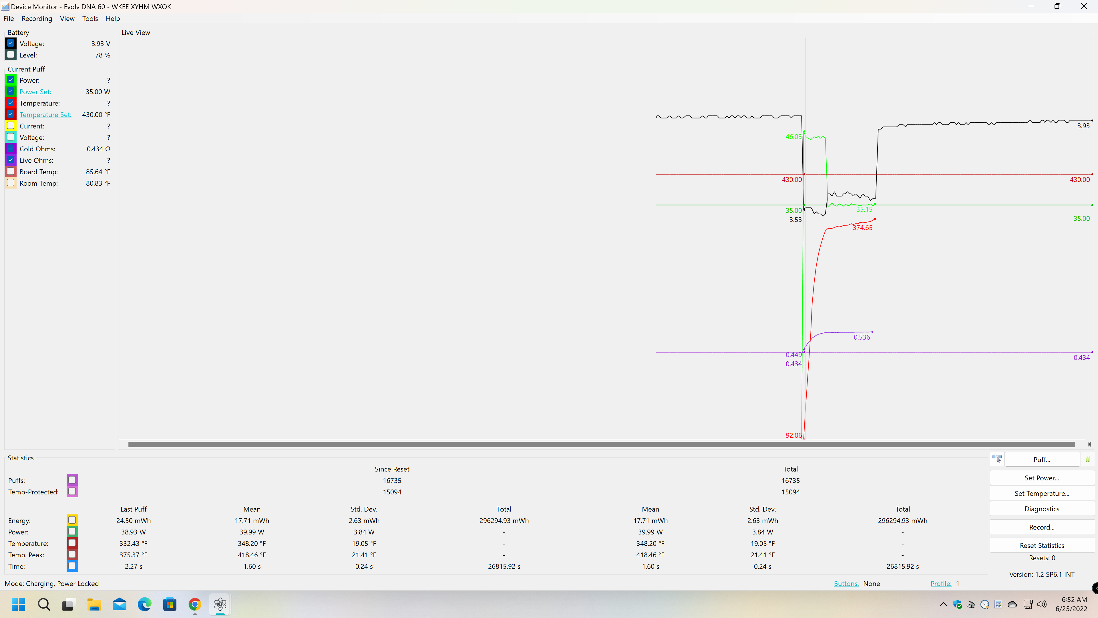

Here is a snippet of my SS316 coil firing in Devise Monitor, while your resistance may be different. Notice the percentage change from cold to hot. Also use Atomizer Analyzer to see that your atomizer is making a solid connection. It should have a good connection before it bottoms out.
