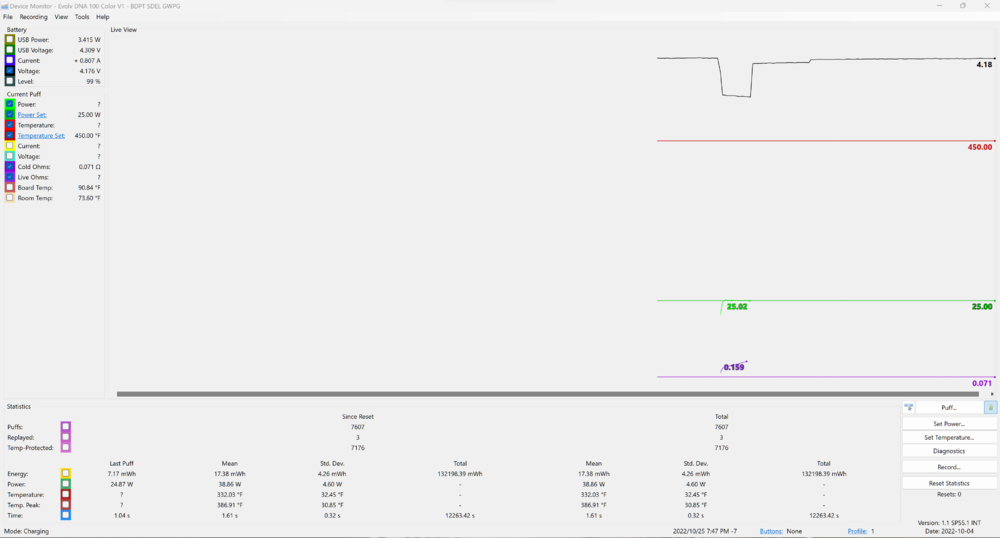

  1. I use twisted 28 gauge SS430 almost always. Here is a snippet of my dual coil SS430 build firing at 65 watts in EScribe's Device Monitor. My coils are 2.7 mm id and 6 or 7 wraps each. It would be most helpful if you could post a snippet of yours firing with the same boxes checked as mine. DNA100C

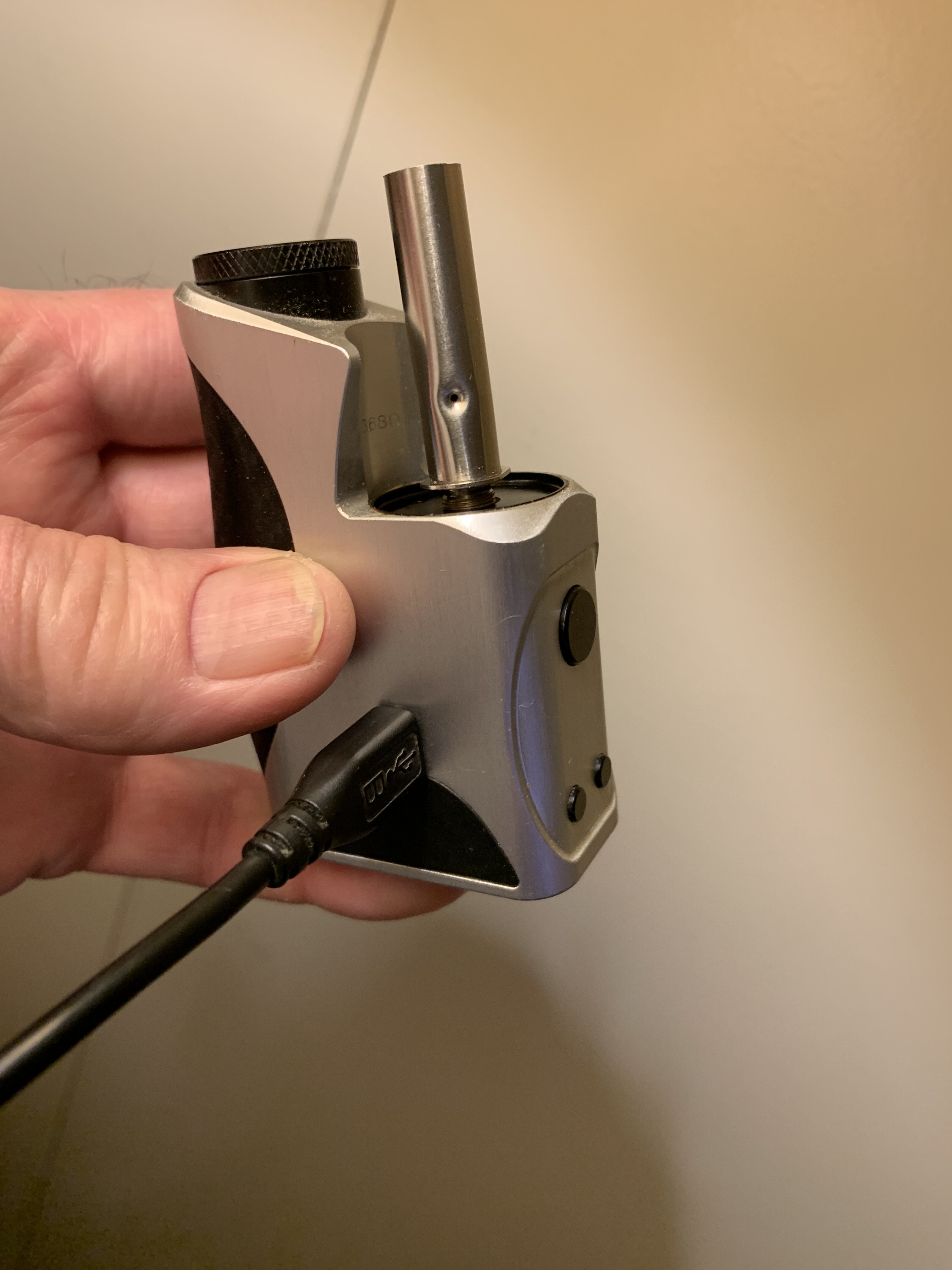

  3. I would check the cable first checking to see if it will charge another device at 2A or try some other cables. Is your theme able to show charging rate? Would you think that the heat of the XT60 is coming from the plug or traveling up the wires from the board to it? My guess here is a bad connection between the male and female usb plug do to looseness or dirty.

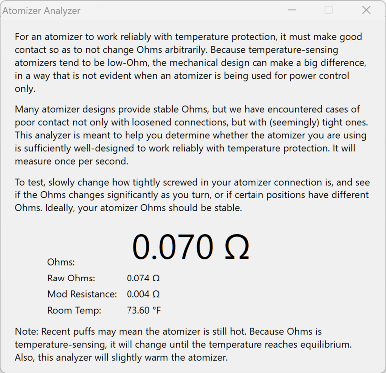

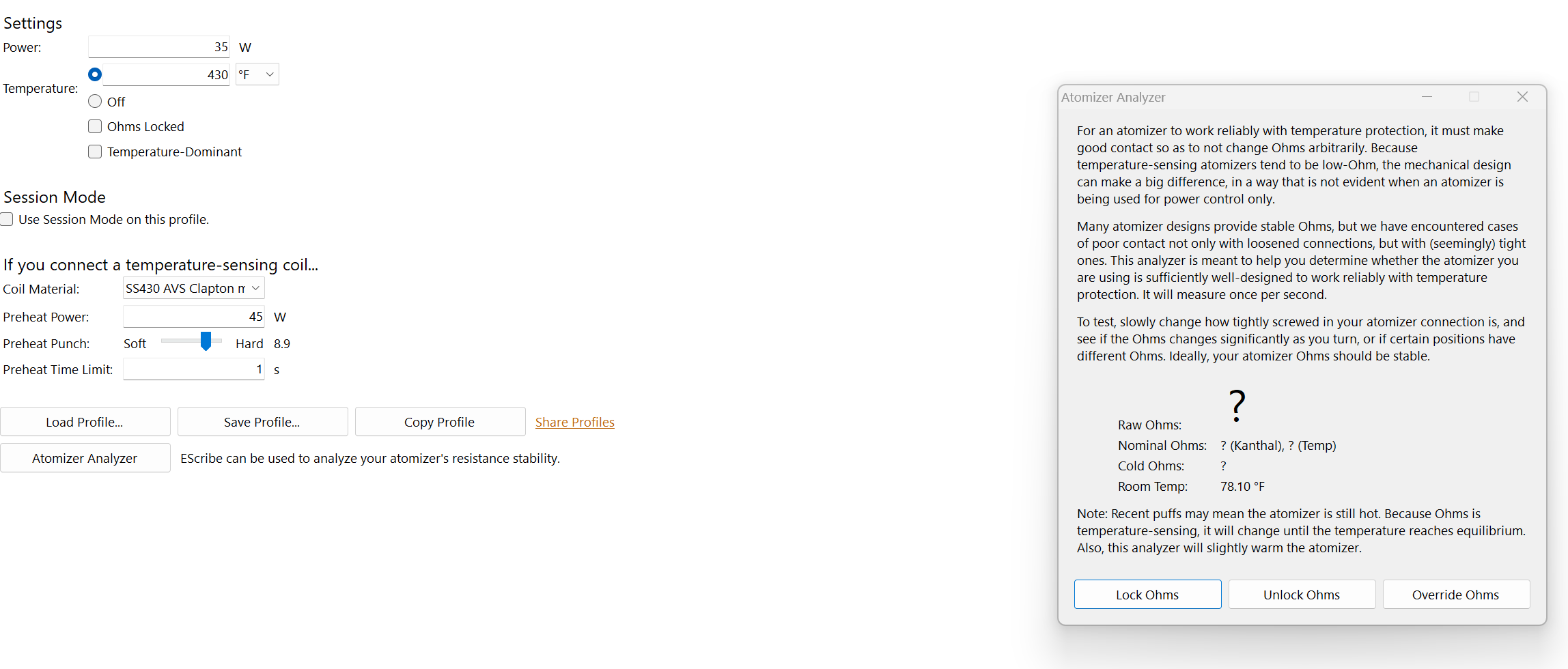

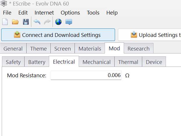

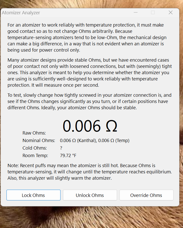

  15. I'm going to make another attempt to show how to set mod resistance. This can not be done on all DNA boards. Not with the 75C, 100C and 200 boards. It use to be able to be done with 200's but a firmware update stopped that long ago. Start by cleaning mod's 510 and the plug with alcohol. Using EScribe set mod resistance to Zero. Start Atomizer Analizer with mod connected and screw the shorting plug into the mod's 510. Put the value from Atomizer Analizer into the Mod Resistance box and upload settings

  18. Be aware that the zero in the box is not the mod resistance, this is just what it is set to. Put your value in the box and upload to device.

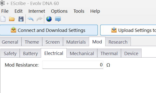

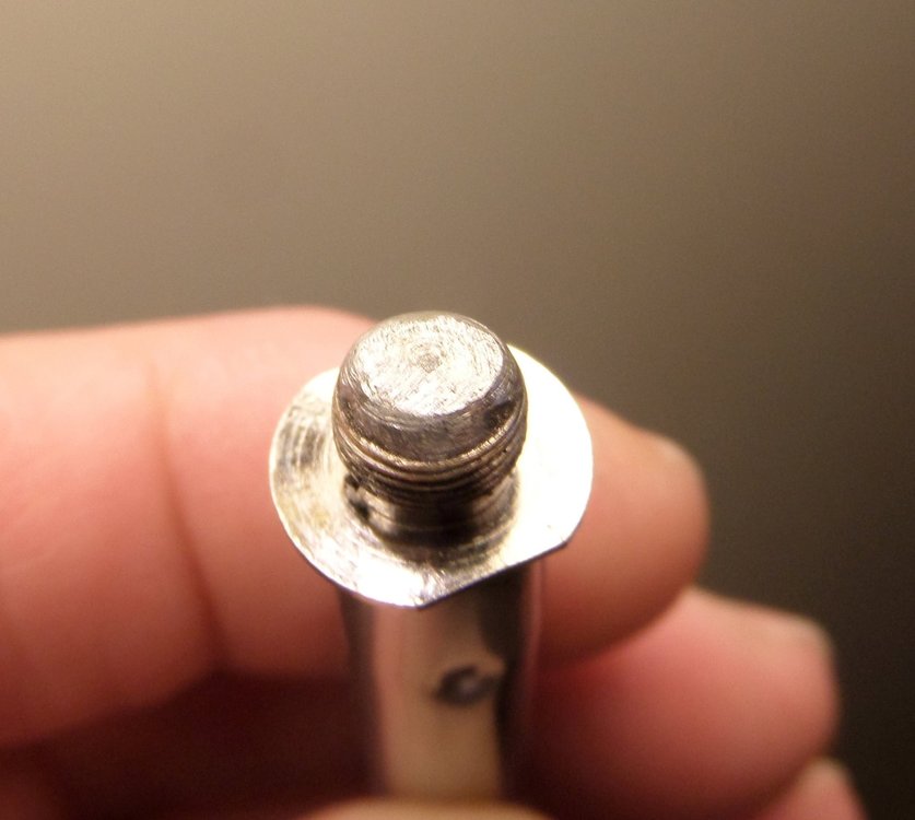

  19. I'm inclined to think that the mods with the lower resistance is closer to correct. I can't remember a DNA60 reading less, only higher. For sure zero is not the correct setting, usually 0.004 or higher. To check the mod resistance use atomizer analizer with a shorting 510 plug with mod resistance set to zero. Screw the shorting plug into the mods 510 and put the resulting figure into the mod resistance (electrical tab) and upload to device. I use a cartomizer that I soldered over it's 510 connection, it works great. This could be done also with a 510 to 510 adapter or an old atty with brass base/510.
  20. This is an old video using an old version of EScribe but explains it well.

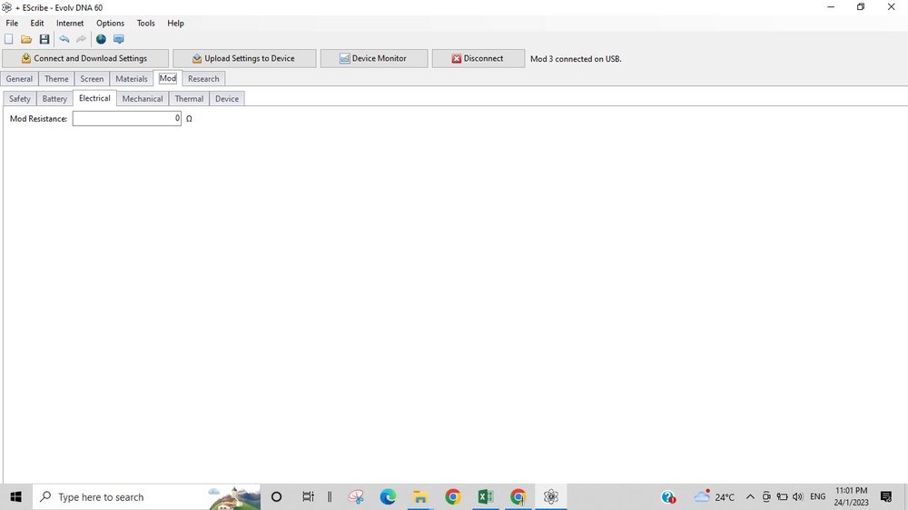

  21. On this one the mod resistance is set to "zero", are all 5 mods set to zero?

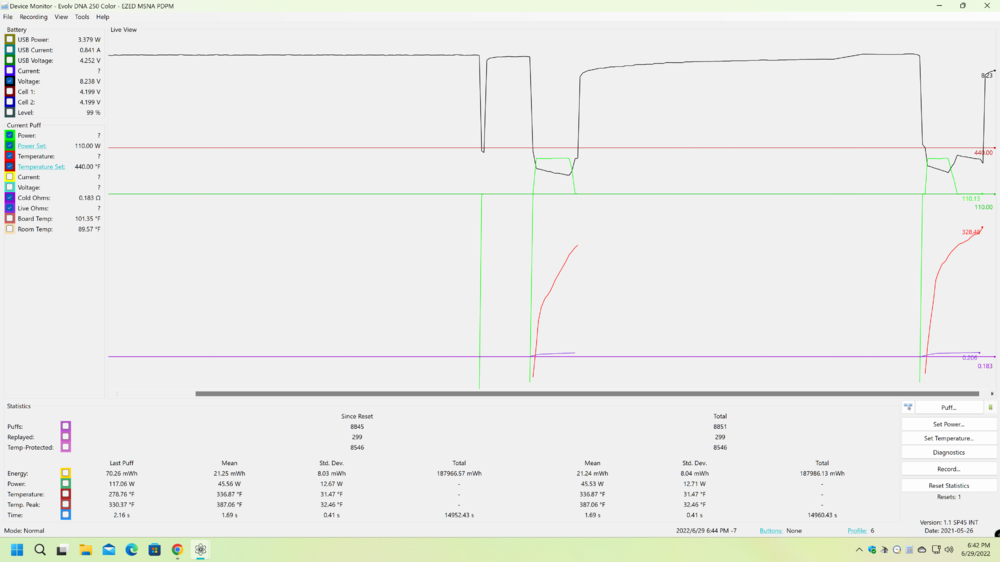

  23. With default settings red means charging and green is charging finished. Using EScribe's Device Monitor check the voltage on each cell and post it back here. Or better yet post a screen shot of Device Monitor like this one.
