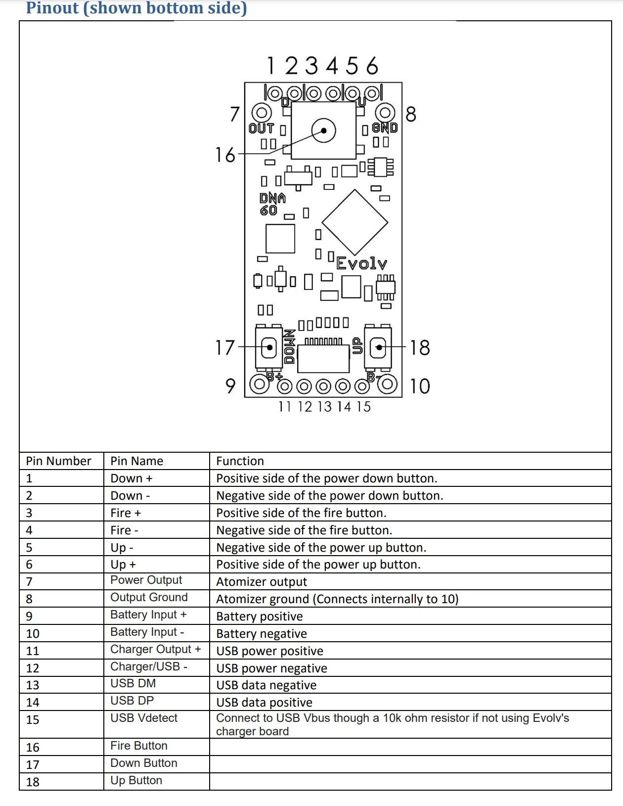

I'm thinking that you already have this but here is the pinout for DNA60. Double check that 13 and 14 aren't reversed. -

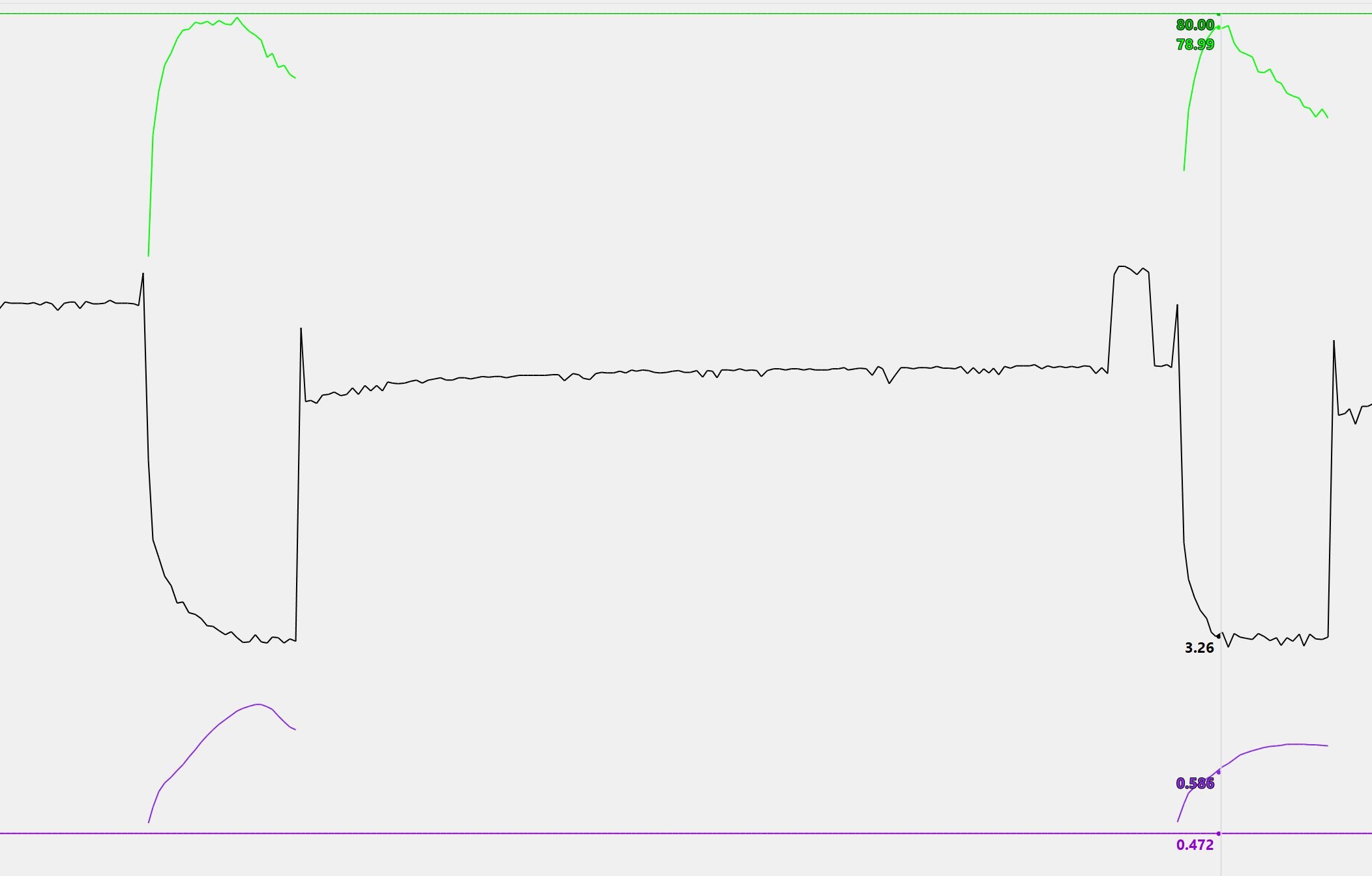

I would say there may be some resistance in the path of the power from the cell to the board. I say that because you said that you tried higher current cells. You have to have the power availible.
The voltage dropped to 3.1 but it still didn't hit the software cutoff
Here's my 80 back to normal. This is just an example of voltage drop where the device has resonably good connection between battery and board. This mod uses a chassis ground for all grounds. That's 4.13 volts on the cell to start, fires to 45 watts and drops to 35 watts. For comparision here is a DNA60C with LiPo, note only slightly better voltage drop.
There's a whole lot of folks don't get it about amp draw from the battery vs amp output from the board
Better results for sure. The data sheet for the 80 says 30 amp output and max 9 volts. snippets came from here: https://www.the12volt.com/ohm/ohms-law-calculators.asp Voltage to the atomizer, not voltage from the battery.
