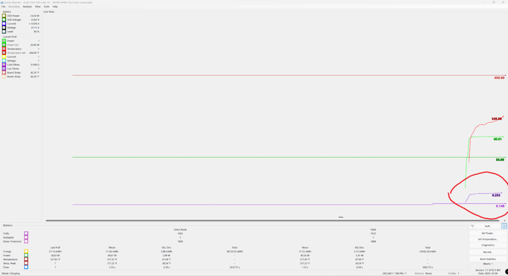

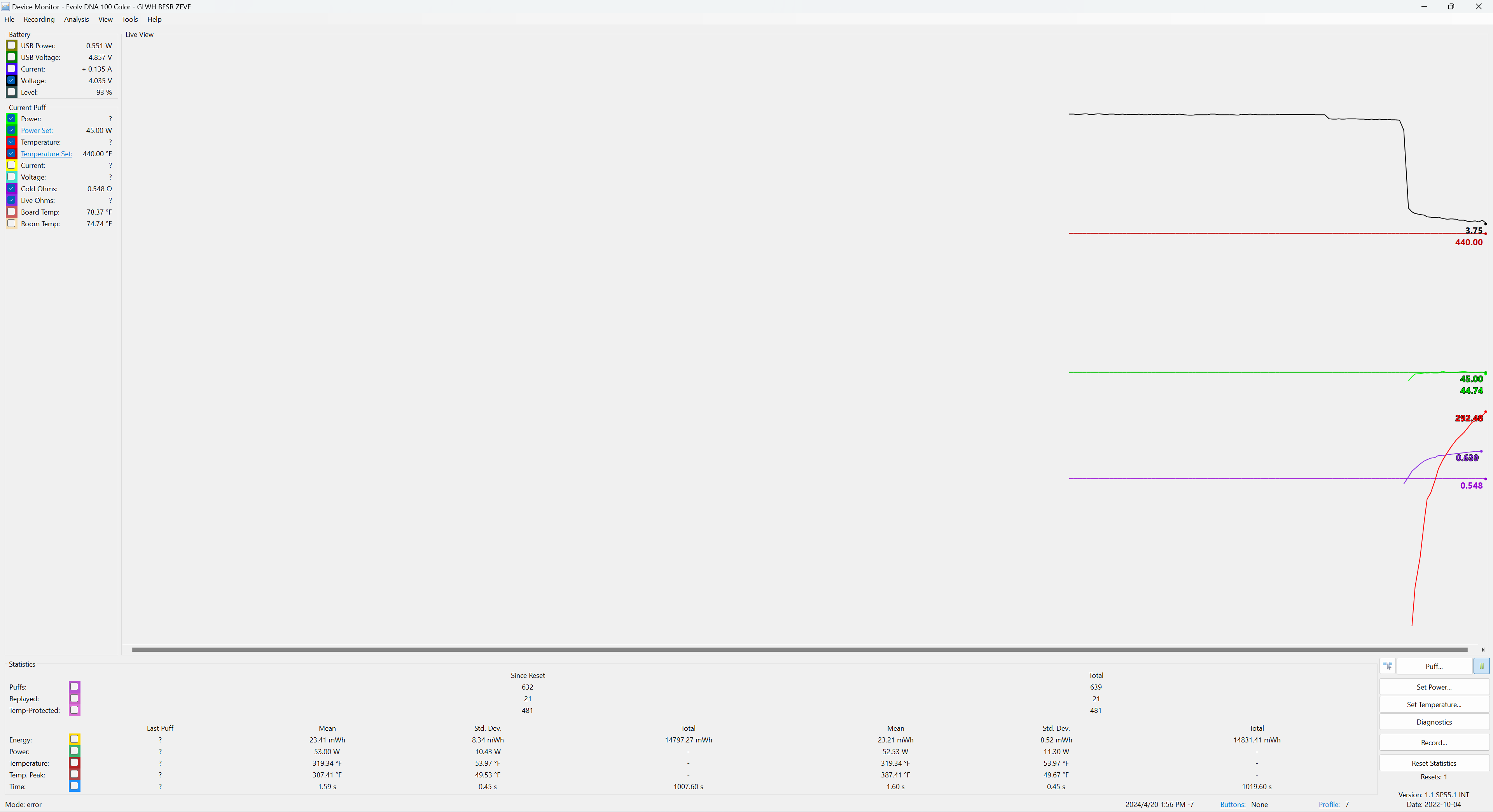

Yes I truely missed that the live ohms were lower than the cold ohms. I'm glad Wayneo caught it.

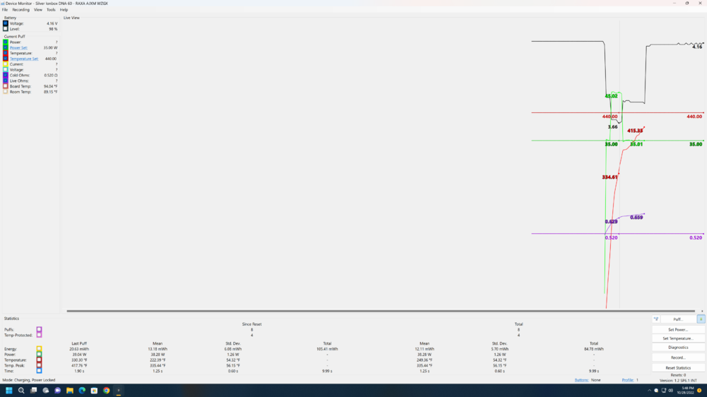

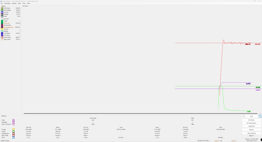

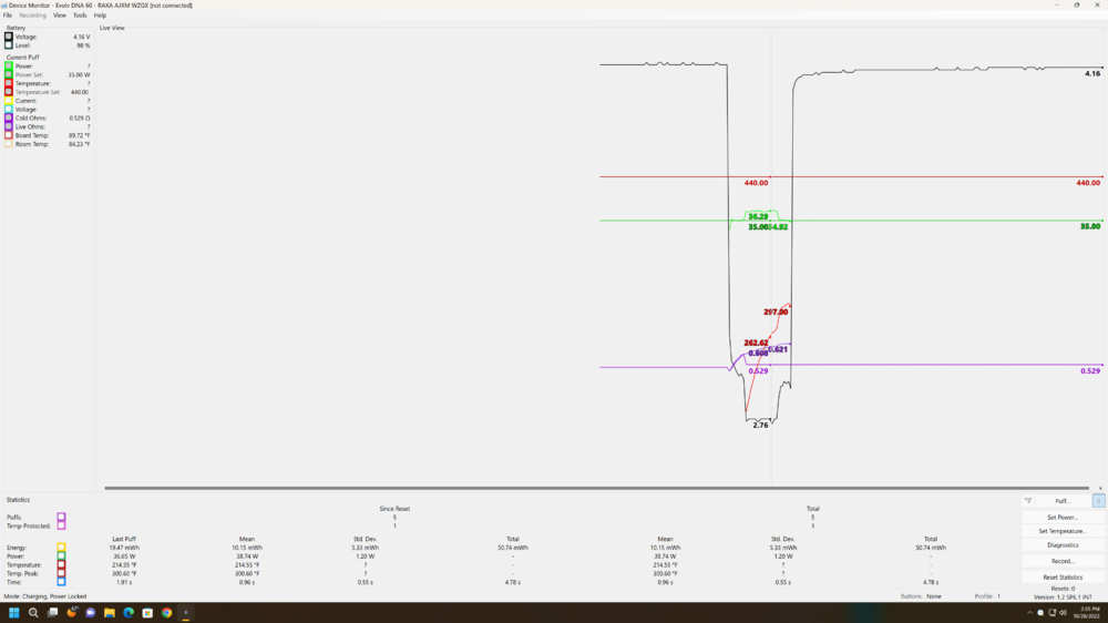

1st picture looks as expected, 2nd picture I have no idea what is causing that. If you purchased it locally you might try contacting them otherwise open a ticket with Evolv or StealthVape

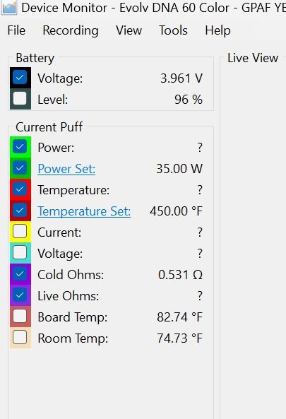

When using EScribe's Device Monitor does your cold ohms vs live ohms appear as expected? Could you post a screen firing in wattage mode?

Atomizer Analizer would read as shown in your video if the coil was warm, just shouldn't be that much of a change with SS316.
Your resistance change from cold to hot is way too much. Here are some things to be checking. Make sure the positive post on the bottom of the RBA is screwed in tightly. Is the positive on the RBA securely contacting the mods positive output, there have been cases where they barely contact because the legs of the boro box limits it. It your hybrid drip tip tight enough and does the chimney of the RBA stick out at least a little on the top of the boro box.

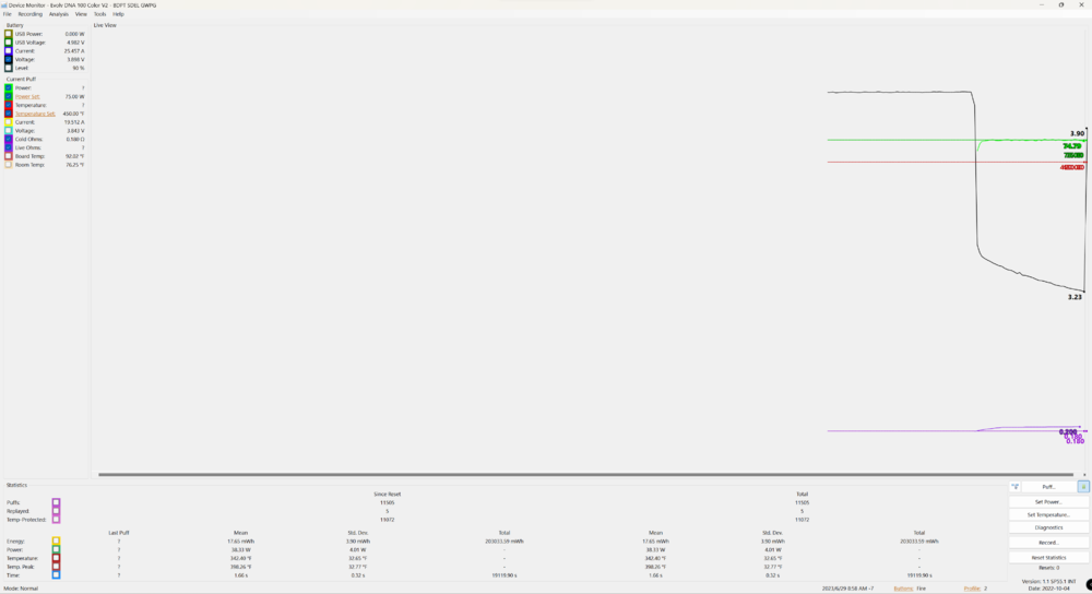

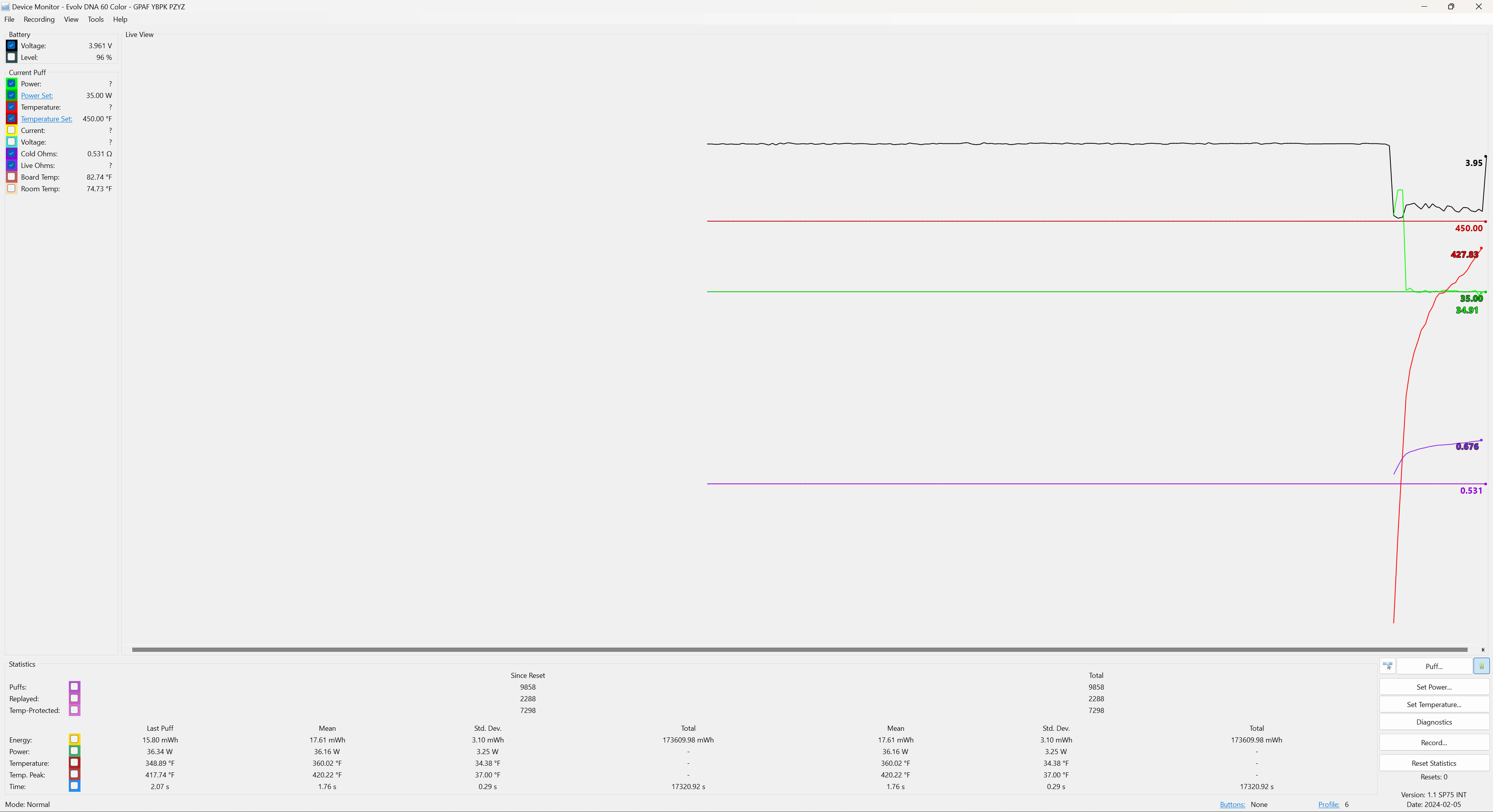

Can you post a screen shot of your device firing like this? Are you using temperature control? Check boxes indicated. -
Your last screen shot shows it throttling down from 34 watts to 29.38 watts. With the cell that you are using and firing at 34 watts that looks like there is still a problem. You seem to be on the right track to solving it. Is your adjustment screw on the battery cap at the end of it's adjustment? Meaning do you feel it may need to be holding to battery tighter?
" I noticed it kept climbing in charge when not using it to the point of gaining almost 10% charge within minutes, then taking a couple puffs, it quickly drops back to what it should be." Pretty normal behavior especially when charge is on low side. It is better to note actual standing voltage than to use the estimated percentage as it is just that (estimated). Here is a CSV for battery curve from my DNA250C, save yours first then give at a try if you want. It may be the same as yours or maybe different. Battery curve only changes percentages and battery bar, doesn't change how the mod works. DNA100C battery curve.csv
For what ever reason the board isn't receiving enough power from the cell (amps) do to a bad connection, could be cell fitment, bad solder joint, ect Use EScribe's Device Monitor to see your voltage drop while firing. Here is one of mine that has a poor battery to board connection. The voltage drops to 3.37 volts when fired at 45 watts. If it drops to soft cell cutoff of 2.75 volts it will throttle down the wattage. Check yours with Device Monitor.

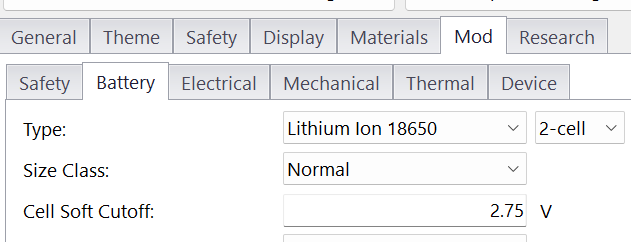

The correct setting would be 18650 and cell soft cut off at 2.75 volts (default)

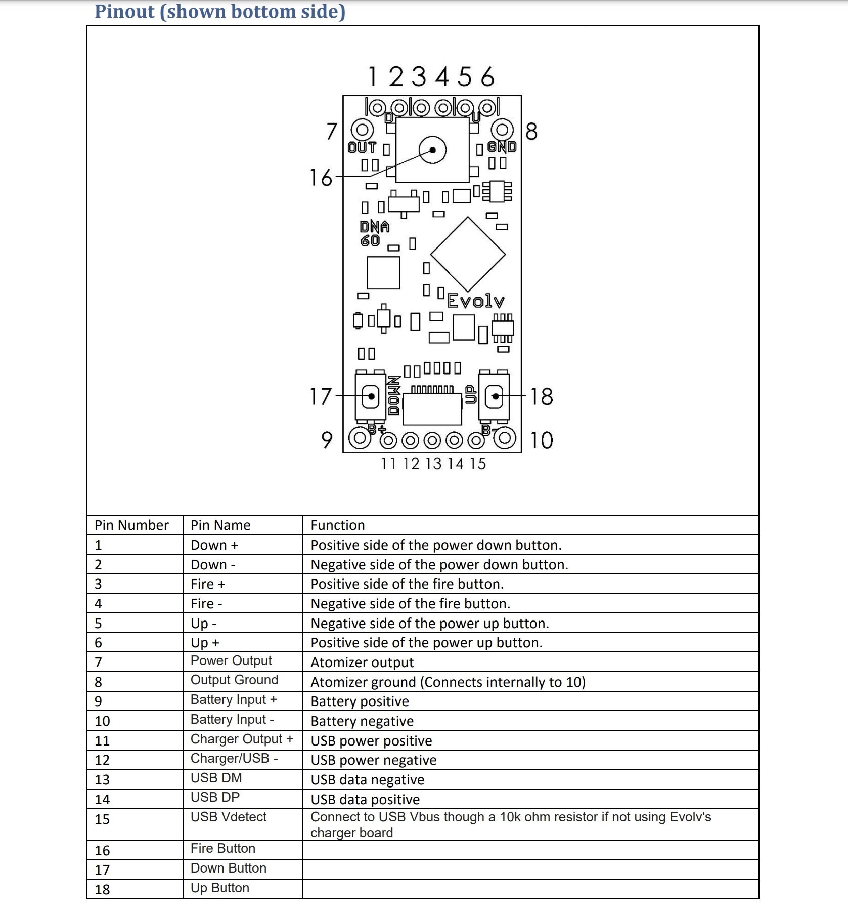

Dna60 Burnt pcb contact
dwcraig1 replied to king aries's topic in Connectors, Components, and Accessories
https://www.stealthvape.co.uk/product/evolv-dna60-usb-board/ or https://www.protovapor.com/product/evolv-1a-micro-usb-datacharging-board/ I would think that there are more places.
