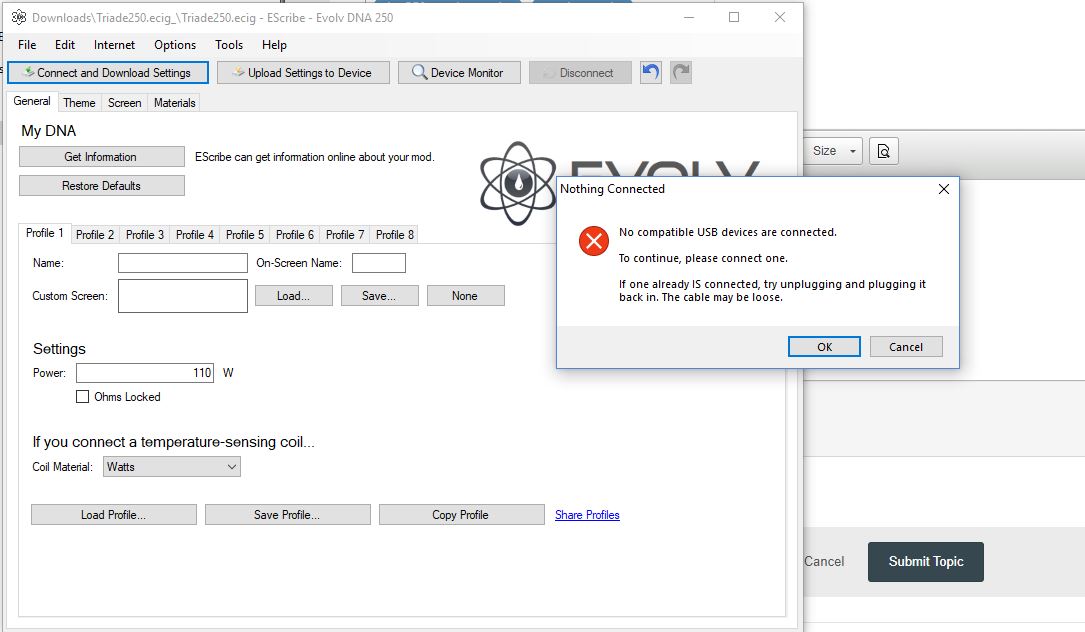

  1. YA MAN... I FOUND ANOTHER CABLE IN MY OFFICE AND TRIED.... AND IT WORKS... MEANING THE PREVIOUS THREE CABLES ARE CHARGING CABLES AND NOT ABLE TO DETECT... SO MAKE SURE ITS THE RIGHT ONES... THANKS EVERYONE
  2. Tried 3 types of different cables ... still cannot connect to my acer predator win10 laptop... have not tried other computer yet...
  3. HI GUYS, MY triade dna 250 cant seem to connect to my windows 10... cable plugged n unplugged with a 2 cables , still the same... even reset my triade with battery removed... still the same... tried on escibe version n new as well... weird things is the cable both can charge the triade battery... but cannot connect to escribe software... pls help...... thanks
