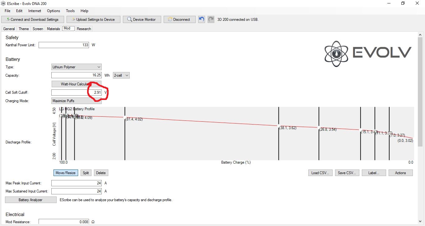

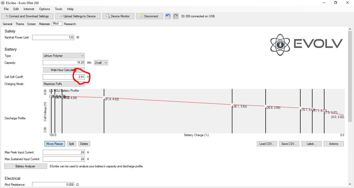

  19. Interesting: note on my snip my cell soft cutoff is 2.91. I was setting it to 2.85 and upon upload it would change to 2.91. I now set it to 2.8 and it stayed at 2.8. I hope the OP got it sorted

  21. 29 watt hours will put you pretty close. 2.9 volt cell soft cutoff
