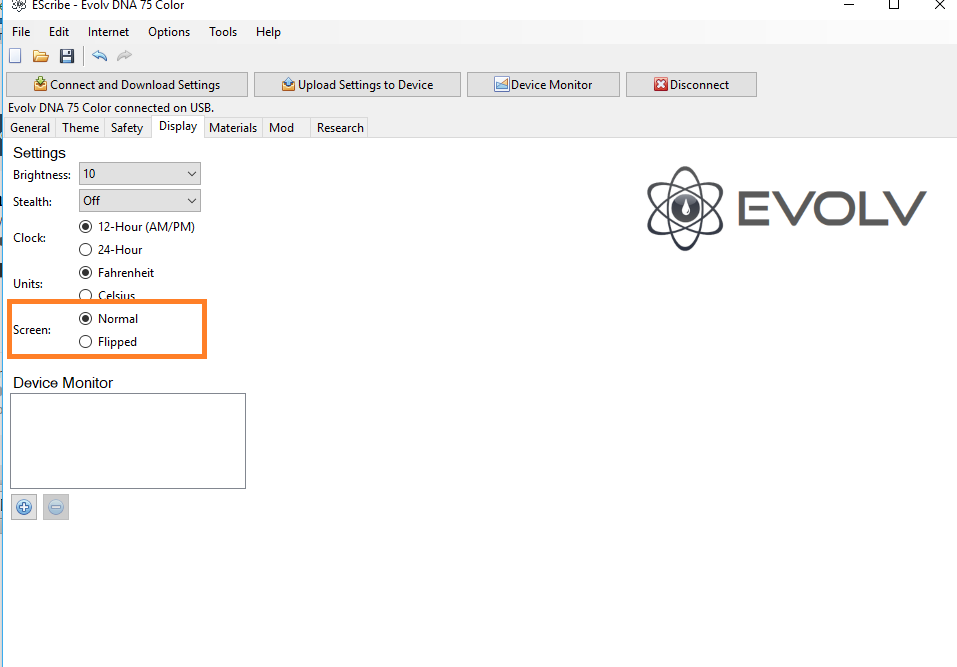

Evolv's default theme? I am able to replicate this with my custom theme also.... Will pass this on to James.... I've never heard of this before now ....thx.. Edit: this occurs also on the DNA200 and 75.... don't have a 250 or 60 so I don't know about the 250 or 60.
What theme is this you are using?
