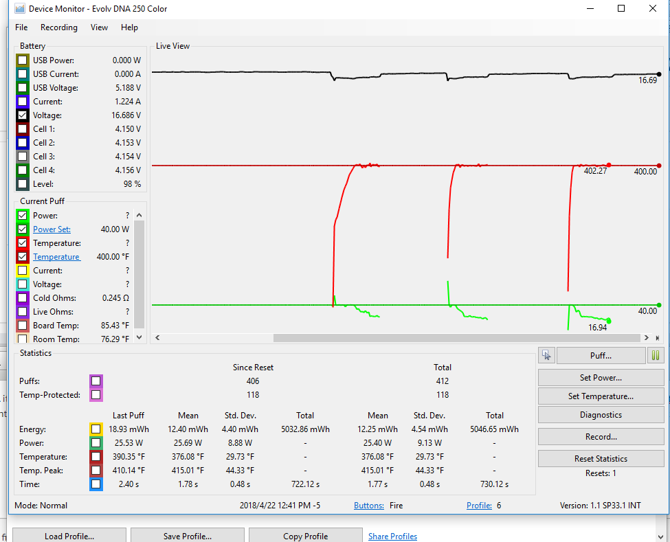

BadNews.... it looks like you need to turn up the power (watts), say to 45 or 50..... preheat should be OK at 375F.... From the screenshot after the preheat reaches 375F it shuts down and the power wattage continues. Your reaching 35 watts of power and the temp is only raising slowly toward your set temp.... raising the wattage to 40/45/or 50 should allow it to reach the set temp of 450F. Here is a screenshot showing my vape setting the power and preheat to the right settings to get a quick rise during preheat and achieving the set temp quickly..... Keep working at the settings and you will get there... -
