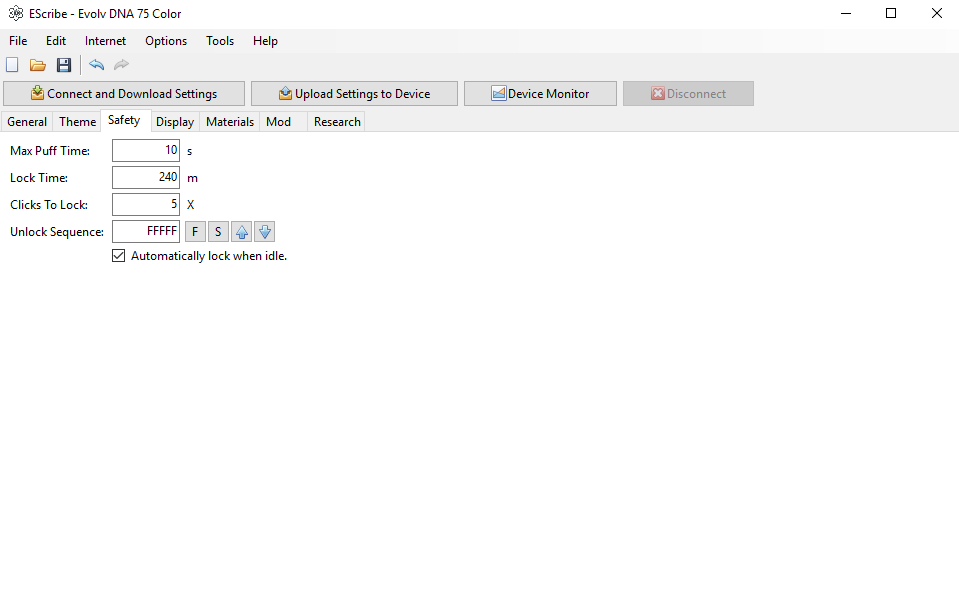

fire button and display sleep,paranormal DNA 75c
retird replied to sameh's topic in DNA 75 Color and 100 Color
Check the lock time in EScribe...... click on the Safety Tab......You can adjust the autolock time there....after changing setting you need to upload them to the device... -
