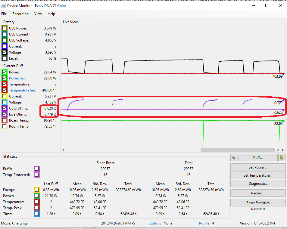

Some Kanthal pre-made coils work in Replay.... I think it is because of the design and resistance rise as a result of the way the coil attaches to the housing.. Here is a screenshot of a Kanthal premade coil showing the cold ohms and live ohms rise......and the power decreases with repeat vape because the coil is already heated....
