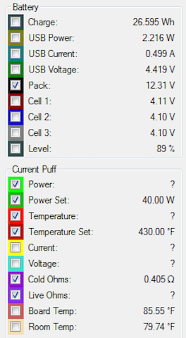

Thanks for that. It's showing every cell is completely dead. 0.00V. Hopefully a new battery would fix that from seeing such low puffs, but even so with my old barely used Lipo's, there was usually a glimmer of a volt in at least 1 cell. I haven't seen a 'some nonsense' error, but the actual wording or screenshot could indicate bigger issues.
Sounds like a LiPO battery. There is now escribe v2 with a native Mac version available. Can you post a full Printscreen (Command Shift 3) of Device Monitor with cells 1-3 ticked
