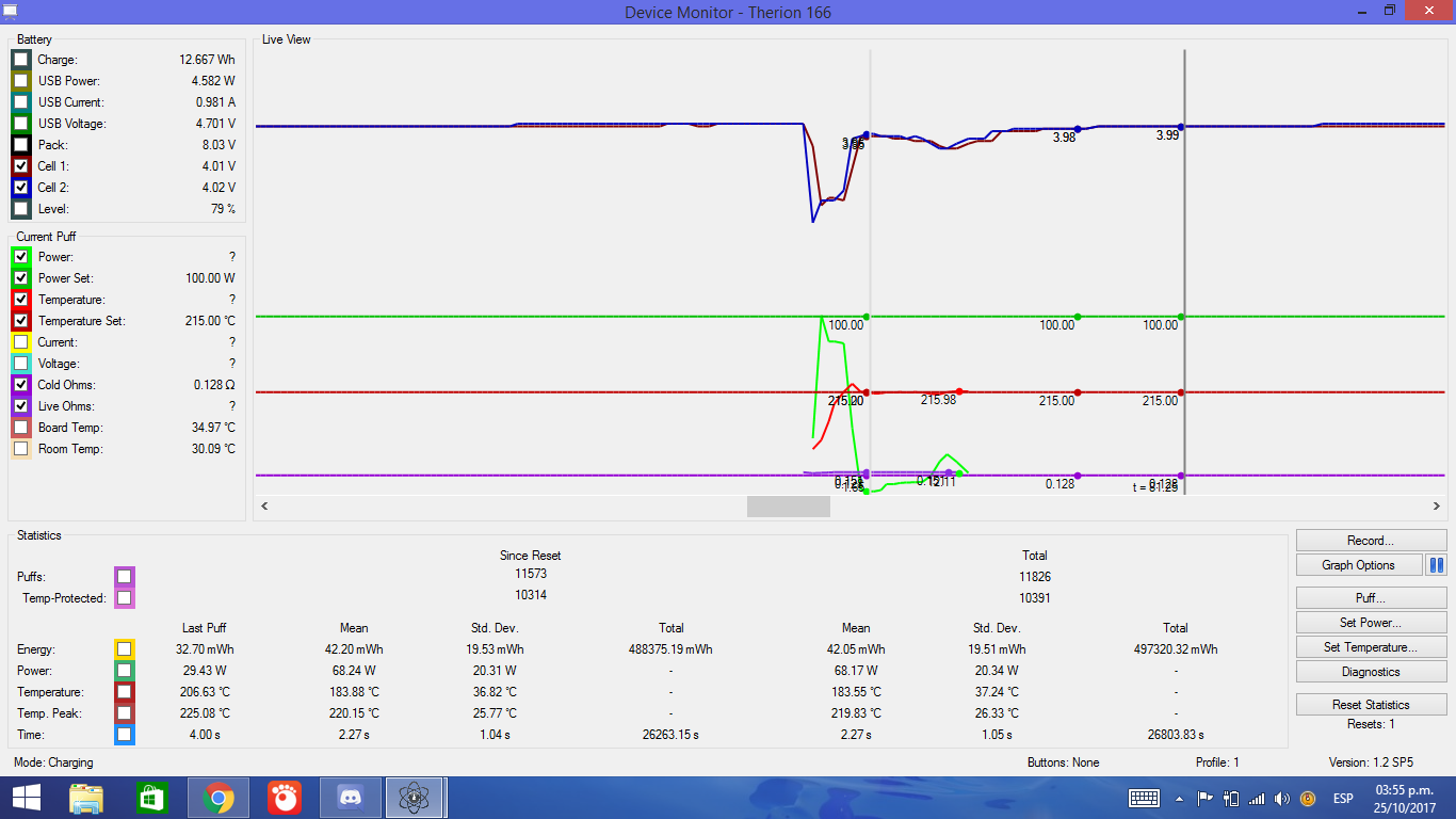

  1. Ive always keep the 510 clean, and the problem continued. Yesterday i rewiked it and noticed a really small hot spots, i think that in fancy coils its hard to work out hot spot or even visualize them, so i spaced a little bit and it has been working great! Ive the give the reason to Wayneo. From now one i will keep all my coils for tc a little spaced Thanks you both!
  2. I have already checked if there is any hot spot, just now im wicking it again and no hot spots, will try if the pulsing is still there and report. In the other atty its also contact coil and no problems but if the problem is persist in the kylin i will try. Thx

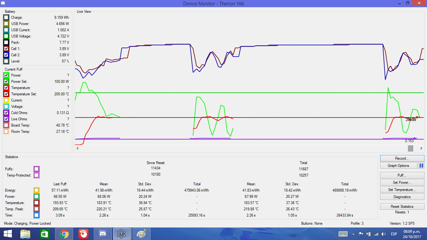

  3. Hi wayneo. Its a dual 3.5 ID 6 wraps dual coil of stagger fused (26ga+32ga)*2+32ga made from a spool of geekvape. On atomizer analyzer it show 0.135 ohms steady with no variations and in device monitor the cold resistance its 0.128 im using a profile made from wire wizard with all the characteristics as said In the graph the numbers are overlaped but the lowest point of power i think its 1.65W By the way i have a ijoy rdta 5 made with the same wire, but not same id and wraps and the puff its steady I´ve tryed the djaqith v3.5 profile with the same results, first puff is steady the following ones are pulse Sry for potato english not my native lenguage thx for the help
  4. Hi, Im having a problem with the combo of therion 166 and kylin rta. Always the first pulse is constant but the one that follows i feel like the output of power is delivered as pulses. Any idea?
