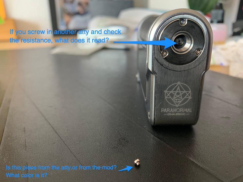

3 Torx screws and you get easy access to the entire 510 assembly. I think if you look/measure the length of threading on your atty's you might find one is longer than the others that could have started this issue.

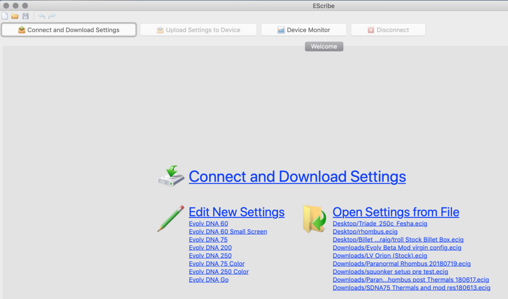

In escribe, go to Mod -> Atomizers and change the 'Max resistance' value to 0.4 for the old .25(DL) settings

Have you tried any other atty's on your mod, and do they work?

In escribe, Go to 'File' -> 'Save', and post file here.

Ok. So have you verified it's an authentic board? Once escribe has started, click the 'get information' button, it will open a web page. If you've gotten that far, back in escribe, click the 'Theme' button/tab. Are those in Chinese? If yes, save the 2 logo's if you want. Now you have a choice. You can either load the entire evolv defaults which is pretty quick (just click "default theme') OR, in Theme Designer, up at 'Options' 'Language' choose English, then 'upload setting to mod'. Let me know how that works out.
