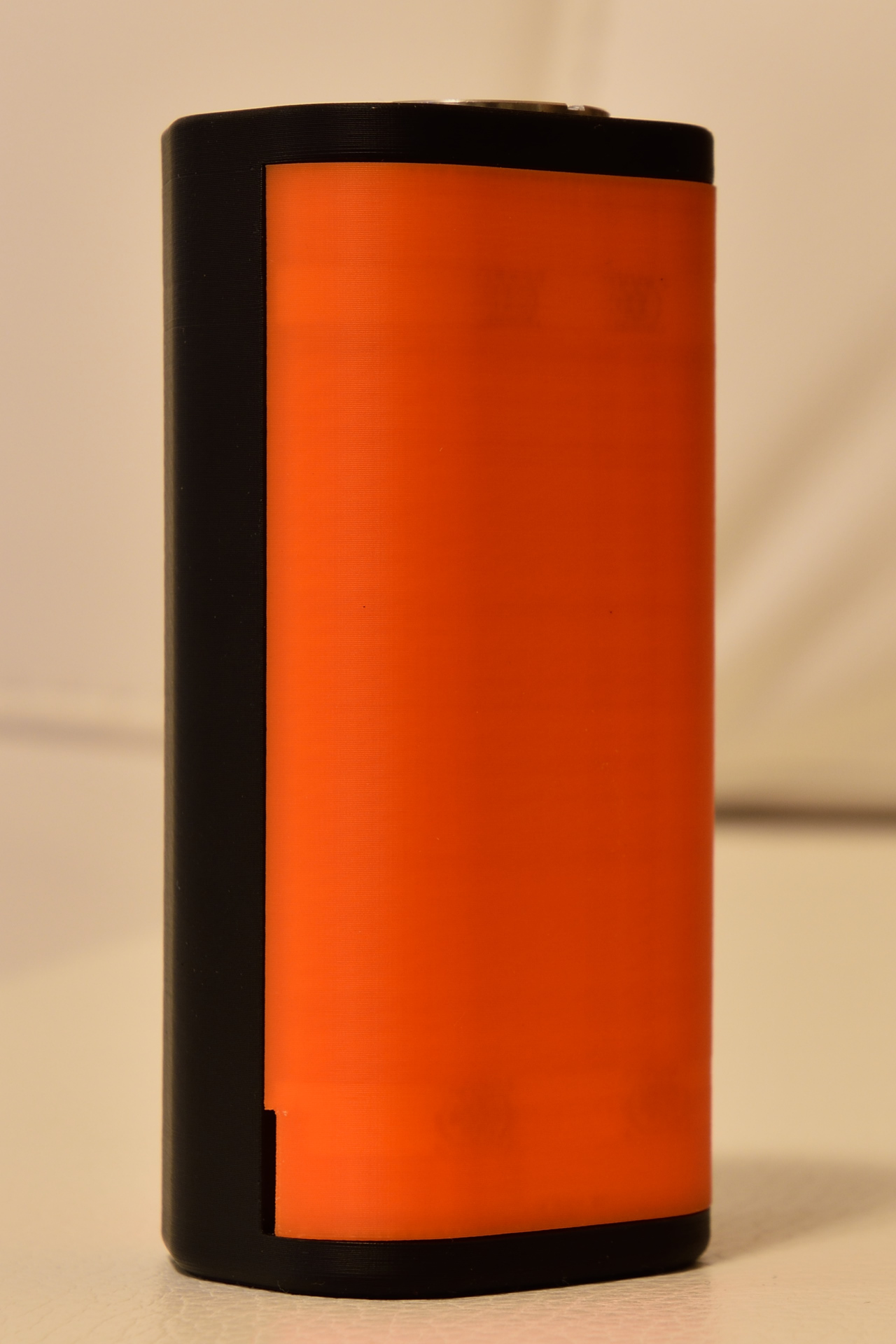

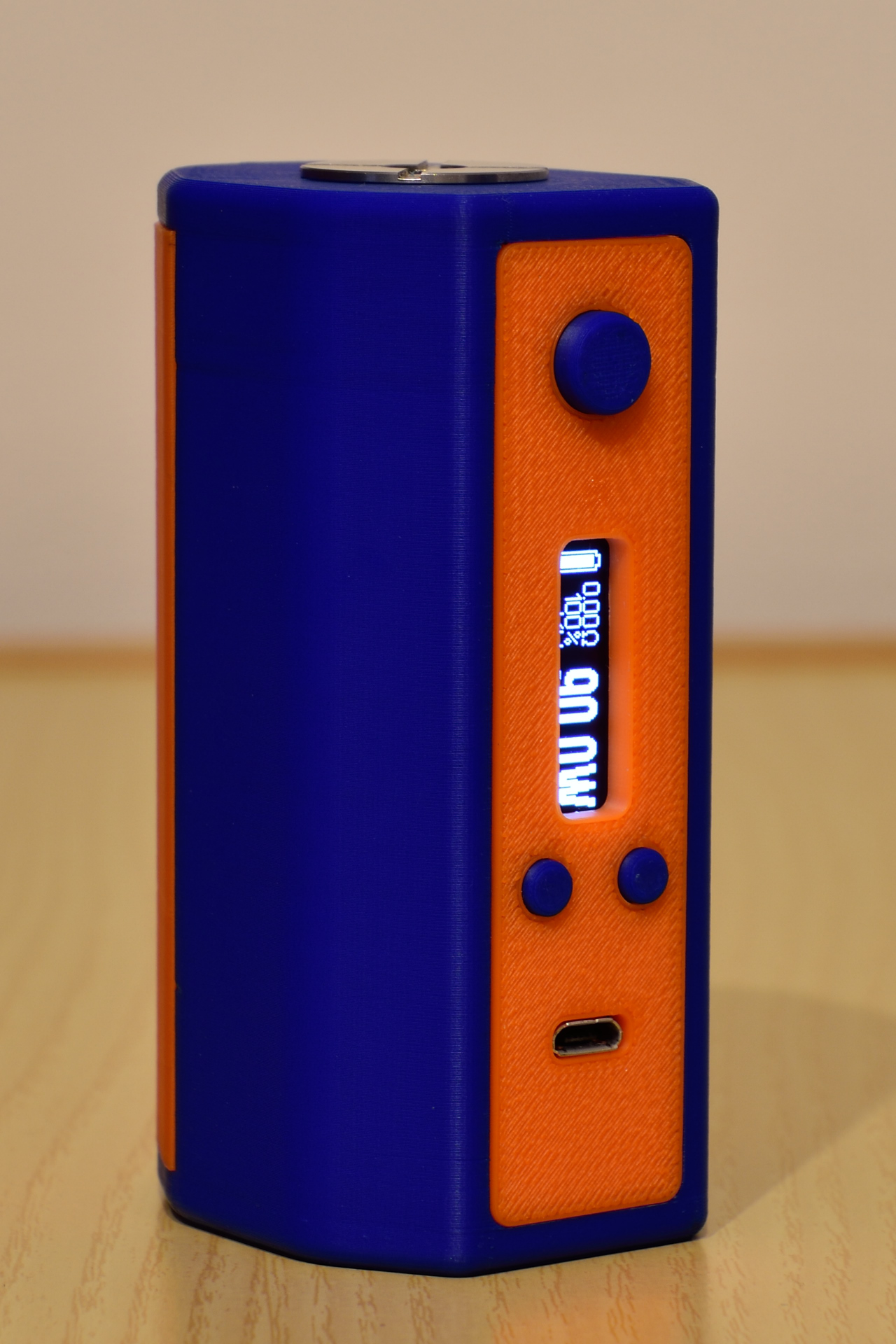

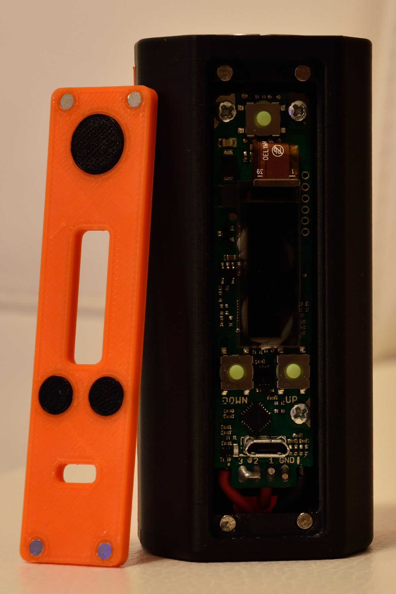

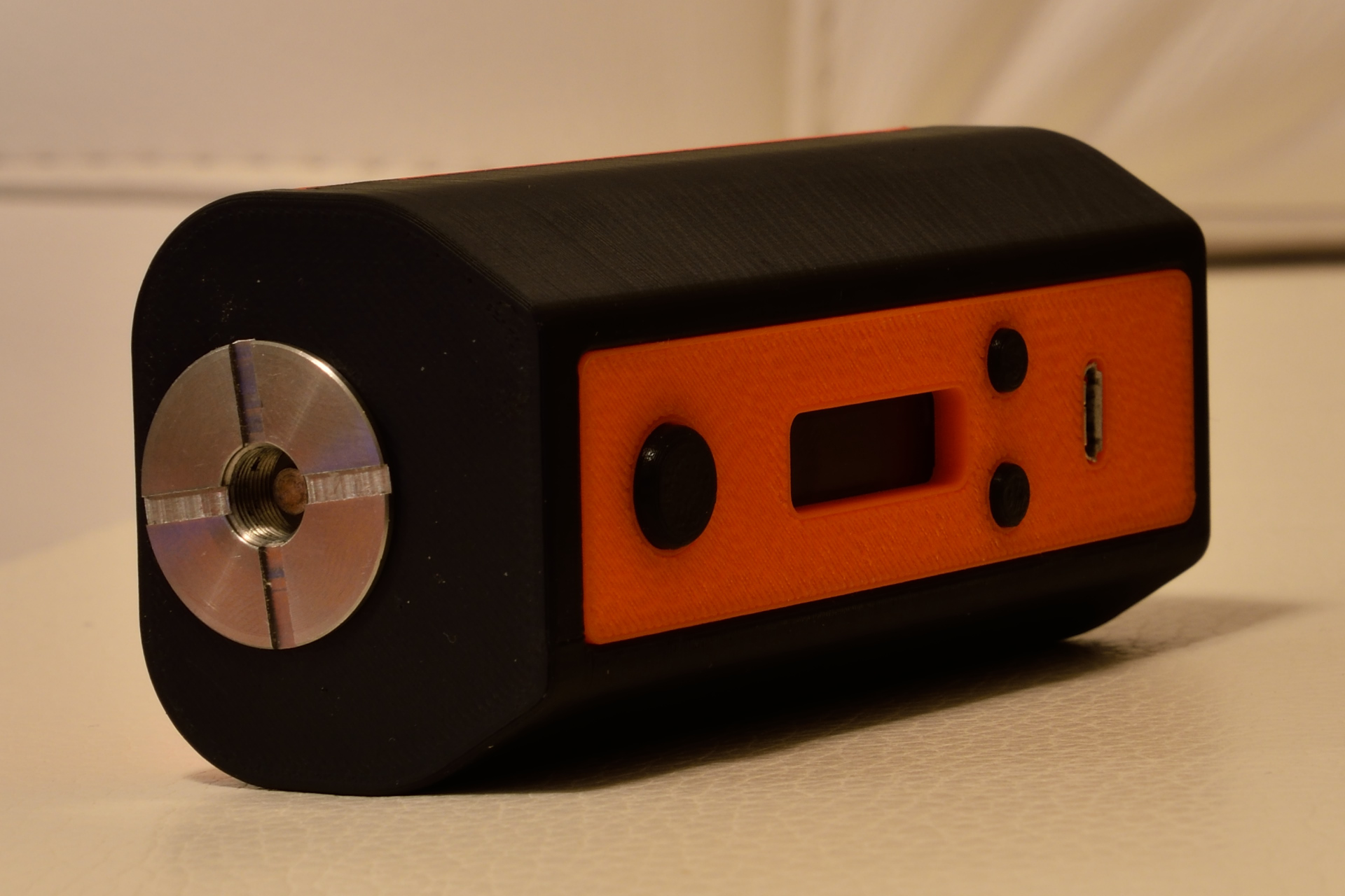

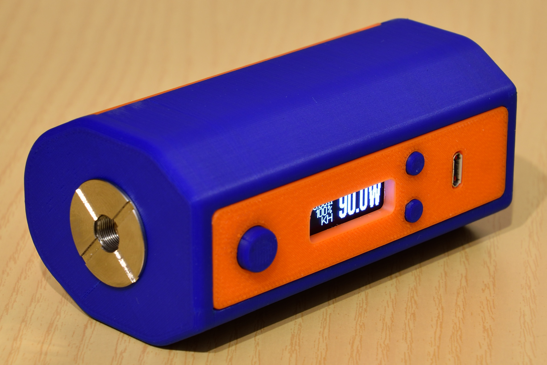

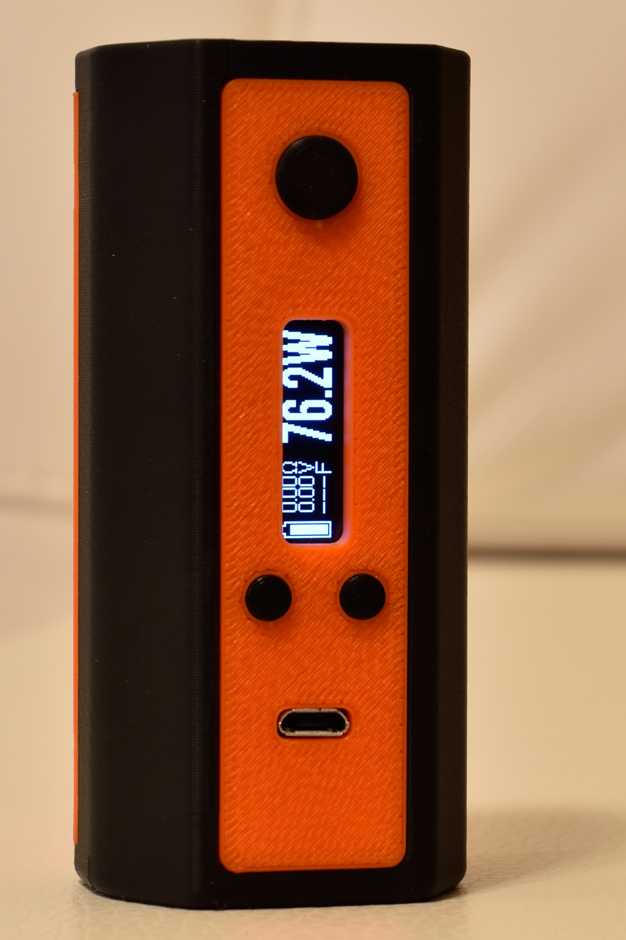

My last one.

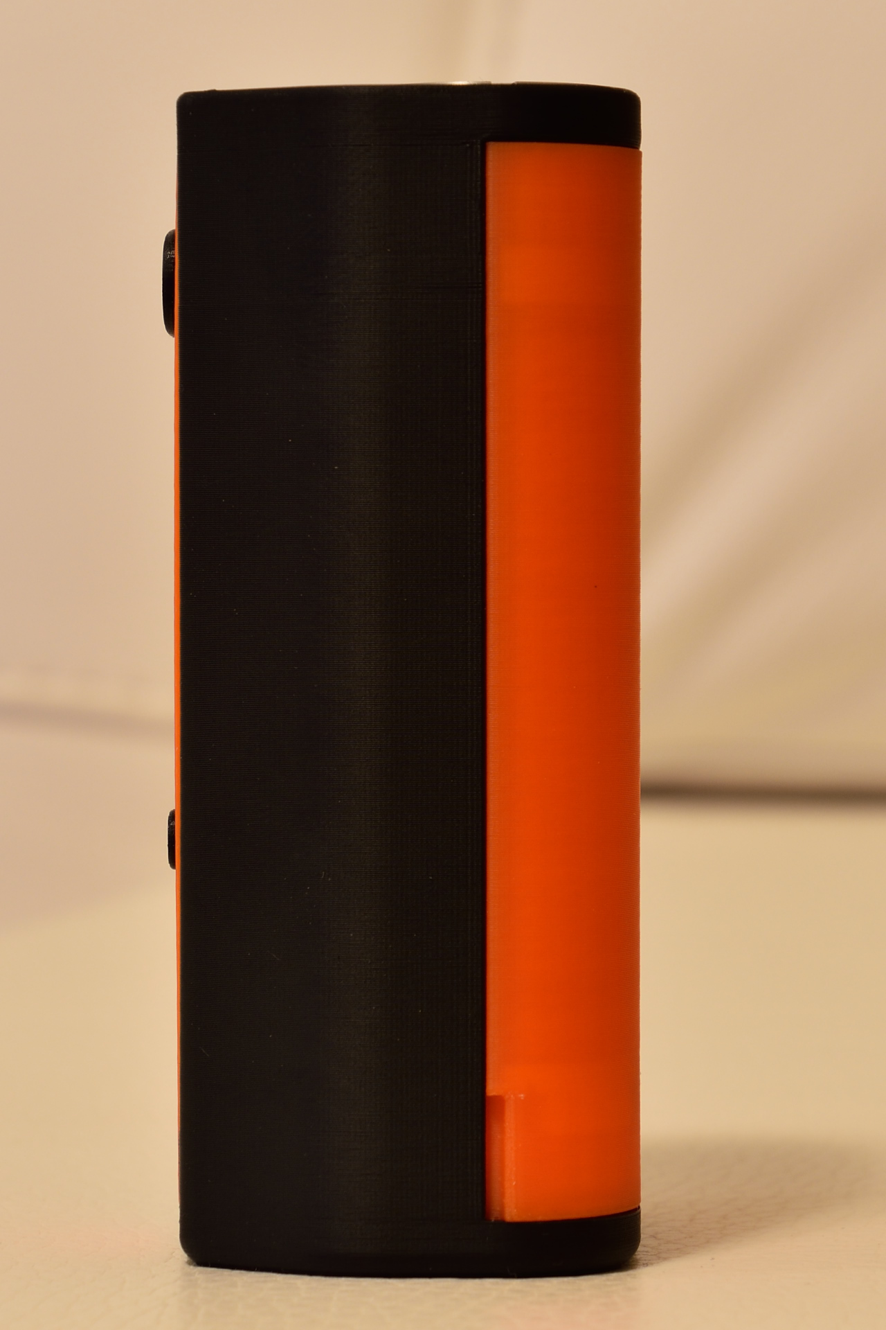

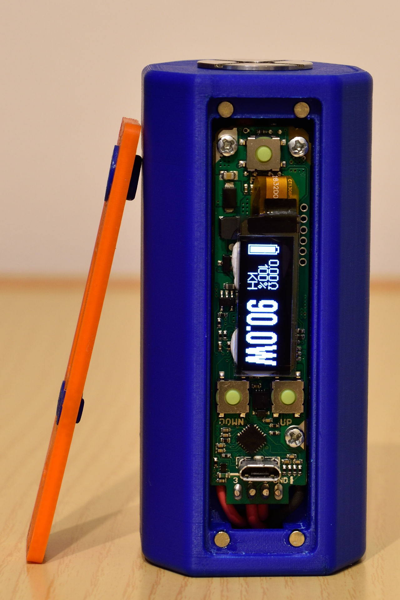

It mount a Nanotech 0.95 mah 3s 25-50C.
It's printed in ABS with a Z-M200.
Size are: 48x94x25.
Totale space for lipo is: 32x76x21.
Here mine project: http://www.thingiverse.com/thing:1530128
Here some shots:

that is sharp,seeing the screen in there with no holder gives me hope i can do something similar with my next squonk build.what is it thats between the board and screen?the white i see poking out is what im talking about.im waiting on my template so i can start drilling and cutting.i really dont like the box from FDV,its a lil wide but it will gimme plenty of room to work,thats for sure.67mm in width is maybe 10 - 15 mm to much.not a super comfy fit in the hand,for me anyways.may have to put velcro on the outside and wear a glove when vaping...lol.new fad.nahh not a micheal jackson fan. i do like the lil place for the bf feeding deal FDV came up with,it only works with his bottles though,so all my other 10ml bottles are a no go.also the door slides up and down so no magnets.but getting the 3/4 in opening cutout is gonna be super hard for a beginner like me.so idk if im gonna attempt to do that.since all the holes for firing,and up/down dont have to be super exact i think i can make it look pretty good just drilling the holes.still dont know if ima try to wire a diff fire button and not use the one on the board yet.IMG_20160430_100356.jpg although the other button placement does feel really nice up there.
Posted
I epoxi resin my screens to the inside of mod then bring the wiered up board to the box clamped to the bench and then connect it in place like that. I hold the board in place with stand off rails bought from stealthvape, i have nothing but the loop of exess screen ribbon between board and back of screen.. if you havnt allready, check stealthvape.co.uk for small parts, allso modmaker.co.uk, both do overseas.. also wireing a seperate firing button may be adventagouse, because of the length of the screen ribbon looped over it will hit a pushrod button if you dont put a consiteener bend in it, a lot of people come unstuck and fracture the robbon, tightly folding it rathere than bending.
Posted
i havent done anything to this yet,the other build i did the loop with the ribbon and just made sure it wasnt in the way of the fire button.idk what it looks like now,i havent had the chip out since i got the build done.i did order a chip holder from mamu and the ss buttons for it also.lotsa options for buttons out there,specially homemade stuff ive seen folks do.some stuff really nice and some....functional to say the least.but hey whatever works for whoever is doing it is ok by me.consiteener  bend? ...idk what word thats supossed to be but spell check didnt work...lol.i was real leary of even touching the ribbon from all the nitemares i heard from the dna 40 boards.
Posted
Ok, urm swan neck..or "S" bend. when i was building 30s and 40s i realy mangeled screen ribbons up and never had any problems, its only been when building on the 200s and clearing that firing button it starts looking precariouse, still havent had an issue just cracked a glass to be different. Lol

Very Nice! Love how you used Magnets for the Battery door and Faceplate!!
Posted
Yes I like it very much. Where can I get one? Even just the box alone (I am not crazy about the color though)?

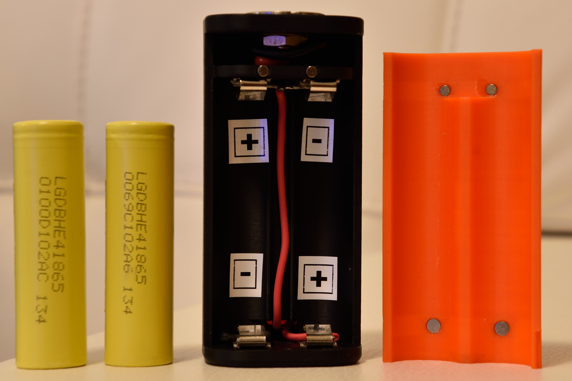

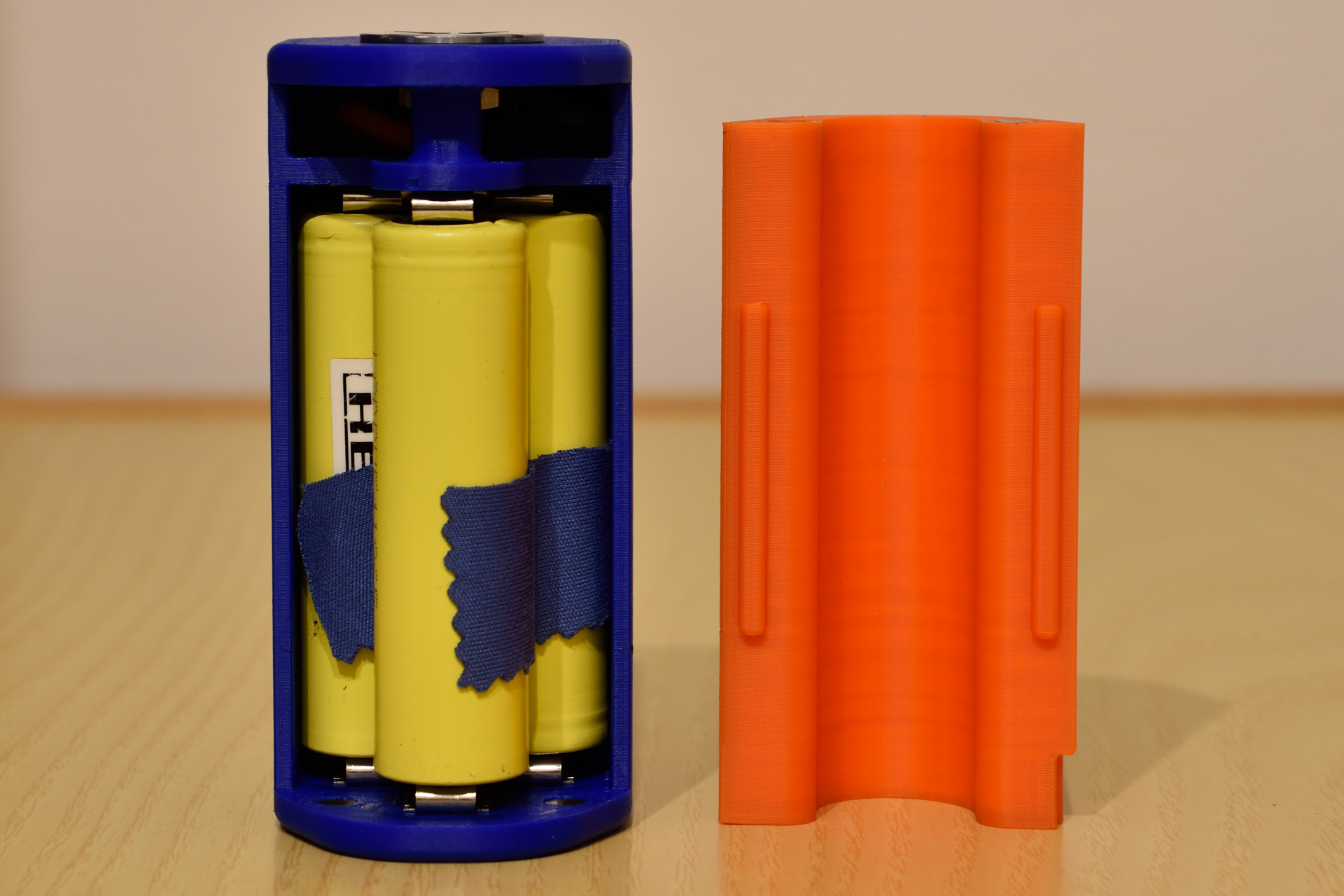

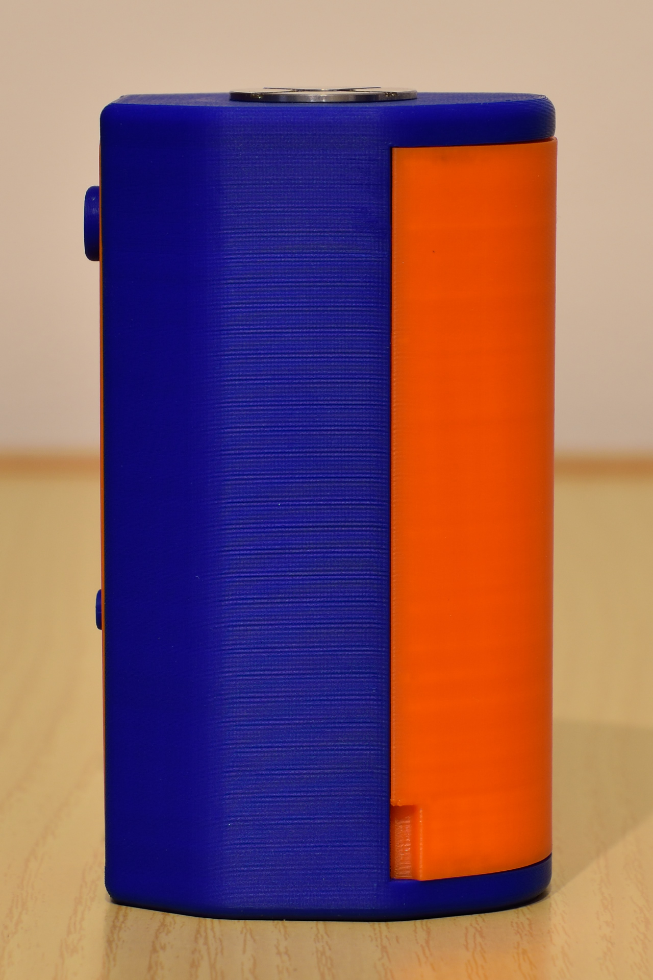

The last one (3x 18650), here mine project: http://www.thingiverse.com/thing:1556748
I used this wiring scheme: https://forum.evolvapor.com/topic/67414-topic/?do=findComment&comment=906611
It's a like a wismec clone (LOL).

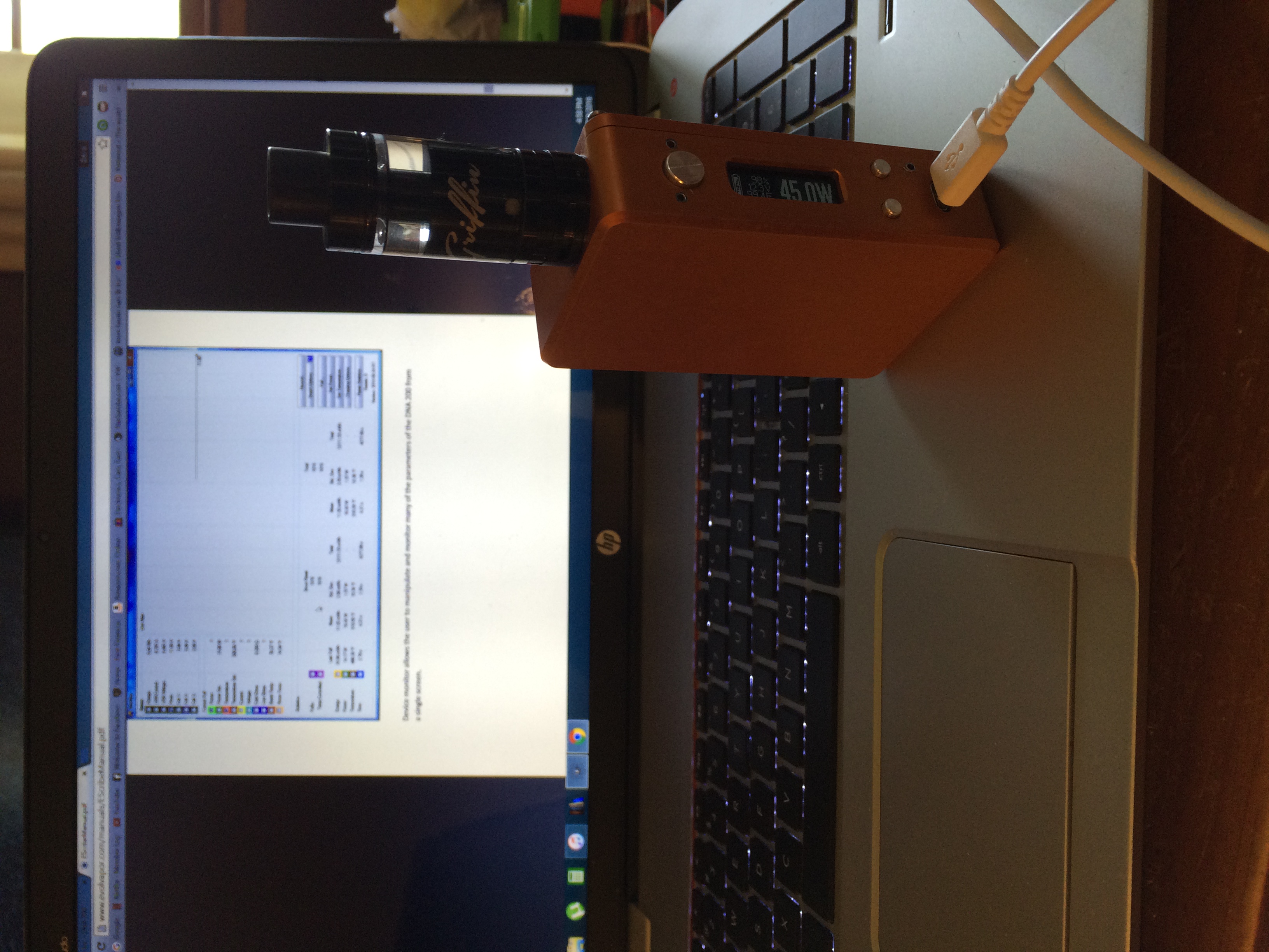

So I got two Dna200's this week. The blue one is a Modcrate 1550P+V2 kit that I built, set up as a 133w with two LG HG2's soldered in series and direct to the board for USB only charging. Red one is a Hana V200 which I have wanted since day 1 they released em and just was able to do it.
Posted
My very first DNA 200 and I love it! I'll never go back!
Orange Modcrate 1550p v2 box (love this box)
45c 1300 Glacier lipo
Fatdaddy's low profile copper 510
With a Zombie theme!
Using a Griffin tank single coil .38 ohm SS 316L at 40-45w. Still playing with settings trying to find my sweet spot. I replaced the board screws with headless screws and had to put 2 screws in the lid because the lipo fit so tight mags would not hold it shut.

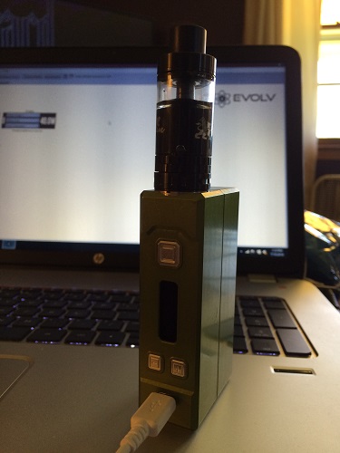

Just built my second DNA 200 in the last 2 days again with ModCrate parts. ModCrate green Silo 1300 box with ModCrate HCP 510, Glacier 1300 lipo. Hats off to ModCrate for there service, shipping and prices. This whole building a DNA box mod is addicting!
Posted
looks real good. on the silo 1300 where you able to keep the jst plug and xt connector? or did you have to hard wire the lipo to the board to get it to fit?
Posted
The Silo 1300 I had to hard wire it, not ideal but I couldn't find a way to mount and keep the connector it was a tight fit. I sized down the wire I don't know what gage it was but it was massive on the lipo so I mated 18g to the end to fit to the board not pretty but it is working. The orange 1550p+ everything fit fine with connectors but was tight I had to put screws in the lid to keep it closed. I used the same battery in both the Glacier 1300 specs 70x33x20 http://www.buddyrc.com/glacier-45c-1300mah-3s-11-1v-lipo-battery.html I will probably run this battery out in the Silo and find a more suitable size so I can go back to plug and play. I like that everything fit in the 1550p+ but I like the Silo 1300 because it's a little thinner so they both have +'s. Right now just trying to figure out why my battery's in both mods seem to lose charge while just setting? Still learning the DNA 200. I have only charged on computer and I think I read that even tho the mod reads 100% it really isn't because of the limitations of a computer charge. ?
