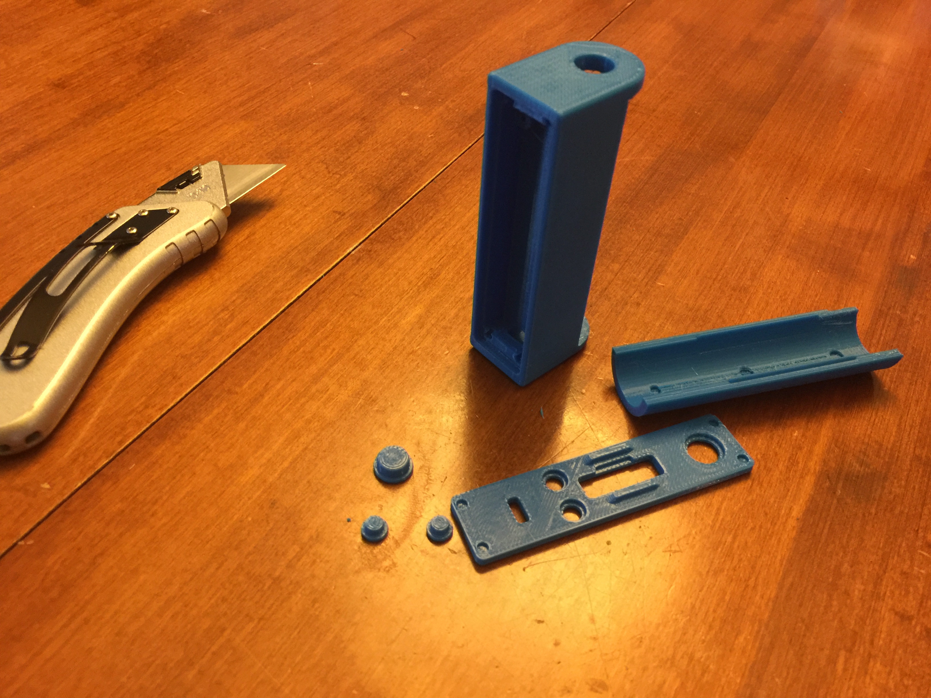

  1. So I got my first print of your DNA75 (the rounded, single battery, non-squonk version), very nice design. I'm excited to build this out, but I do have questions. How are the battery contacts attached? I thought that maybe there was a slot that I was missing and that was why you used the contacts you did, but after printing, I see no way of attaching the contacts to the case unless I epoxy them in place. Am I missing something? I wanted to test out the printer I'm using, so I printed PLA, 200 micron, 15% infill, in vertical (except for the faceplate, I didn't think the screen opening would do to well without supports, and the software I was using didn't add any there when it modeled the print so I printed the faceplate laying face down). I may make a second print at 150 micron and a higher infill percentage, so that I can see what difference it will make, and to make it a bicolor mod. Here's my print after I cleaned it up a little bit.

  4. That single battery one is pretty sleek looking. I may have to find someplace to print that out. Nice work.
