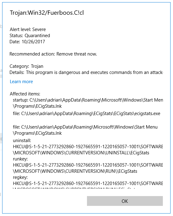

ozadr1an Posted October 26, 2017 Report Posted October 26, 2017 (edited) Judging by no one else having commented, it must be my end.. but Windows Defender just spat the dummy about ecigstats - I upgraded to the latest 2.0SP8 yesterday... : Edited October 26, 2017 by ozadr1an
Willy Posted October 26, 2017 Report Posted October 26, 2017 (edited) 1 hour ago, ozadr1an said: Judging by no one else having commented, it must be my end.. but Windows Defender just spat the dummy about ecigstats - I upgraded to the latest 2.0SP8 yesterday... : I just updated the wife's Windows 10 computer the other day and read a article in the news paper about the new version MS released, it includes among other things, updated higher security. Expect more of these false flags with Defender until they iron some of them out, some I'm sure won't rise to the level that MS will invest the time to do anything about, how many of the populace use escribe? Maybe there is a way to dismiss the warning? The wife doesn't vape, I don't have escribe on her computer and I'm using Windows 7 on my desktop, I don't care for 10. Edited October 26, 2017 by Willy
etab75 Posted October 26, 2017 Report Posted October 26, 2017 Looks like you have been infected by the YiHi virus Seriously though, one for James I think. 1
ozadr1an Posted October 26, 2017 Report Posted October 26, 2017 Lol.. yeah.. I'm not on 1709 yet still 1706 for win10. As for being infected.. hehehe.. pretty sure it is indeed a false positive because this machine gets nothing but legit apps and no external media.. I've quarantined it but was more raising awareness for James.
