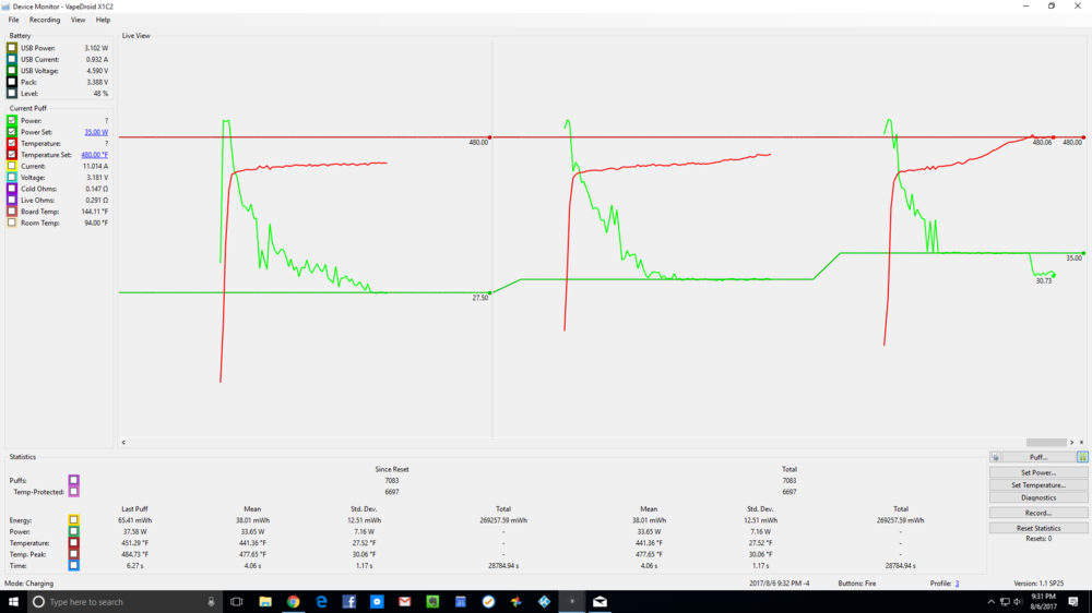

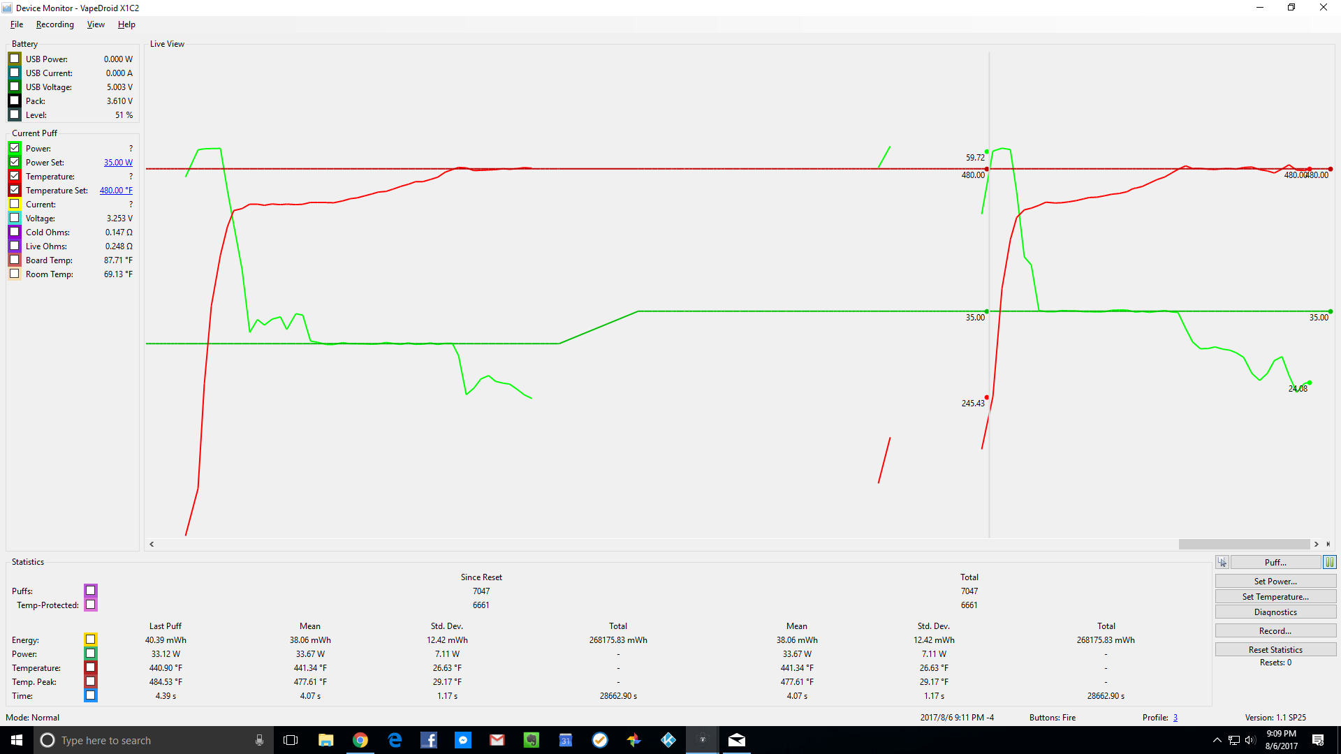

LeeWB3 Posted August 4, 2017 Report Posted August 4, 2017 (edited) James - Latest version is still not actually going to pre-heat temperature. It is proportional, so setting pre-heat at 430 hits a lower number (415) than setting at 460 (437). This is on a VapeDroid X1C2 with a Skyline with 6 wrap 0.6mm SSV coil. Settings for this trace are 27.5W / 480°F / 60W pre-heat / 460°F: Edited August 4, 2017 by LeeWB3 Adding mod, RTA and coil.
Frank65 Posted August 4, 2017 Report Posted August 4, 2017 Hi Any difference between SP5.1 and SP5.1c ..? 1
John Posted August 4, 2017 Report Posted August 4, 2017 Lee, you have to have your power setpoint at or above where the coil wants to run to be running temperature controlled. As is you are running wattage controlled with an extra (permanent) boost from the preheat. If you set your wattage to 60 or so, you'll hold temperature. 1

LeeWB3 Posted August 5, 2017 Report Posted August 5, 2017 (edited) 4 hours ago, John said: Lee, you have to have your power setpoint at or above where the coil wants to run to be running temperature controlled. As is you are running wattage controlled with an extra (permanent) boost from the preheat. If you set your wattage to 60 or so, you'll hold temperature. I fully understand how the chips worked on DNA 250, 200, 166, 133, 75 and 60s. As I stated above, however, the DNA 75c works differently. On the old boards you were limited to a punch that if set too high could easily lead to a "bump" as it cutoff pre-heat power and reduced down to run power. If sufficiently bad you could feel it come and go. Here is an example graph of the old system using a VaporShark Vapor Flask DNA 133 with Squape X dual 3mm 8 wraps 0.4 mm SSV 62.5W / 470°F / 100W pre-heat / 10 Punch (it woulda hit temp if I had kept drawing): So, Evolv did us the favor of adding a pre-heat temp to the chip rather than just a punch. To make that work correctly they added the ability for the chip to throttle at that set pre-heat temp so it didn't have the little bump as it cut from preheat wattage to run wattage. So far, so good and that was an improvement. However, after using a DNA 75c for a while I realized that this had the effect of allowing me to get rid of the single worst thing about temperature control - excessive throttling. Here is the graph of what to me is an absolutely miserable vape (Hobo X Stab with a Skyline 3mm 8 wraps 0.5 SSV 35W / 470°F / 55W pre-heat / 7 punch: .. Note that this juice tastes best at 470°F, however, when you apply enough power to get it there it starts throttling from the initial 35W down to 20.3W. At 20.3W the experienced heat and vapor production has been cut to SUBSTANTIALLY less than when at the 35W level. It starts off "in your face" and I think "Wow, this is a great vape" and then it feels like someone is taking my cookies away from me as it dies off. However, this same Skyline setup will not dry hit or get uncomfortably hot until well north of 500 °F. So, with the new system I can set it up to do THIS on a BAR V3 DNA 75c, same atty and coil, 25W / 500°F / 55W / 470°F: Notice how it is throttling the pre-heat wattage to maintain the 470°F preheat during about half of the draw. However, instead of lowering wattage below the set wattage and dying off for the last third it just allows it to get warmer than the pre-heat temp of 470° and start rising to the set temp of 500°F. It still will prevent dry hits or getting TOO hot by the hard limit (i.e. set temp) of 500°F where it will do the same as current chips and cut power. I would much rather let it get warmer then the best temp range for flavor (470°F) rather than cut power so much it actually feels cool. This is why I did not care for early generations of TC and why I've ALWAYS tried to setup my vapes to where they didn't hit set temp until at least two thirds of the way into a puff. If you like a fairly short puff you will not notice this, but as your puff time increases you will increasing find that TC can pull enough power that you're not getting any vapor or heat. This prevents that. Edited August 5, 2017 by LeeWB3 Deleted extraneous graphs.
John Posted August 5, 2017 Report Posted August 5, 2017 (I don't post here much, but I am... Intimately... Familiar with what Evolv did.) This is actually a really clever way to get around the power throttling as you describe it, while still effectively getting an automatic (and adjustable) setpoint and keeping temperature below a hard cutoff. This is much closer to how we initially envisioned TC being run (which is why there are both power and temperature limits, rather than just having a temperature setpoint.) That said, the preheat on a 75C is a proportional control, so if your power setpoint is significantly lower than what you need to maintain your vape, like you have set up here, then you're going to get some steady state error. Your original trace needs about 40W to maintain that profile. The difference between the 27W coming from the power setpoint and the 40W coming from the preheat is being added by the preheat term, and that has steady state error by design (so it doesn't drive the system to overshoot temperature and power.) So, you're doing everything right, but if you want it to hold closer to the preheat temperature you need more oomph from your main power setpoint. You don't have to crank it up so much that you get blast-and-die-off vapor production though. Hope that makes sense and helps, John
LeeWB3 Posted August 5, 2017 Report Posted August 5, 2017 42 minutes ago, John said: 43 minutes ago, John said: (I don't post here much, but I am... Intimately... Familiar with what Evolv did.) This is actually a really clever way to get around the power throttling as you describe it, while still effectively getting an automatic (and adjustable) setpoint and keeping temperature below a hard cutoff. This is much closer to how we initially envisioned TC being run (which is why there are both power and temperature limits, rather than just having a temperature setpoint.) That said, the preheat on a 75C is a proportional control, so if your power setpoint is significantly lower than what you need to maintain your vape, like you have set up here, then you're going to get some steady state error. Your original trace needs about 40W to maintain that profile. The difference between the 27W coming from the power setpoint and the 40W coming from the preheat is being added by the preheat term, and that has steady state error by design (so it doesn't drive the system to overshoot temperature and power.) So, you're doing everything right, but if you want it to hold closer to the preheat temperature you need more oomph from your main power setpoint. You don't have to crank it up so much that you get blast-and-die-off vapor production though. Hope that makes sense and helps, John Well, that'll still work. Explains why I can't get it mighty close to what I need as a hard stop cutoff, but I generally want to run at enough less it'll still work.

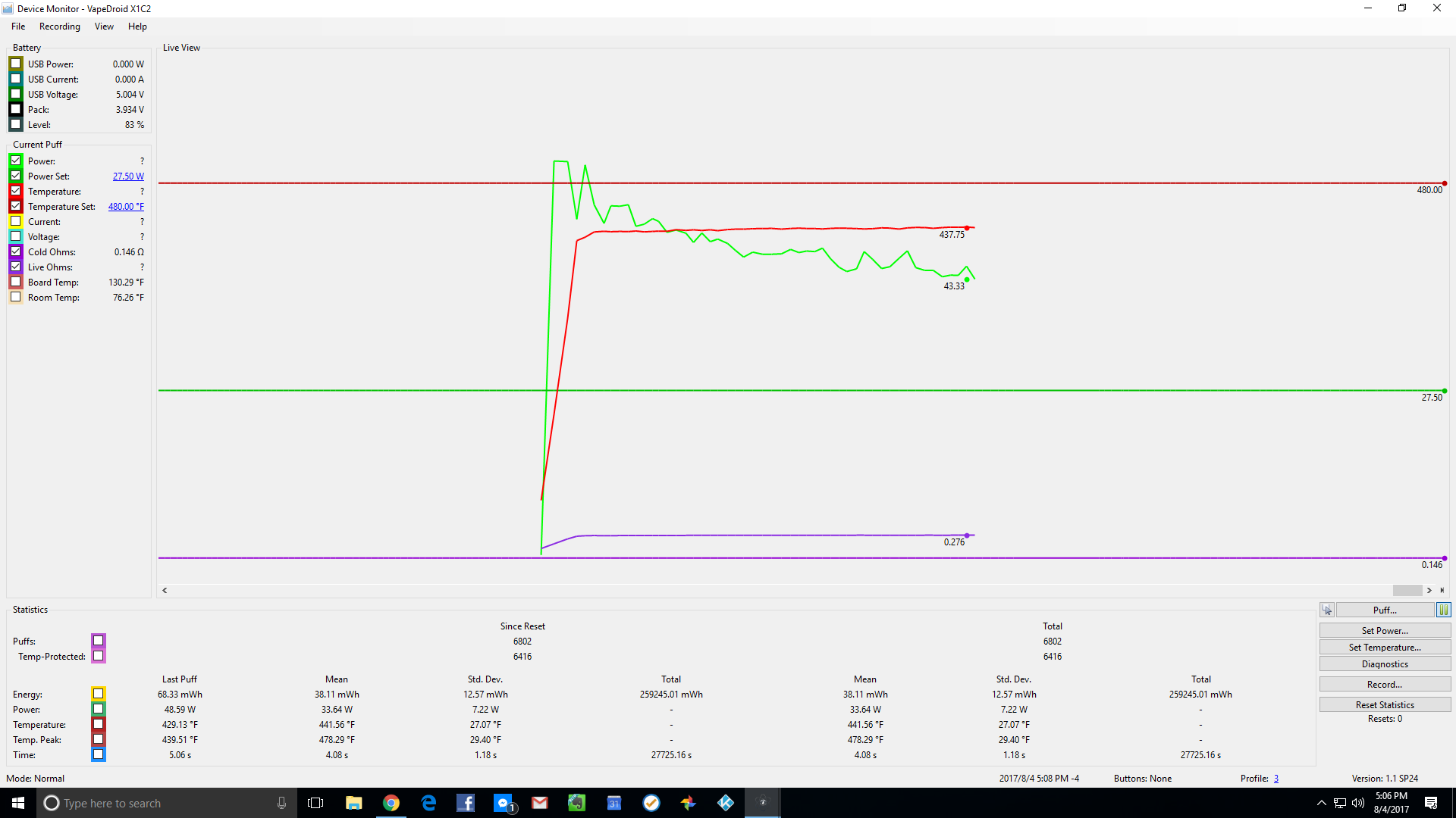

retird Posted August 5, 2017 Report Posted August 5, 2017 @LeeWB3 Been reading this thread.... interesting..... Your screenshot in the first example you gave had the power setting set to 27.5 watts and the set point for temperature of 460F was not met. It only achieved about 437.75F. What happens when you bump that power setting up to 30 watts and what happens when you bump it up again to 35 watts? The temperature should get closer to your set point of 460F or may even meet that set point and regulate from there. 2
LeeWB3 Posted August 7, 2017 Report Posted August 7, 2017 (edited) Here's 30W and 35W back to back. I hit pause in between so I could reset it to the other number and place both on one graph. You can see it's doing exactly what I say I don't like, i.e. dropping off fast at the end of the vape. I'll say, however that this is a Skyline and wicks on this RTA fail fast. It's still working OK at 27.5, but not as good as graph above. Let me rewick it and repost. Edited August 7, 2017 by LeeWB3
LeeWB3 Posted August 7, 2017 Report Posted August 7, 2017 OK, here's a better comparison (how do I delete a post?!). New wick, chain vaped (which I do) to where it's no longer saturated from initial wetting of wick and already hot (the graph you referred to came from first puff rather than after hot). Again pausing between each puff to reset wattage upward and changed scale from 15s to 35s to fit all three puffs. With a new wick like this 27.5W is still fine and it'd even be OK for me at 30W - see it easing up at end? But 35W is doing what I say I don't like. Within the first or certainly by second tank on this skyline (at least with my wicking) I'd have to drop back to the 27.5W to get what I'm getting at 30W here. It'll then maintain that through ~10 tanks before needing rewicking or lowering wattage further.
