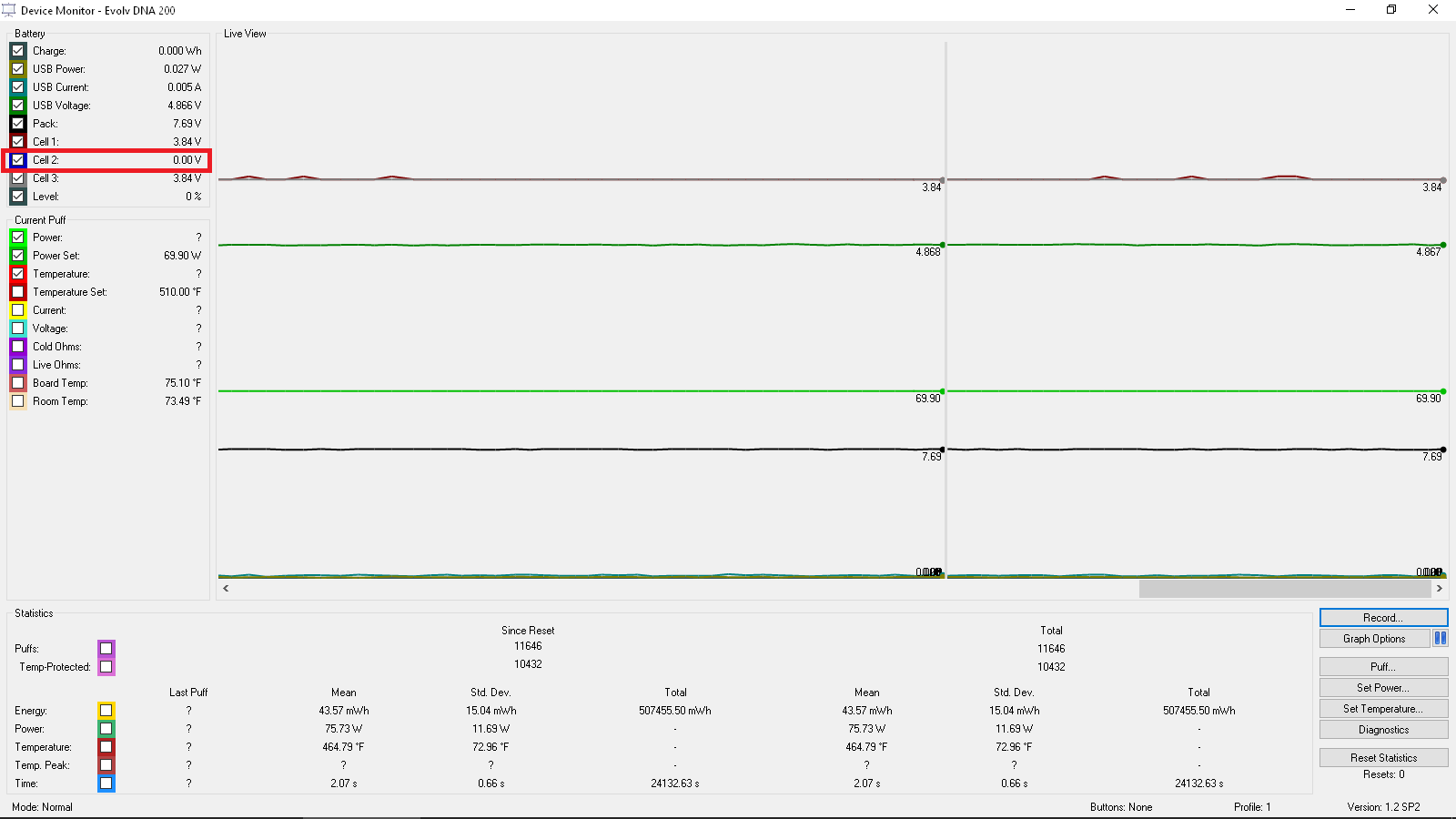

Pro_Vapes Posted August 7, 2016 Report Share Posted August 7, 2016 I updated my Hcigar Vt200 and I now have battery issues. This mod was fully charged and working before I updated it... now I get this. Is there any way to rollback a firmware update? Link to comment Share on other sites More sharing options...
dwcraig1 Posted August 7, 2016 Report Share Posted August 7, 2016 I would try a reboot first, Steve explains reverting the firmware pretty well here:http://vapingunderground.com/threads/hcigar-vt133-dual-18650-dna200.171476/page-74#post-1307253 Link to comment Share on other sites More sharing options...
Pro_Vapes Posted August 7, 2016 Report Share Posted August 7, 2016 I've tried the reboots. I also found how to rollback the firmware upgrades... none of it's working. This mod is only a few months old and the battery shouldn't be bad, but I do have a spare I can try to see if it's the battery. Link to comment Share on other sites More sharing options...

Pro_Vapes Posted August 7, 2016 Report Share Posted August 7, 2016 dwcraig1 said:Be sure to let us know your results.It was the battery. It's reading all three cells after the battery change.Thanks, If you have a meter check the old battery with it if you haven't already...or find a friend that has one and check it. Link to comment Share on other sites More sharing options...
