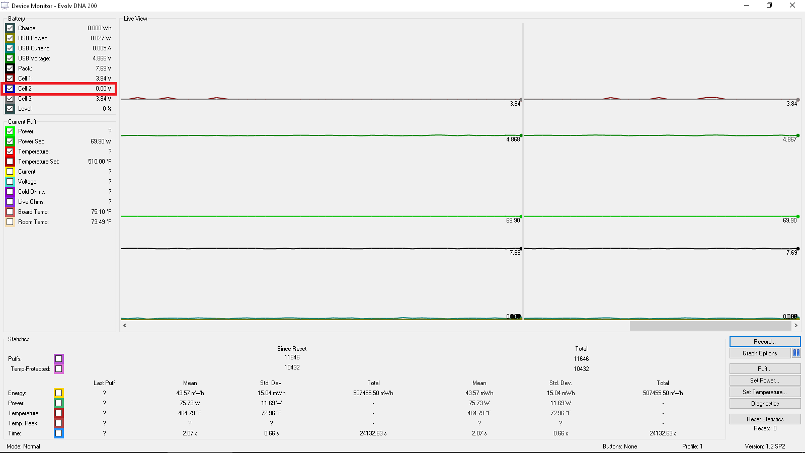

It was the battery. It's reading all three cells after the battery change. Thanks, If you have a meter check the old battery with it if you haven't already...or find a friend that has one and check it.
I've tried the reboots. I also found how to rollback the firmware upgrades... none of it's working. This mod is only a few months old and the battery shouldn't be bad, but I do have a spare I can try to see if it's the battery.
I updated my Hcigar Vt200 and I now have battery issues. This mod was fully charged and working before I updated it... now I get this. Is there any way to rollback a firmware update?
