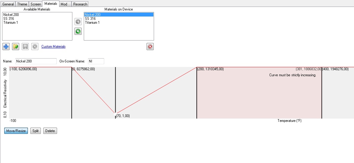

klickman Posted February 27, 2016 Report Posted February 27, 2016 Hello,I'm Manfred from Austria, this is my first post (please excuse my English, it's not my mother tongue and may sound funny sometimes ;-) ).Initial situation: 2x Wismec Reuleaux DNA200, Parallels 11 and Windows 7 on a MacBook Pro 2011, running OSX Yosemite 10.10.5.Escribe 1.0.35.2 works without problems. As soon as I install 1.0.38, 1.0.39 or 1.0.41 (regardless if fresh install or over a previous version), the curves under the "Materials"-Tab look like this: Furthermore, after connecting a divice and downloading its settings, I can upload changed settings to the mod without any problems but every time I try to "Restore Defaults" on the "General"-Tab in 1.0.38, 1.0.39 or 1.0.41, I get: I would appreciate any help!GreetingsManfred
Wayneo Posted February 27, 2016 Report Posted February 27, 2016 Manfred, the materials curve must always be increasing like the message states. If you check all your materials, they should look similar to your top jpg. Find the offending material curve and delete it.

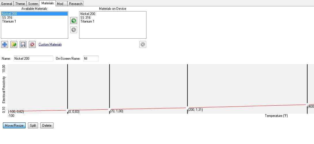

klickman Posted February 27, 2016 Report Posted February 27, 2016 Hello Wayneo and retird, thank you for your quick replies!The screenshot that shows the invalid curve was taken right after installing 1.0.38, 1.0.39 or 1.0.41, even before a mod was connected. Of course, I removed all curves (each of them in the "Materials on Device"-section was damaged) and replaced them with correct curves. I also connected a mod and downloaded the settings from it. Both worked fine and the curves looked ok. But as soon as I try to "Restore Defaults" I get the error message shown on my last screenshot and the curves appear damaged again.So there are two reasons causing these invalid curves: First the install of 1.0.38, 1.0.39 or 1.0.41, second the attempt to "Restore Defaults".

James Posted February 27, 2016 Report Posted February 27, 2016 Hello Manfred,I have been able to reproduce your bug. It will be fixed in the next version. Thank you!James

James Posted February 27, 2016 Report Posted February 27, 2016 Howdy Manfred. Try this version. It works for me: https://www.dimensionengineering.com/software/SetupES_2016-02-27.exe

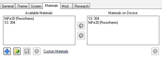

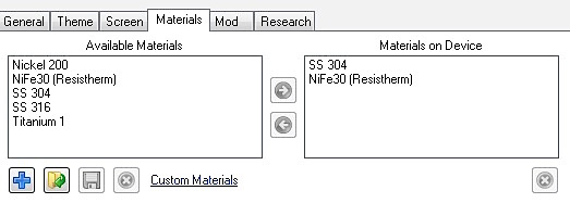

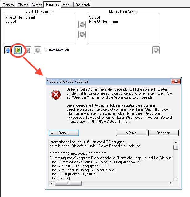

klickman Posted February 28, 2016 Report Posted February 28, 2016 James said:Howdy Manfred. Try this version. It works for me: https://www.dimensionengineering.com/software/SetupES_2016-02-27.exeHi James,thanks a lot for your efforts! I played a bit around and there are good news and twoo new bugs. ;-)1. The curves after installing Escribe are now correct.2. "Restore Defaults" works flawlessly.But:The first bug is, that each of previously deleted "Available Materials" will reappear on the next start of Escribe.After deleting: After restarting Escribe: The second bug is, that adding new materials will fail. Klicking on the "Open Material"-button causes this error: I am sorry that the message is in German but maybe you know nonetheless what this error stands for: Error.txt GreetingsManfred
James Posted February 28, 2016 Report Posted February 28, 2016 Manfred: Try the download again. I've updated it and it will fix the "Open Material" bug. As for those curves, EScribe automatically adds the built-in curves (Ni 200, SS 316, and Titanium 1) on startup.Wingsfan: It's just a bug fix (and it's a weekend ). Up to you. I'll put it on the first post when I'm more sure it's correct and complete. 2016-02-12 was the big update and these are all minor corrections, in this case affecting those for whom the decimal separator is a comma.
