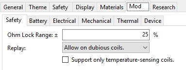

Ni80 is the problem, it is not a temp sensing material, if it is a 250C you could try change this setting to dubious as it allows some coils that don't behave as expected to work, but it is a small margin so I doubt it would help you.
