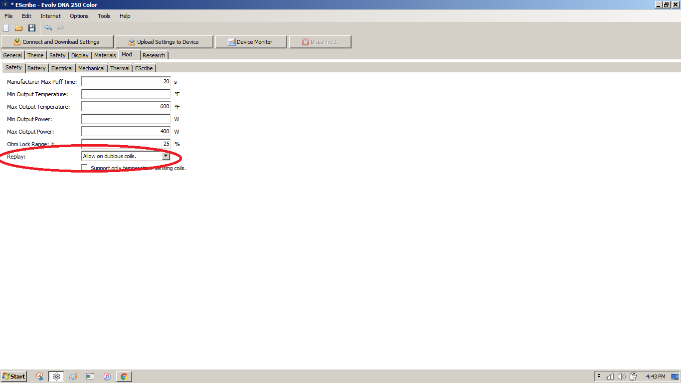

@smlemmon Replay has a "warmth" setting in EScribe and on the default Evolv theme. Although, it's labeled as "Replay" on the device. I think it's adjustable, just like "punch", from 1-11. It's under the "Atomizer" settings on the device.- 11 replies

In Escribe If that doesn't work the TCR of the coil (wire combos combined) may be to low. Or you have a mod/base resistance stability issue.

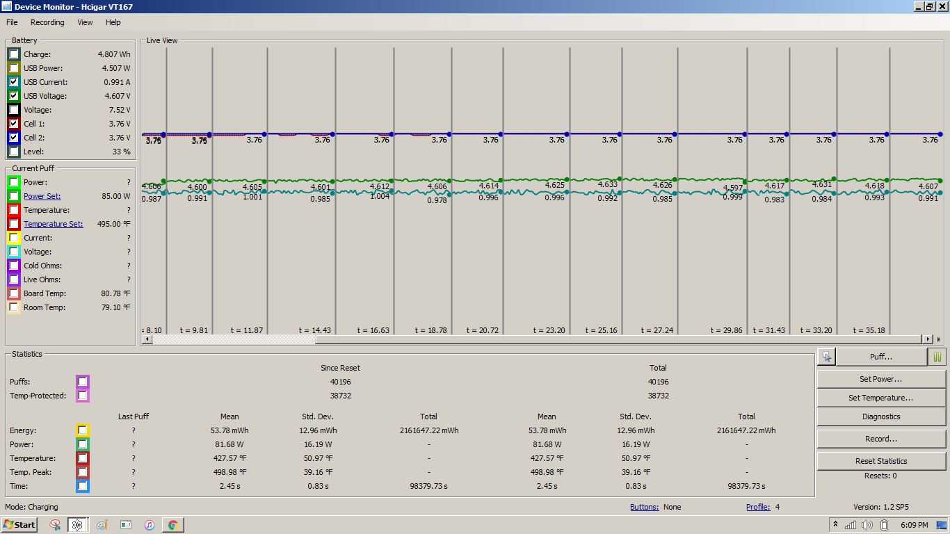

@Boopinhoopties You're board says 116f when only charging at an average of .6 amps. This value is unaffected whether case analyzer is ran or not. case analyzer only corrects the room temp readout. My guess is it's board related. Could be a variety of possible causes. Juice on the board somewhere / missing or failing thermistor (or some other board component). have you tried re-flashing the FW? just for the heck of it, couldn't hurt at this point. I'm not sure of Lost vape's warranty service but the board inside the mod is covered for 1 year by Evolv. I would open a help ticket with them explaining the problem.
@Boopinhoopties can you post a screenshot of DM with cells 1/2, USB voltage, USB current boxes ticked? It's a great tool for diagnosing problems. The USB voltage should not dip between 5v~4.27V during the constant current phase of charging. Slight peaks and valleys (a few hundred millivolts) are ok. The 250/167 should charge at 1 amp when connect to a PC. Current limiting will happen if : the USB voltage starts to sag around 4.27v / either of the two cells are close to 4.20v / the board temp is reading abnormally high or low temps / USB socket, on board, is wearing out (same for USB cable, itself). what version FW are you running? below is normal charging for a DNA 167 2 cell
