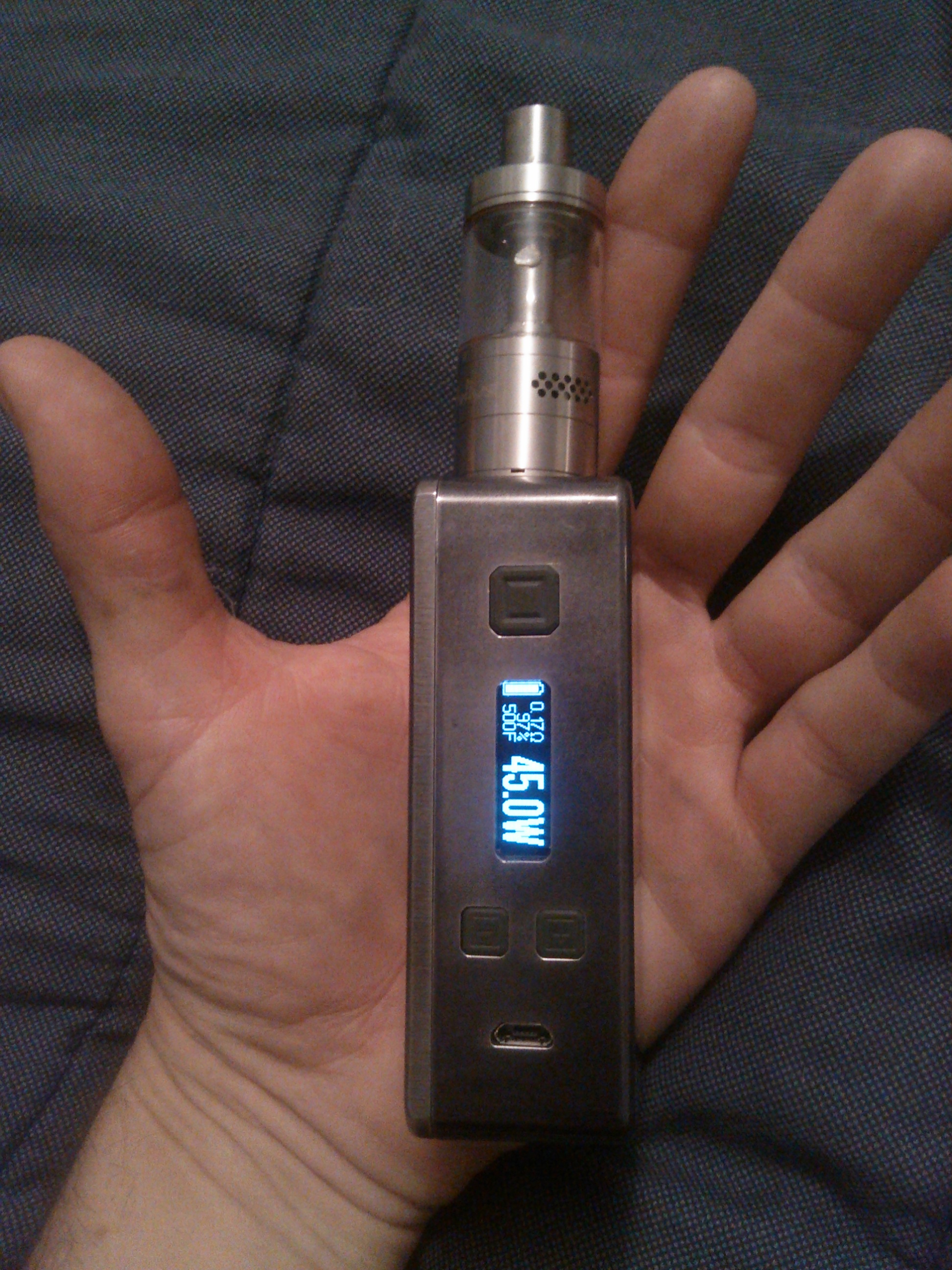

The 1590A fits awesome in my hand and the fullymax 900 in mine is good little lipo. i get exactly what's printed on the wrap. hey question, to anyone, what box can fit at least a 2000mah and doesnt have the "hammond lean"? thanks.
