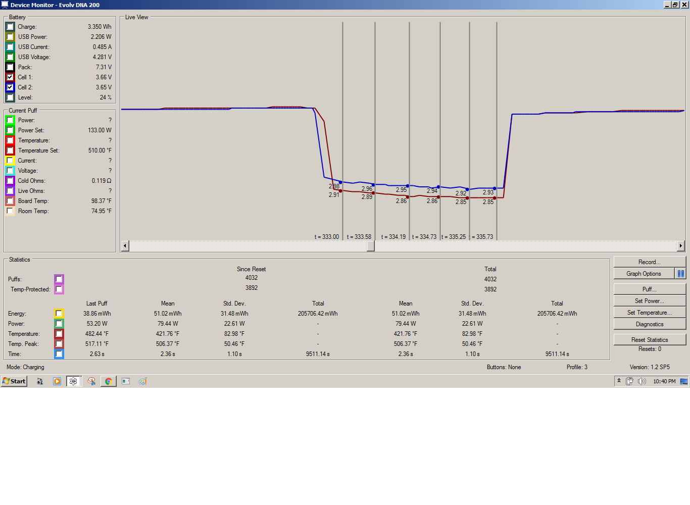

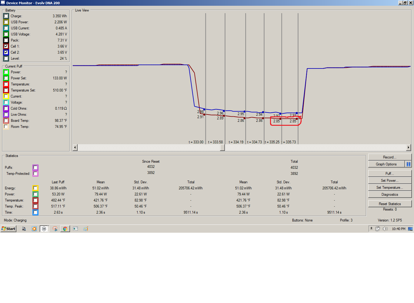

you double checked the voltages at the balance taps on the board and the main -/+ at the board? (with fully charged cells - 4.20v) you should get 8.4v at the main -/+ 4.2v between GND and cell 1 at the tap and 8.4v between GND and 2+3 at the tap.
post a screenshot WITH batteries installed. there will always be nonsense voltage readings on any of the cells with no batteries and just the usb powering the board. all of the DNA 200/250 boards do this. this normal behavior. what isn't normal is wrong cell readings when fully charged/balanced cells are installed.
if you know for a fact the board is receiving the necessary voltage through the balance tap wires and main -/+ and you're in 2 cell mode, i would open a help ticket with evolv and ask for a replacement. the board has a 1 year warranty. can you post one more screenshot of device monitor with batteries installed? with the new firmware (SP5a).
make sure your sled contacts are making connection to the ends of the cells. use a DMM. did you press "upload to device" after you selected "2 cell"? your mod is still running in 3 cell operation. the third cell field will disappear when in 2 cell mode (on SP5 and up firmware). you should upgrade to to the newest firmware as well SP5a link is in my signature.
just look at the puff count in device monitor. was it at 0 when you received it? that means new board (most likely the case. easier to replace the whole board than troubleshoot.) device monitor will always keep track of puffs regardless of resets.
you could have ejuice around the USB portion of the board causing a slight short to ground. I would inspect the board carefully for ejuice.
an over estimated WH input would not cause your cells to become imbalanced. The dna boards have vast amount of battery safety And hard limits that can not be overrode. What would most likely cause your cells to become imbalanced is a defective or old lipo.
