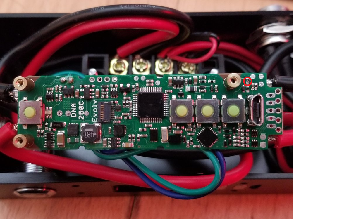

help Did I bungle it? I probably bungled it (voltage issue)
Spector NS5 RD replied to CriticoolHit's topic in Modders' Forum
Hard to tell from the pics but everything "seems" to be OK. No components tombstoned or knocked off. I do see one resistor, (maybe a pulldown?) circled in red, that either has a hole in it or it's just the conformal coating messing with the picture. No idea if it has anything to do with voltage monitoring. Try cleaning off the flux residue left over from your soldering with some iso alc. More than likely, you'll just end up RMA'ing the board in the end. Evolv's warranty/customer service is the best around PERIOD. Good luck! -
For the board to consistently read the same difference between all three PSU voltage inputs, i would venture a guess as to a hardware issue. Possibly a knocked off res or cap or damaged. Nick answers the help tickets, he'll get it sorted out. I know, it's a bummer. At least your design is modular, though. One last thing. If you open EScribe, Click "Help" at the top of EScribe........"About EScribe" then click the word "EVOLV" 7 times then open up Device Monitor. You should now have a Debug menu. What does the "Bandgap" read? EDIT.........Never mind, I guess James took out bandgap from debug . 🤔 huh, weird. In the older 200/250 monochrome boards bandgap readout is a voltage reference. -
I joke around, if something i type sounds snarky, just laugh it off. Ya, you seem you have the correct settings in EScribe now. What happens if you toggle a different input voltage? does that change the pack reading? Just trying to figure out if this is a board problem. Can you get you DMM probes on the actual input pads on the 250board? Make absolute suer your getting the full 12v. Also make sure you're getting the full 12v UNDER LOAD. If all else fails, take the board out and look around for missing components .......knocked off resistors, caps, IC's etc. Then just RMA the board back to Evolv for replacement. You running the latest FW? -
"Bro, whats with the terminal bus?" "total overkill brah." 😁 One question and forgive me if i missed reading it in your 3 page description, do you have the board set to "power supply" ? Then you select the input voltage 9-12-15 volts. This drop down menu is in EScribe under the Mod section - Battery tab. EDIT......yep i missed it. OK you do have it set to PS and 12v did you upload the settings? what happens if you select 9 or 15 volts, then upload? the pack voltage change? -
