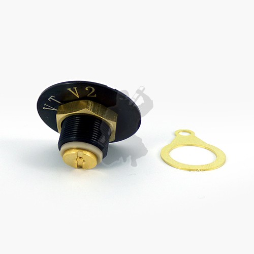

You sure you have the Varitube V2? I have a mods built with a V1 and V2. The V1 limits you to a max awg of 14 BUT the V2 really has no wire size limitations do to the re-construction of the positive portion you solder to. My guess is you actually have the V1. See on the V2 you have the entire positive platform to solder to. No brass fitting to slide the wire through. Makes use with bigger wires easier. As for the GND ring, you don't need to thread the wire through the wire hole, just solder the wire flat against the ring. You could even solder the wire directly to the brass nut.
