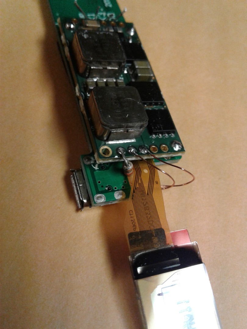

DNA60 Evolv USB charger
Spector NS5 RD replied to Rain's topic in Connectors, Components, and Accessories
if i had to guess, i would say the hardest part of your build is going to be the soldering of tiny enamel coated wires to the USB data -/+ pinouts of the micro USB socket. hard but def doable. if you have any problems, just post em or shoot me a PM. Good Luck! -
i did, i routed around my old circuit board collection and found one. they're a fairly common value resistor. the 10k res gets connected from #15 on the DNA 60 to the incoming 5v USB. so anywhere you can find 5v USB on either of your sandwhiched daughter boards. -
one board has the RBP buzzer and one of the two charging IC's. the other board, on top of that board, has the second charging IC and the battery leads soldered to it. you would need to de-solder these two boards from each other and take a look at the USB pin out. you're going to have to do what i did when i decided to keep my VS DNA 40 daughter board. here's a photo of what i had to do to the USB (your USB socket will look similar to mine, our daughter boards are different but that is irrelevant). i will also personally help you through this if you decide to go this route. -
