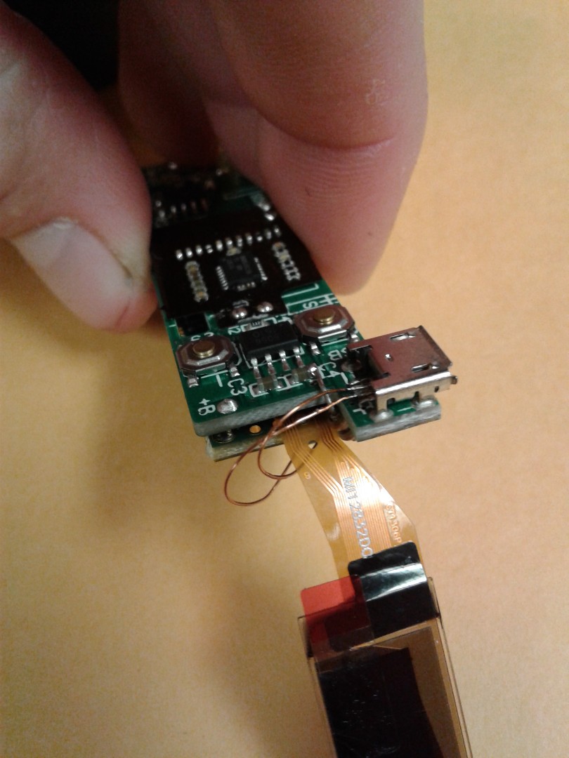

here's another pic of the install. you can sort of see where i connected the 10k res to on the daughter board. it may help some...... FYI, you need to install the screen ribbon to the DNA 60 before soldering mating the two boards. i also removed the DNA's up and down buttons (not the entire button, just unclipped the actuators).

@joelhammonds - yes, the positive side of capacitor. those pin holes are vias don't concern yourself about those. another option is this pin of the charging IC, it's all on the same circuit, whatever is easier. TBH and don't get offended, if you're not that familiar with circuits or soldering this can end up being a very difficult modification and a big headache. i didn't mention this but i also had to grind away an aluminum post for the DNA 60 to fit.
yes it is. it is the far right pin. you can do that but i found it easier to bend the leg of the 10k resistor over to the input capacitor of one the daughter board's charging chips. i circled the place i connected the 10k res to in red (be sure to solder the resistor leg on the + side of the ceramic capacitor, the positive side has "C4" in white). it is USB (VBUS) +5v.
